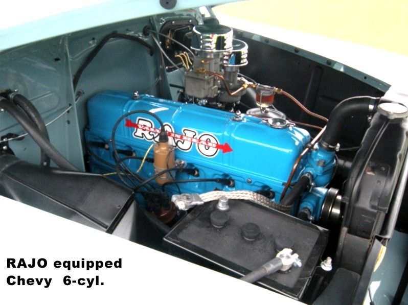

Not Corvette, that sounds like a "RAJO" head (or a head converted to that design), only made in 15 bolt, very rare.
[img]https://lh3.googleusercontent.com/t...lRXu_HUoiMVbQDN_-M5sLSzD8cea6jX6UTN=s170[/img]

The actual head has "RAJO" cast in, so does the manifold. A converted original casting will look somewhat different, even have near-vertical extra ports.

Can't find any more text WRT increased compression or combustion chamber shape.
According to an original ad, the extra 1 bbl. carburetor's linkage is progressive and can be adjusted to operate only at higher speeds.

It's a Rajo or a clone.it says Arco on it.but it definitely isn't a stock,235 head.

A.R.C. is Rajo

IIRC that head already has the Powerglide 1-15/16" valves.
