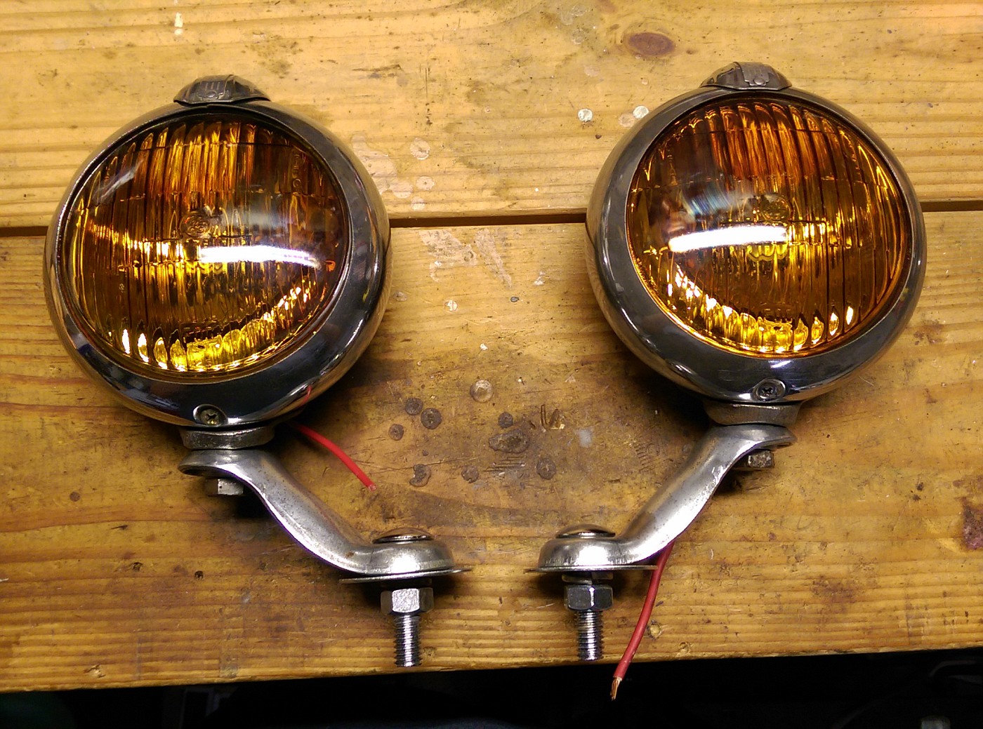

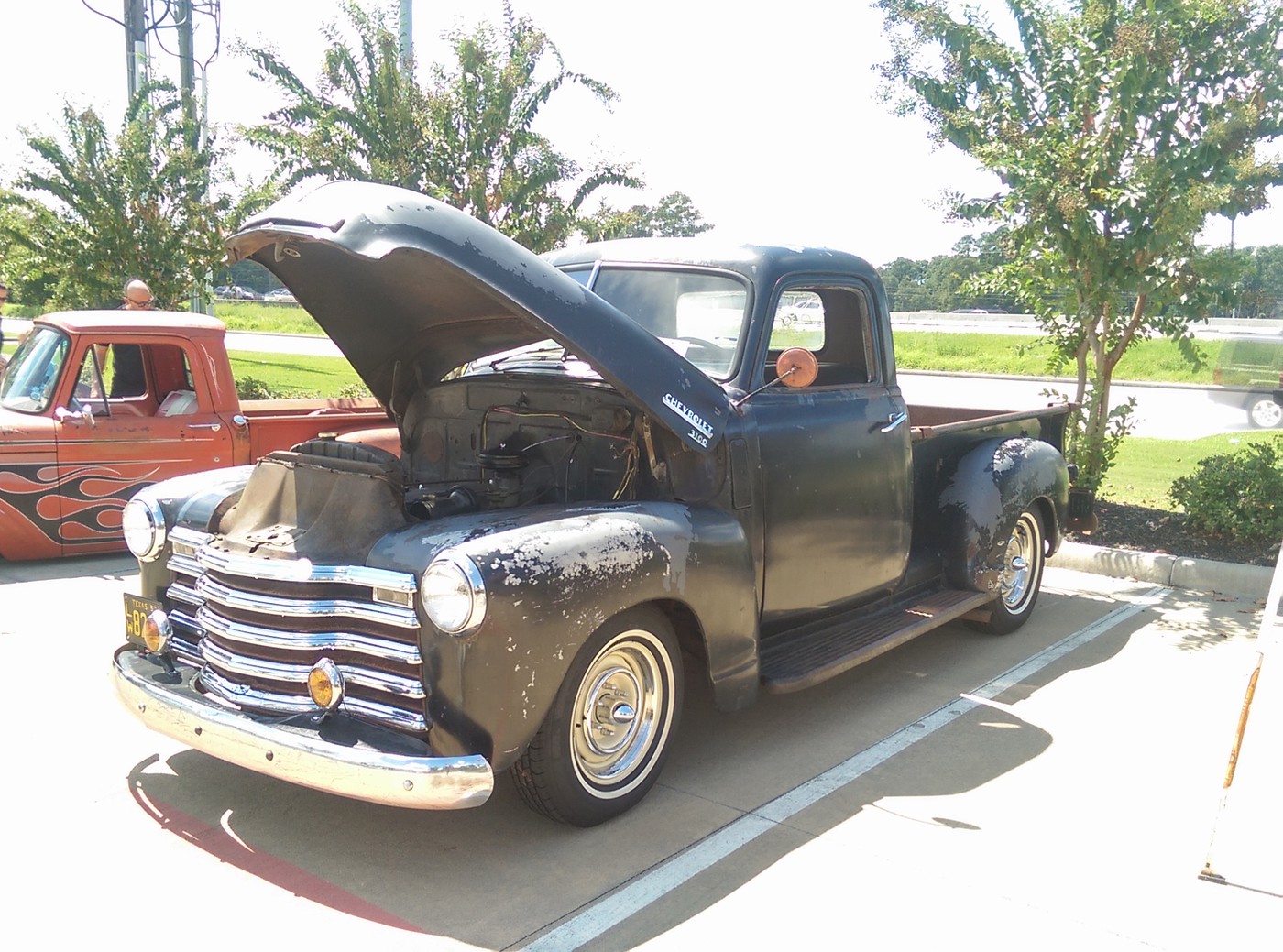

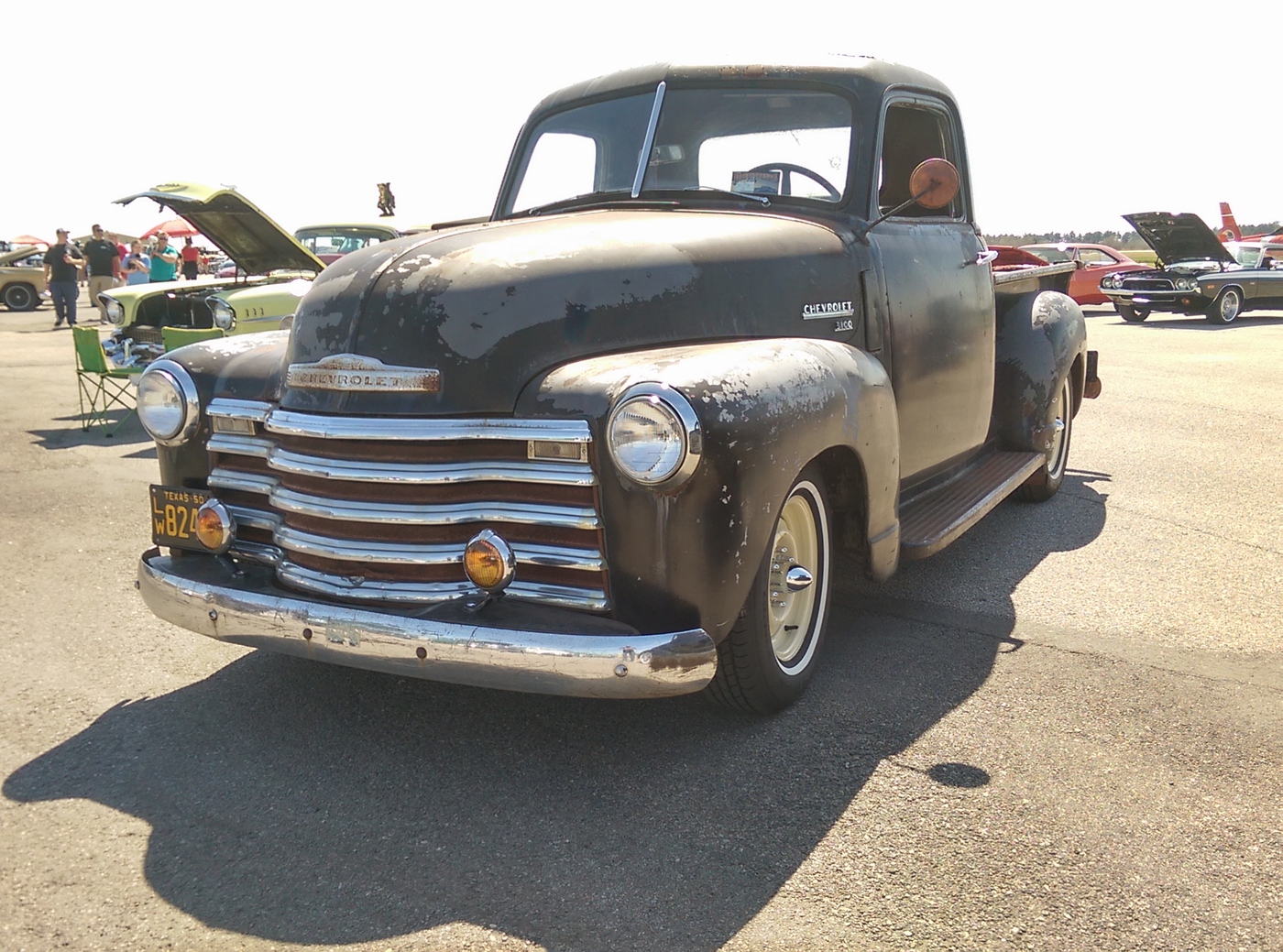

Unity Lights on their brackets
Front end
Front end 2
I found these Unity fogs for sale on the HAMB for cheap. The brackets came with them. I bought some chrome bolts, along with some washers (visible in the first pic) and nuts. I drilled an appropriate sized hole in the front splash pan. I used a small circle of gasket paper to prevent metal to metal rubbing between the bracket and the splash pan, and put the washer, lock washer, and nut below. They are really stable. I ended up having to paint the brackets and the cast bases of the lights because they weren't holding up to being in the weather. I used a lighted Unity under-dash switch I found on eBay, with a parts store horn relay for power. Bulbs are amber 12v GE bulbs I found on Amazon.

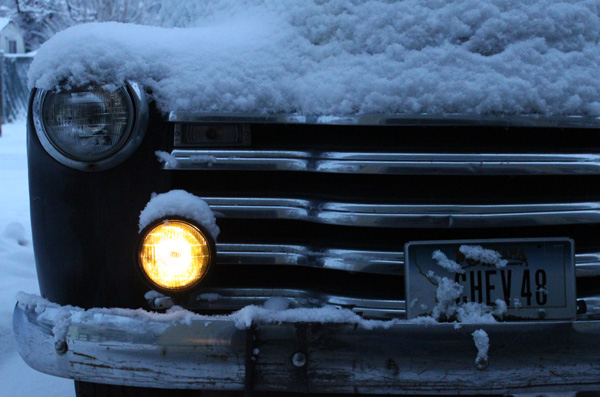

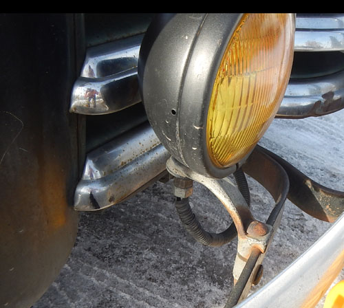

I'm not sure if mine is original equipment (I doubt it). The bracket grabs the bumper support and was there when I bought my '48. I got the light case (with burned out 6-volt light) at a swap meet. It connects to the bracket via a ball and socket joint. When I went to 12 volts, I found a NAPA #4412A fits perfectly.
