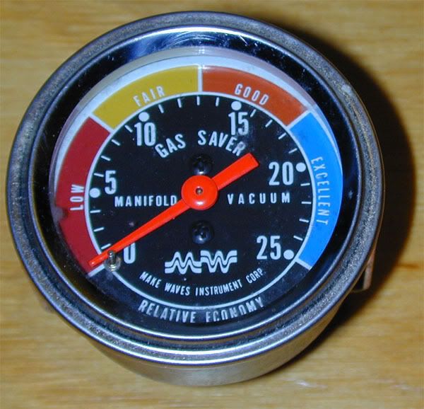

"How to drive with a vacuum gauge???"
When I was much younger, a "gas saver gauge" was commonly sold.

I'm playing with you a little here. Was overdrive common when the "gas saver" gauge was popular? I just can't imagine that having a vacuum gauge would make me change my speed on the freeway, nor on a country road. If I was driving on a deserted highway and could choose my speed for optimum MPG, then I'd find it useful.
