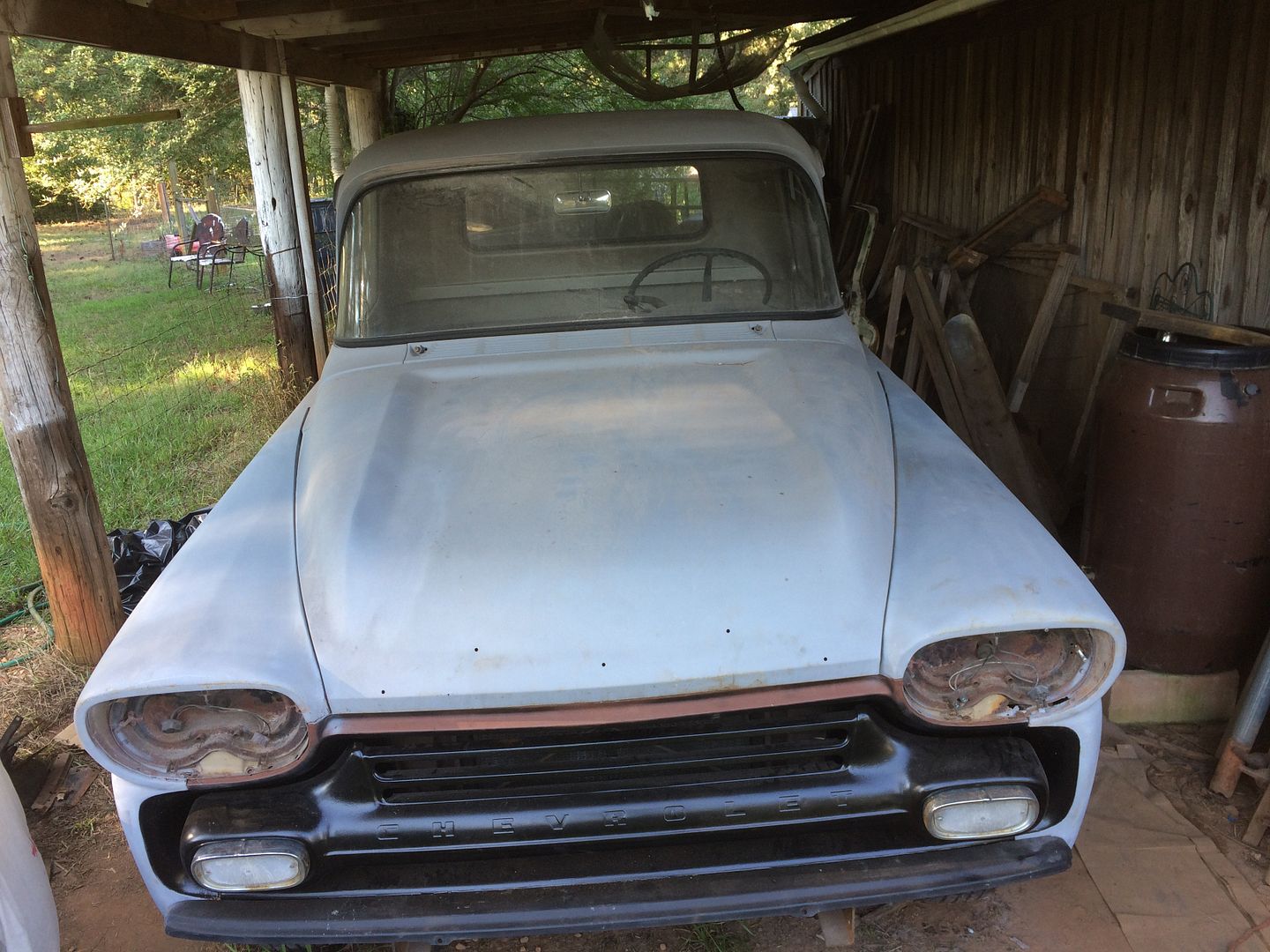

Trannys in !!!! Txs to all you gentlemen with your ideas...this old girl is almost ready for paint. mazie
