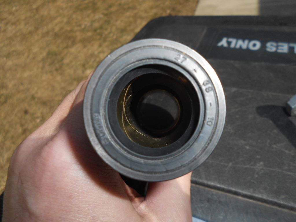

Stovebolter Jorb did a great job documenting his Okie busing install and you can clearly see the internal lubrication grooves here. In contrast the ID of a factory type bushing looks like this. This is why I hunted down NOS bushings even though I'm surrounded by machine tools every day and would venture to guess you could put twice as many miles on the factory style bushings over an Okie replacement. They're out there if you look for them...an old transmission shop near me had NOS bushings in his parts stash.

I don't imagine those bushings are lying around Sweden in any great numbers. There are a lot of torque tubes still in use, how long can it be before someone new resumes production of the Okies?
The pictures are great, I would surely study them in depth if I had a fresh bushing in my hand!
