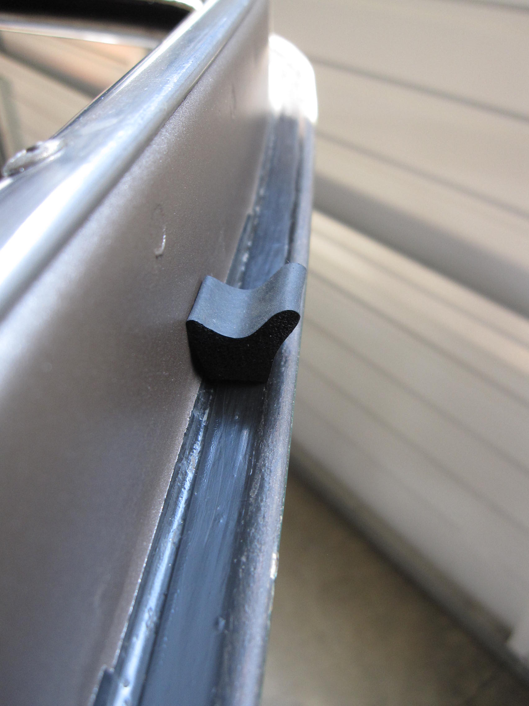

| | | | | Joined: Jan 2010 Posts: 4,263 Shop Shark | | Shop Shark Joined: Jan 2010 Posts: 4,263 | | | | | | Joined: Jan 2002 Posts: 2,845 'Bolter | | 'Bolter Joined: Jan 2002 Posts: 2,845 | weather stripping orientation Here's a pic of how I have it at the top of the door. It would just wrap around the corner. Based upon the amount of rubber I have sticking up that is not glued down on the outside as well as it's angle, I should re-check my door gap at the pillar. If I bring it back just a tad maybe the rubber will have more room to move past the corner of the pillar. DADS50, thanks for the link.

| | | | | Joined: Jan 2010 Posts: 4,263 Shop Shark | | Shop Shark Joined: Jan 2010 Posts: 4,263 | I have the same rubbing issue you describe
Although I believe my weather strip is installed incorrectly
I cannot see the rubber when the door is closed but do see it rubbing the pillar and a swipe mark. | | | | | Joined: Sep 2015 Posts: 79 Shop Shark | | Shop Shark Joined: Sep 2015 Posts: 79 | I have the same issue as well, and the rubber is installed correctly. My plan is to use a small syringe to glue the rubbed portion back in place, then keep the doors shut until the glue cures.

| | | | | Joined: Jan 2002 Posts: 2,845 'Bolter | | 'Bolter Joined: Jan 2002 Posts: 2,845 | I've removed the door so I can reglue down the area which was pulled up due to being pinched. Thinking of maybe cutting off 1/8" of the edge of the stripping in the area that consistently keeps grabbing the pillar.
