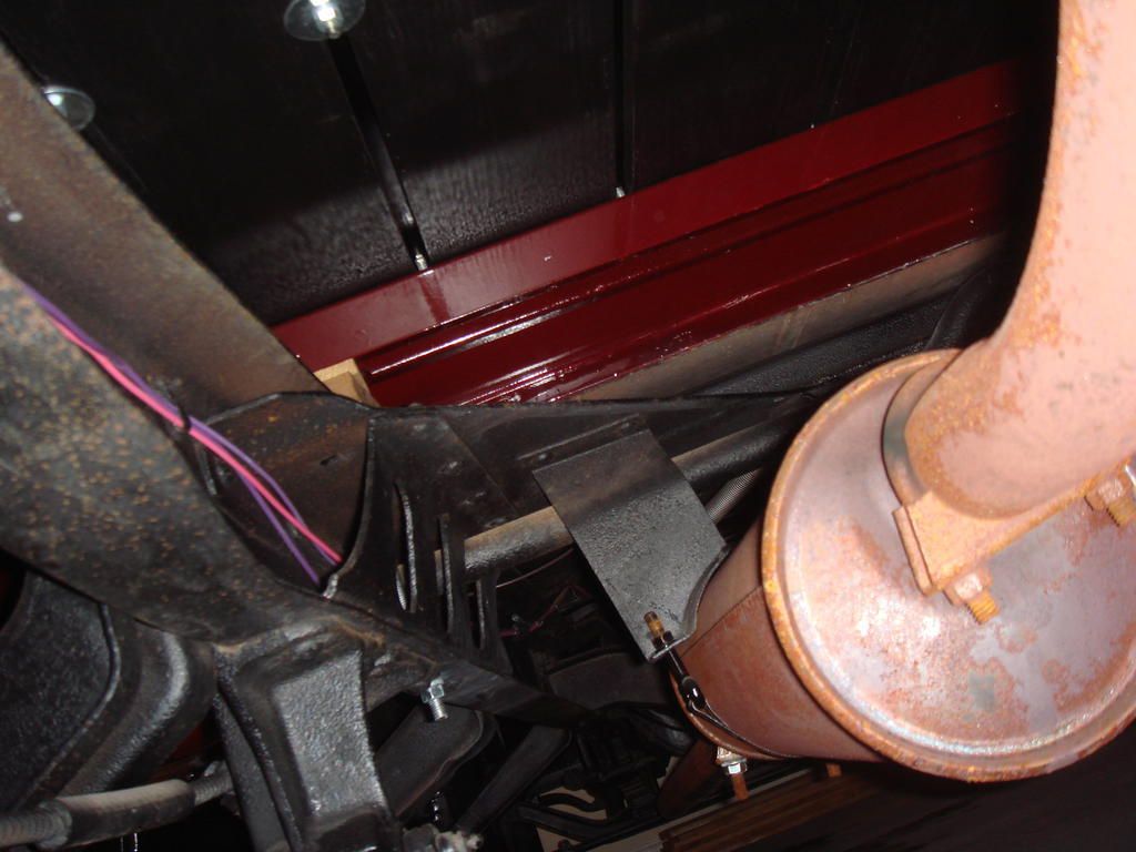

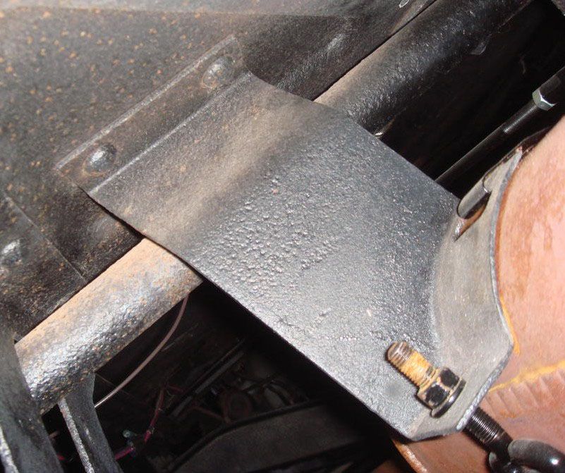

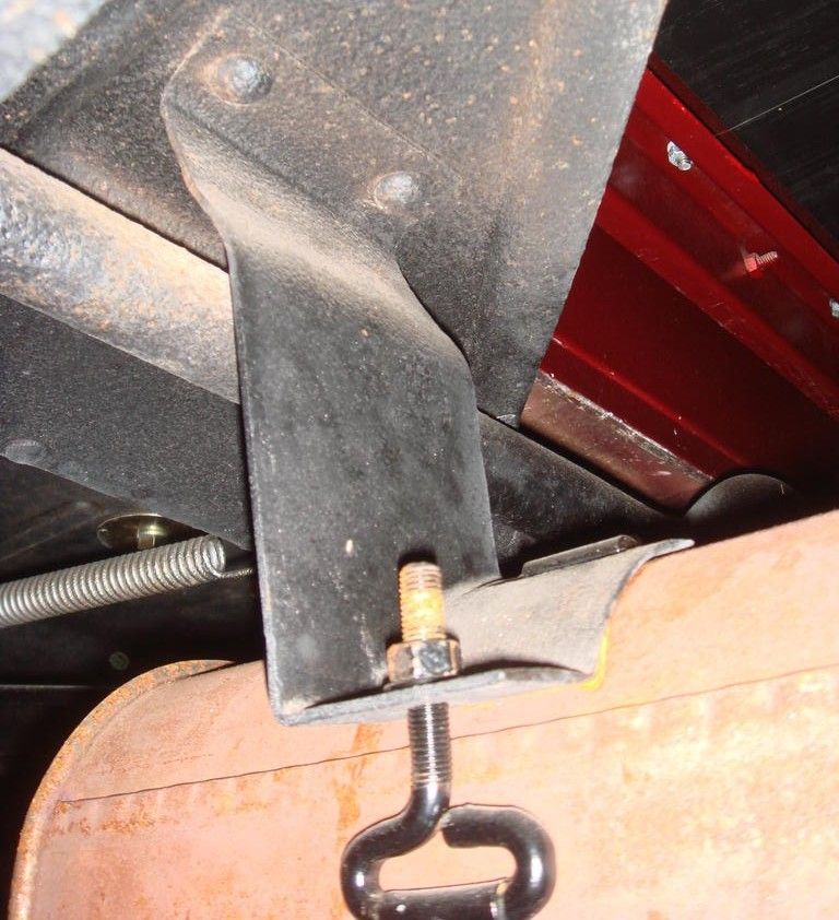

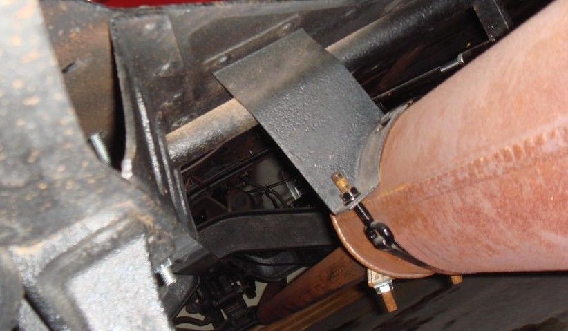

Mike, I know I've seen pictures post here before so hang tight someone will show up.
On my 52 panel the bracket attaches overhead. One end of the strap fastens on one side of the bracket and then you wrap it under and around the muffler and fasten it in the other side of the bracket and tighten it with the T handle.....but your 1 ton may be different from my 1/2 panel??
The pro's will be along shortly..... probably Next Year!!

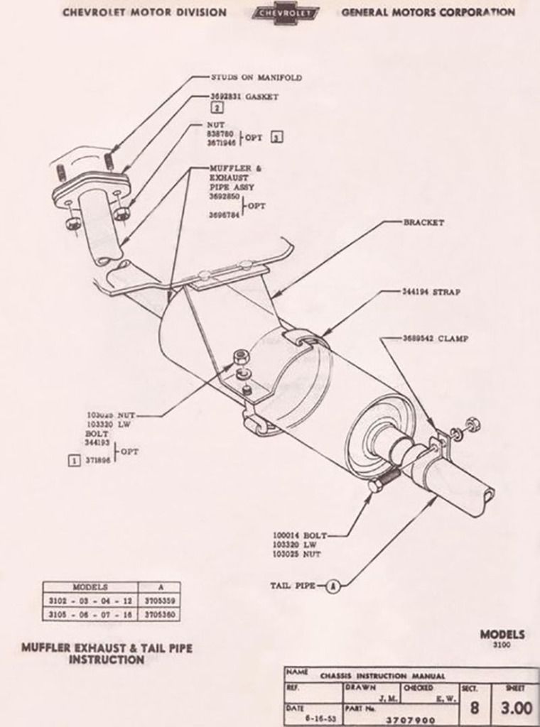

MikeC,
Here is the area of the diagram posted by '54 3600 that shows the "strap". Each end of the strap is bent to fit the diameter of the muffler. One end of the strap go through a slot in the hanger/bracket and the other end of the strap goes through eye/opening in the threaded bolt that tightens the strap against the muffler.
It is hard to explain, but the diagram should be a big help (thanks, '54 3600).

It was the same setup on the small & large trucks.

Thanks guys...I found 2 rivets and a broken bracket on the side rail of the frame rail on the drivers side....from these photos I am seeing looks like all these mount to the cross-member and not the side of the frame rail?? My truck is a 1 ton ...
Just wondering out loud...
I am way closer than I was last night to understanding these parts and how they all fit together...
Awesome awesome awesome help on here...
