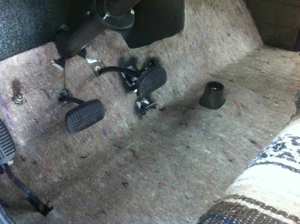

I used some stick on mat , with the jute pad and abs firewall pad
...pic...
Don't have any issues with engine heat

I used the jute on the floor too, under the rubber mat
...pic...
The soft firewall pad may help and might be easier to installing an assembled truck.
Under dash work is no fun.
