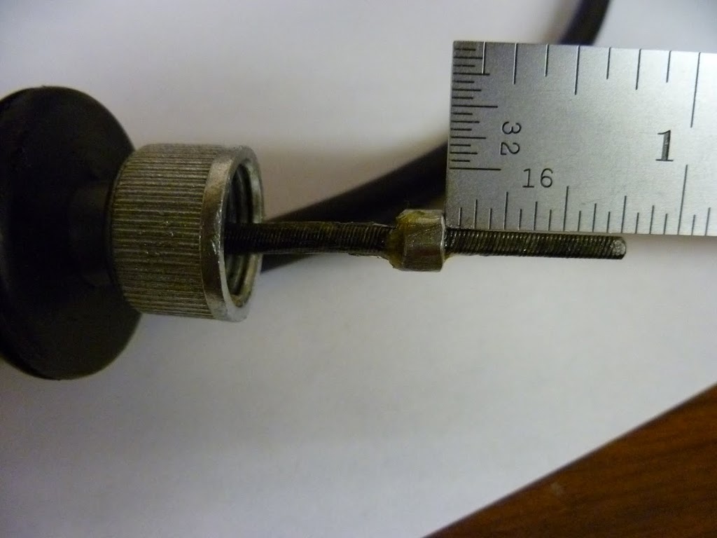

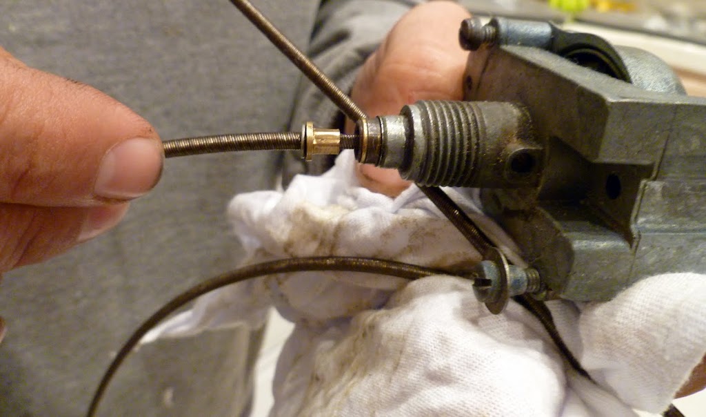

One of the cables I purchased had the collar set to far back
...pic...
...pic...
Went to the auto parts and found one set correctly
...pic... 3/4 inch as mentioned above.
root #1111015 06/30/2015 6:52 PM
Joined: Apr 2008
Posts: 899
Joined: Apr 2008
Posts: 899
DADS50...he's got all those pictures!! Looks just like my cables!
Ed
