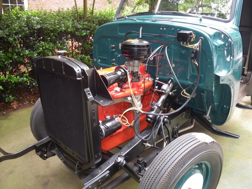

I used a cloth with harness from YNZ on my 52 GMC. I believe your 50 Chevy would use the same one. The harness doesn't care if it is 6 or 12 volts. The generator, voltage regulator and coil on mine are all 12 volts and the coil has an internal resistor. All the metal tags markings are are stamped so it would take a pretty good eye to see that the system is not 6 volts. The harness was expensive, but was easy to install. If you scroll back through the album you will see pictures of the generator, starter, coil and distributor. Here is a picture of my installation. wiring harness

Wow -- That's a beautiful job, Mike -- Can't wait to see it finished. Do we have that truck in the Gallery?

That is the look and plan I want to use Huck. That is a well done restoration! Do you know the part number for the coil? I want it to look stock but be safe and reliable. Thanks for ever ones time, it really makes a difference when making a big decision. Dustin

As best I can recall it was a standard 12 volt resistor coil I think I got from JC and painted it black. John the truck has been finished for a a little over a year now but only has about 400 miles on it. It's just too nice to use the way it was meant to be used. You can see the restoration process and finished truck at 52GMC or on the Photobucket link. It is currently listed under trucks for sale on your website.
