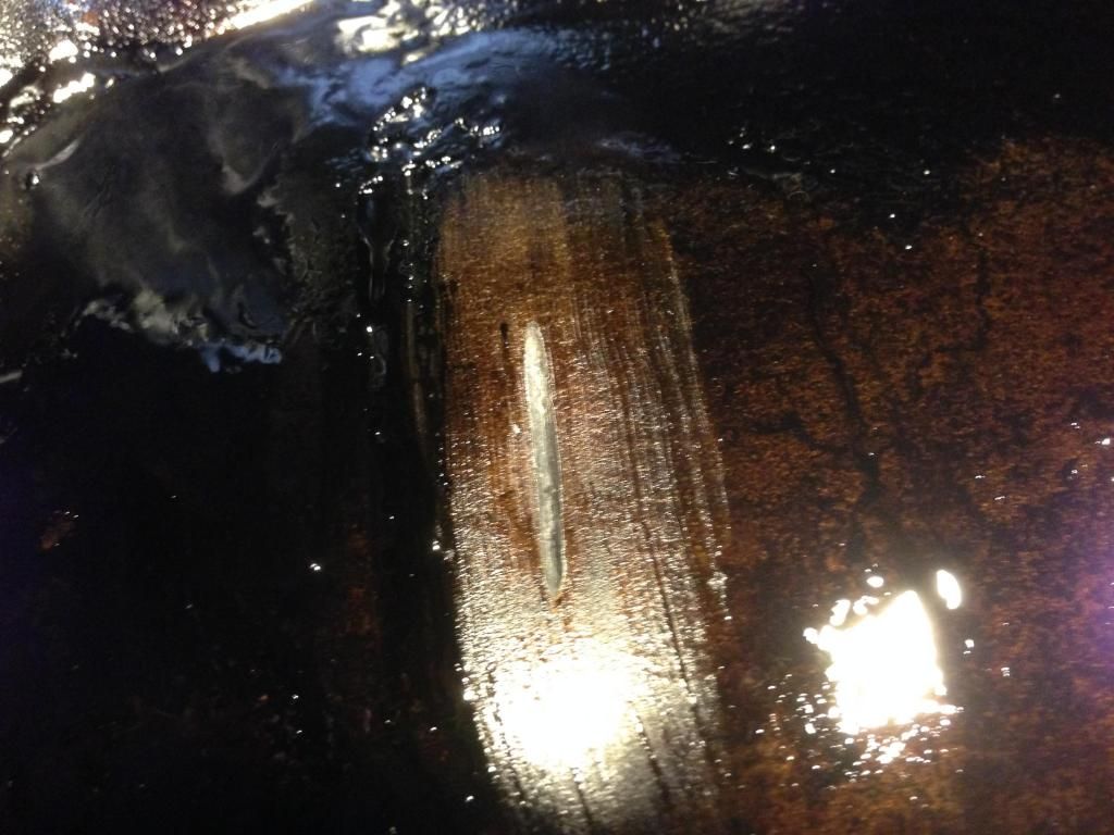

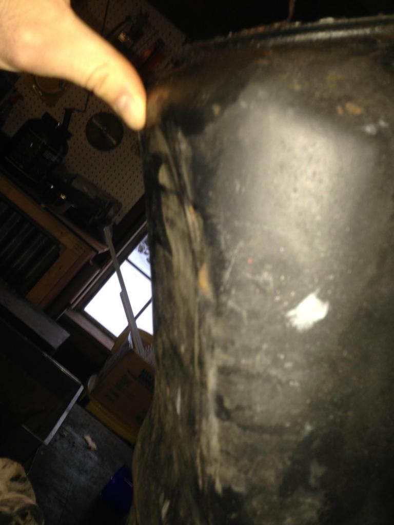

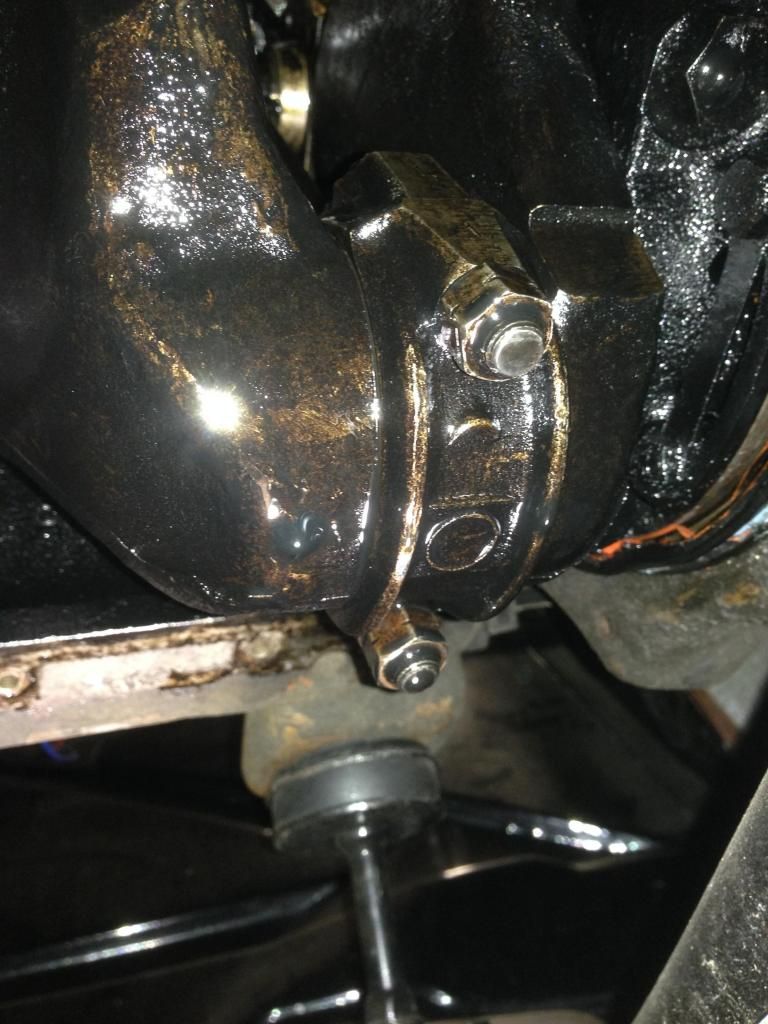

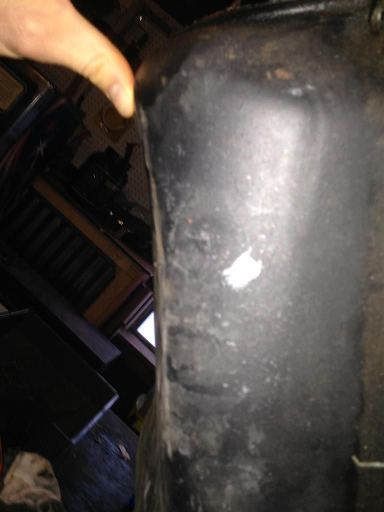

Well, I think I found the problem! I dropped the oil pan tonight. No obvious signs of metal shavings or mechanical damage. The oil pan is full of sludge and very hard to see through. I shined a super bright flash light at the inside of the pan and saw a bright spot shining back. Long story short, the bottom of the oil pan was pressed in enough that it was rubbing on the crank shaft. Also there was no cork gasket just silicon so the pan was sitting a bit higher which didn't help. Here's the pics:
http://i824.photobucket.com/albums/zz166/keenebolter/58%20Apache/image2_zpsb909bfd6.jpg
http://i824.photobucket.com/albums/zz166/keenebolter/58%20Apache/image1_zps70702e2e.jpg
So now that the pan is out I see that its full of sludge which I will obviously clean out but what else should I do while the pan is down? Is there an easy way to clean the black gunk off the inside of the engine? Should I take apart the oil pump and clean out the metal lines? I'd like to get as much sludge out of this thing as possible and clean it up a bit.
Thanks everyone for the help and suggestions. That broomstick idea led me to the problem!

Good find. That pan must be dented/pressed in pretty good. Can you post a pic of it? I'm curious to see how dented it is.
A new gasket won't push it down enough to clear those rod bolts based on how deep that scratch is.
While you've got the pan off, drop and cleanout the screen in the oil pickup tube.
If you really feel motivated you could plasti-gauge the main and rod bearings to get a good idea on how wore they are.
If not try and move the rods side to side, there should be very little side play.
Give everything a good look over and cleanout all the gunk/sludge you can get to.

Good detective work! I see you're dealing with a late model 235 without the dippers on the bottom of the rods, so the pan should be pretty open. Earlier engines had a trough under each rod for the dipper to dunk into. Scrape out as much crud as you can from the oil pan then grab a stiff-bristled parts washing brush and some solvent like kerosene, mineral spirits, or one of the water-soluble cleaners, and give toe pan a good scrubbing, inside and out. Follow up with a pressure washer or take a trip to the local coin car wash for a pressure blast with the tire cleaner/engine degreaser. Some car wash managers frown on this so I usually do my engine block and cylinder head cleanup LATE at night!

Here are a couple pics of the bend in the oil pan for those who were interested. It's not much really.

Since you have the pan off,I'd "Plastigauge" all the rod bearings/caps. It doesn't take long,and insures miles of trouble-free operation,no guesswork.

Hi Keenebolter, I'm glad to hear that you have and easy fix. That was a good point someone made about checking the end play of each con rod. Something I learned years ago that to install a dial guage on the vibration damper, this way you would check crank end play with each piston installation. A bent rod can be suspect if there is no crank end play. You can use something like a big screw driver or pry bar to move the crank back and forth. If you don't remove any con rod or main caps at least check the torque for each. You can also see the condition of the cylinder walls to see if you have any cross hatch left from the last honing. This may sound like a lot of work but for myself being at your stage with the pan off I would consider removing the head along with pistons to hone the cylinder walls. You would be able to see if you have a ridge which could be removed before honing. I know this sounds extreme but I've seen cases where a couple of years down the road the guy is pushing blue. With the pan off you have access to the con rod bolts that allow you to have more fun and know your engine's condition. Just food for thought. I did my apprenticeship in a diesel engine shop so none of this intimidates.

Well, Wetwilly and Blanch53, I appreciate your advice. I have to say that taking the engine that far apart would make me a bit nervous with my current mechanic skill set. I agree it would be fun, but I tend to have a "if it ain't broke, dont fix it" attitude and I think I could do more damage than good. I have yet to put things back together as the temps have been in the single digits lately so I could still check torque on con rod and main caps when it warms up a bit. I assume that procedure is in the manual. I did check side play of con rods by hand...all seemed similar to each other with almost no movement.
