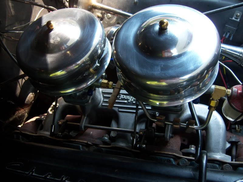

| | | | | Joined: Sep 2014 Posts: 385 Shop Shark | | Shop Shark Joined: Sep 2014 Posts: 385 | I got the new carbs yesterday and installed them last night. Relocated all fuel line further away from the block to keep it cooler. My existing runs were just above the intake and exhaust ports. It is now about 5" above that at carb level and runs across the engine bay near the rear. Installed a 1-4psi fuel regulator as i have got lots of recommendations to do from here and other forums. Will try setting it at 2.5-3 psi for the first try.
Should have it running later today. I will post up what happens.
Think that the ignition system not working correct in terms of not enough voltage or not sparking right can cause this? Weak spark possibly? | | | | | Joined: Sep 2014 Posts: 385 Shop Shark | | Shop Shark Joined: Sep 2014 Posts: 385 | I also did get a HEI system. I will try the new carbs first without the new HEI installed. I need to take a closer look at it anyways because the inner reluctor teeth are hitting the outside pick up ring. No quality control here boys! | | | | | Joined: May 2014 Posts: 22 New Guy | | New Guy Joined: May 2014 Posts: 22 | Before you adjust your linkage back off the idle speed (Not mixture) screws so they are not making contact with the cam. Then, slowly screw them in until they JUST make contact, then turn both of them exactly the same amount, about 3/4 turn. This will give you a base idle but more importantly you will know that both carb throttle plates are open equally so each carb is flowing the same amount of air. Then hook up your linkage. When it's running, whenever you adjust one idle speed screw you must screw the other in or out the same amount, this will keep the carbs synchronized so you get equal flow to each cylinder. and ensure that one carb is not doing more work.
Another thing I forgot to mention about Langdon's C/W kits is that the stainless socket head bolts he supplies to mount the carbs to the adapters are too small of a diameter. They don't "square up" the carbs on the spacer, they allow too much fore/aft and side to side movement, not ensuring that the carbs are exactly centered over the adapter bore and gasket. When I got my truck one of the carbs was offset towards the valve cover and the other was offset towards the driver's side. When I took the carbs off I could see in the imprint on the gasket that the oval hole in the gasket didn't correspond to the throttle bores. Get yourself some stainless 5/16 by 1 and 1/4 long bolts, washers and nuts. They fit through the carb base holes snugly as well as the slotted holes in the adapter. There is still a little play in the adapter holes so just eyeball it closely and center both carbs equally. I hope it turns out well for you. | | | | | Joined: Feb 2004 Posts: 29,851 Kettle Custodian (pot stirrer) | | Kettle Custodian (pot stirrer) Joined: Feb 2004 Posts: 29,851 | Every time I see one of these multi-page posts from people trying to make a multi carb system work, I'm reminded how intelligent the original designers were when they chose ONE carburetor for stovebolt engines. Jerry
"It is better to be silent and be thought a fool than to speak and eliminate all doubt!" - Abraham Lincoln Cringe and wail in fear, Eloi- - - - -we Morlocks are on the hunt! There is nothing noble in being superior to your fellow man; true nobility is being superior to your former self. - Ernest Hemingway Love your enemies and drive 'em nuts!

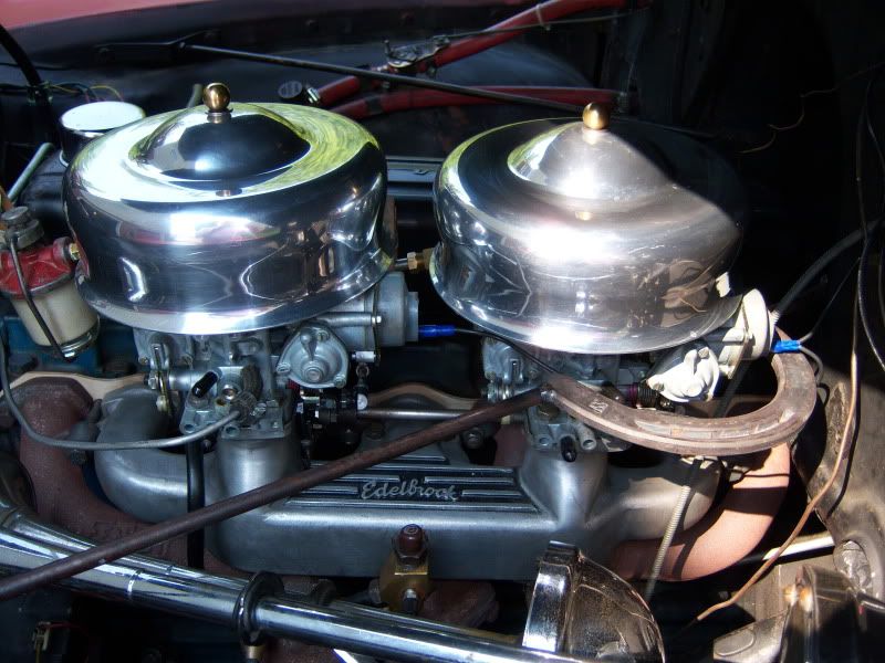

| | | | | Joined: Sep 2014 Posts: 385 Shop Shark | | Shop Shark Joined: Sep 2014 Posts: 385 | Yesterday was a good day. I installed the carbs as I noted t posts ago and got the truck back up and running. I forgot to mention that i also split the carbs for a clean out prior to installing them. I found a little debris in on of them and found that both of them had a metal build up around the idle mixture screw right at the tip. Looked like some sort of pigtail drilling debris around the tapered tip of the screw. The tips were fine and were not damaged. I also re-plumbed the lines and kept them further way from the block this time so they don't get so hot. After getting it running and warmed up i rechecked the timing to see where i left off. Currently set at 12deg and vacuum is 17in. Everything seemed fine with the distributor and was advancing during revving. Checked all the new fuel line connections and set the regulator pressure to 3psi. Went back and forth setting the idle mixture and rpm and timing till everything was ok. Final readings were, 500 rpm, timing still 12 and vac 17.5 ish. With my AMA card in hand and the tow truck number read on speed dial i got in a took her out for a boot. First thing i noticed doing neighborhood speeds is the engine was smoother than before. Got to the back paved country roads and tested out my new lead shoes. Its a completely different truck ! It pulls hard compared to before. Way more torque. When in third (final) and cruising at 1500rpm you mash it and she just gets up and goes. Still nothing to brag about but 100 times better than before. The harsh smell of gas during acceleration is little to none compared to before, and when costing in gear it almost never spits and backfires now. At higher rpms the engine is smoother and does not want to jump out of the chassis and onto my lap. It still has a slightest feeling that it wants to go harder when you just let off the throttle when accelerating hard. I will play with the timing using the octane selector now for easy adjustments and see what else i can squeeze from it. Parking in the garage the only smell i got from it was from the header wrap burning from playing so hard and a bit from the top valve cover breather, the smell of gas to me was not present in my garage anymore. I should probably install the HEI setup i got sooner than later before i go taking all the time to play with timing and then change out the system and have to do it again. [IMG]http://i96.photobucket.com/albums/l170/mazdacub/1949%20Chev/IMG_1836.jpg[/IMG][IMG]http://i96.photobucket.com/albums/l170/mazdacub/1949%20Chev/IMG_1837.jpg[/IMG][IMG]http://i96.photobucket.com/albums/l170/mazdacub/1949%20Chev/IMG_1834.jpg[/IMG] | | | | | Joined: Feb 2000 Posts: 5,228 'Bolter | | 'Bolter Joined: Feb 2000 Posts: 5,228 | Pictures look good, very clean install.
Glad its finally working out, when you get some time, pull the first set apart so we can see whats in them.
Now go drive the wheels off it, the HEI can wait a while!
Joe | | | | | Joined: Feb 2014 Posts: 215 Shop Shark | | Shop Shark Joined: Feb 2014 Posts: 215 | Nice. Multiple carbs always look good. Most people can't even tune one carb, much less two or more. Even some "experts" don't know everything. I've worked with Holley, Carter, and Quadrajets, plus Mikuni and others. Lots of information on these on the web now, so a person can learn a lot with a little homework. They aren't as scary as they look.
Good luck with the rest of your project. | | | | | Joined: May 2014 Posts: 22 New Guy | | New Guy Joined: May 2014 Posts: 22 | Congratulations! When these carbs are clean and set up right they work really well on the inline Chevy. Glad you got it sorted out. What kind of HEI setup did you get? Large cap or small? I recently installed a performance large cap setup on my 235 and it made an amazing improvement over my Mallory dual point.
Your truck looks great! You have done an incredible job with it. So much attention to detail, routing of cables and hoses, rear discs, rear sway bar with poly bushings. Very impressive!
How about some details regarding your power steering conversion? The pump and alternator mounts and brackets are different from what I've seen before. Yours are MUCH cleaner and look almost factory. Why don't you start a new thread about it with pictures and details so it doesn't get lost in this carb discussion. I'm sure many here would appreciate it, I certainly would. You've done great work. I'm in Calgary, maybe we'll meet up at a show in Red Deer some time.
| | | | | Joined: Sep 2014 Posts: 385 Shop Shark | | Shop Shark Joined: Sep 2014 Posts: 385 | The HEI is the small unit. I made a bracket to hold the coil yesterday that will bolt in the original coli location. [IMG]http://i96.photobucket.com/albums/l170/mazdacub/1949%20Chev/HEICoilBracket.jpg[/IMG]Later today im installing the PCV valve and line. I designed and made the power steering and alternator bracket system. I still need to modify the top bracket design so its not so long and it will curve to follow the alternator pivot center. I saw a kit a guy made before to hold a pump and alt but it required a modified head bolt and still with the braced back it looks like it wobbles when running. I was actually thinking of cutting up a bunch of kits if others want it. It all bolts to existing hole locations and lets you independently adjust the tension for the alt or pump without loosening the full system.
