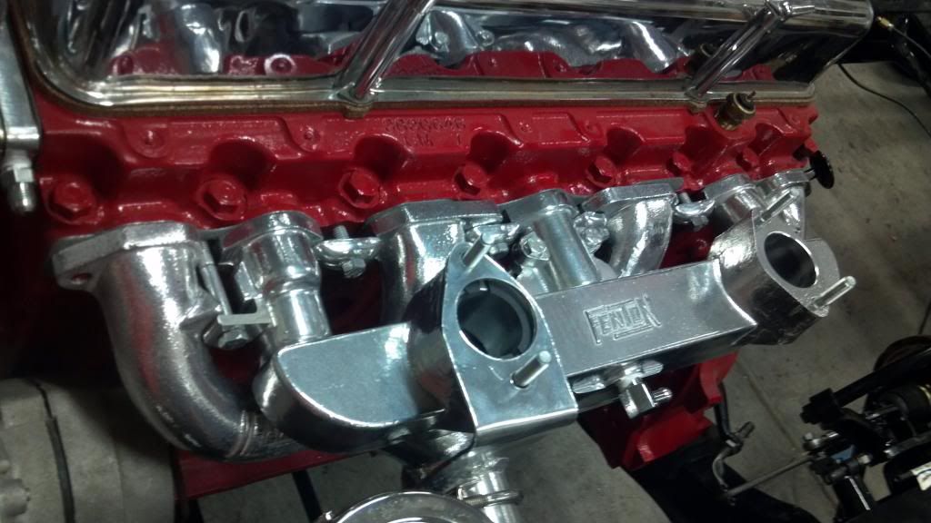

I’ve been helping a friend get his truck back on its
feet and yesterday we tackled the manifolds on the ’56
235 that’s in it.
He purchased a complete exhaust kit from National
Chevy Assn., which supplies William’s headers with the
kit. The bottom line read, “Complete with all
necessary hardware and installation instructions.”
Now sitting on the bench and hanging on the side of
the engine, these, like the Fenton headers look real
sharp, however........looks cam be deceiving.
Number one, there were no instructions. Number two the
kit did had hangers and muffler clamps but to install
the Williams headers without special manifold clamps turns
into a real pain in the ars.
We made a call to them and the guys were nice enough
to talk to but really didn’t have much to offer as far
as installation advice. The gentleman that we talked
to did say that the headers were made in Ohio and that
they used the Fenton headers as a master for the
casting. So according to that information the trouble
we have with the William’s headers should also apply
to the Fenton headers.
The trouble: First off, the flanges are cast nearly 1/8”
thicker than the stock intake, which sounds easy
enough to fix by grinding a little step in the
manifold clamps.
The way the flange is cast, the front center clamp
just barely catch the header by a about 1/32” and
only on the top of the clamp. The rear center needs to
be ground away right up to the hole and the flange
casting actually slightly over-laps the threaded hole
in the head. I won’t go into the rest of the
individual clamps, but just to say that large amounts
of the clamps have to be ground away to get them to
fit and the clamping surfaces are then off balanced
since the clamp strength comes for the compound curve
that is used in its manufacture. The strain bumps in
the center gasket have to be flattened in order for
the Williams headers to fit flush, this makes the
gasket longer and it overlaps the exhaust port by
about a 1/16” on both ports, this also destroys the
ability of the gasket to act independently on the two
exhaust ports and single intake port.
I seem to recall posting something on this subject in
the past about the fit of the ‘new’ Fenton castings.
Back in the day I’d installed the original Fenton
headers and they were a well-made direct bolt on part
that required no rework to the castings or clamps.
If they have made ‘upgrades’ to the ‘new’ version of
cast headers then they should also supply a proper
center gasket replacement and newly designed manifold
clamps with the header. I hate to have to say this but
I’ve had to do less rework from parts that came from
across the Pacific than I did to these parts that came
for Ohio, USA.

There is simply no way that you could use the stock manifold
clamps without, as Charlie puts it, "extensive work". If I had
my Bridgeport set up I'd just machine a set of custom clamps
because by the time you grind away the stock ones there is
hardly any decent clamping surface left on them.
We're using the stock intake manifold on this truck, still, even if the headers
were matched an after market intake that wouldn't change the
way the headers are cast, which is right in the way where one
needs to clamp them up.
Chuck, I'd really like to see some pictures of your William's
headers that you installed on your truck, since you say they
mounted right up without a hitch.
I have to disagree with those that expect to modify everything
that we buy for these trucks. For the kind of money that we're
shelling out something like this should be a direct bolt on
item, without any modification or at least with replacement
clamps that would make the install solid.

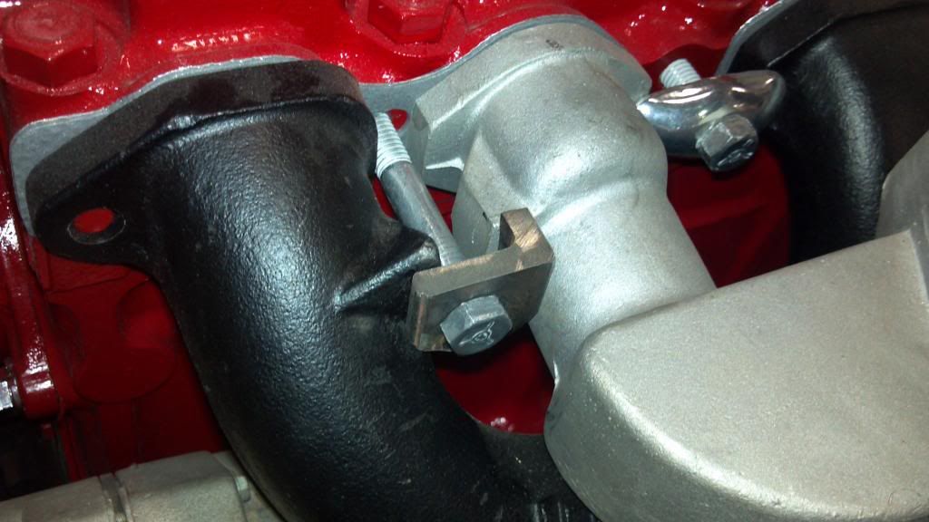

Heres what I did. I saw it in a book, bought the angle iron and started modifying.
Rear
Front
Finished product
"As I lay rubber down the street, I pray for traction I can keep, but if I spin and begin to slide, please dear God protect my sweet ride." -Amen

Your welcome Tim. I actually read it from The Classic Chevy Truck Handbook on page 38 written by Jim Richardson. The illustration in the book looks better than mine but I am still pleased how the came out. I tried every which way to grind and make the others work but they did not look or fit right. I am glad I read about that

Looks great, Tiny_Jaime.

Yep, that looks like the only way to get them to fit, make your
own. Obviously the after market intake is different than the
stock single manifold. The stock center clamps won't work
without heavy grinding and in some cases they aren't long enough
to span the two flanges, only grabbing them by a 1/16" or so.
