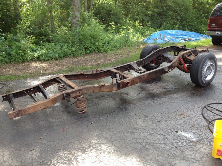

Over the weekend was able to find a nice 65 shorted frame and a pair of short fleet side bed sides to go with it! First step is power washing the 50 years of grease and road grime off...but the thing is in amazing shape...just a little surface rust.[image]http://www.tabbnet.com/C10/NewShortFrame.jpg[/image]
