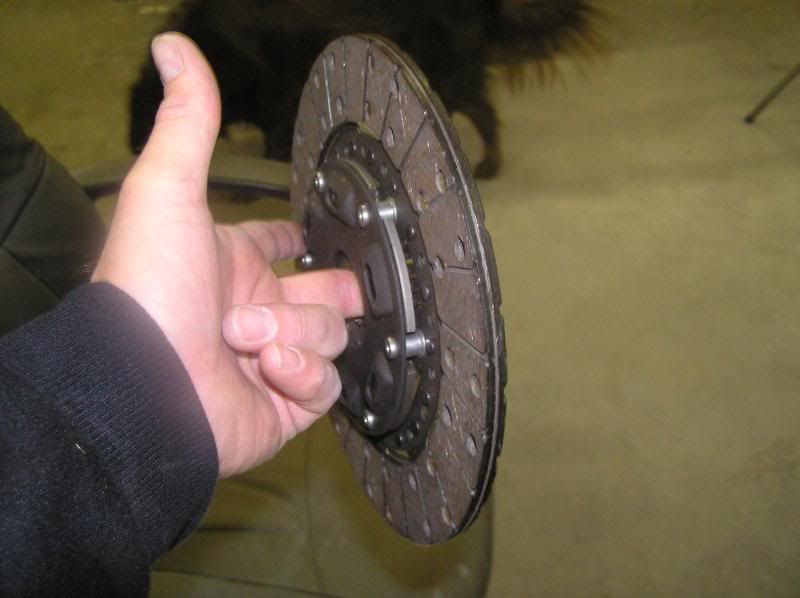

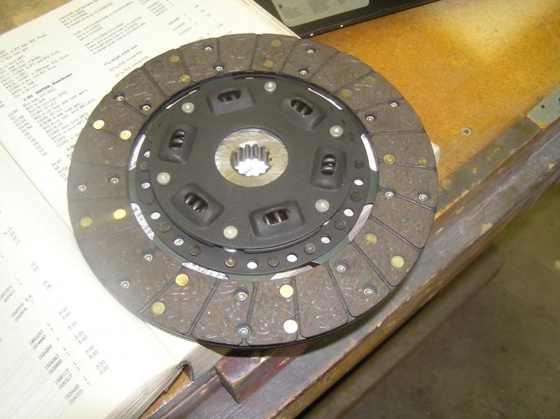

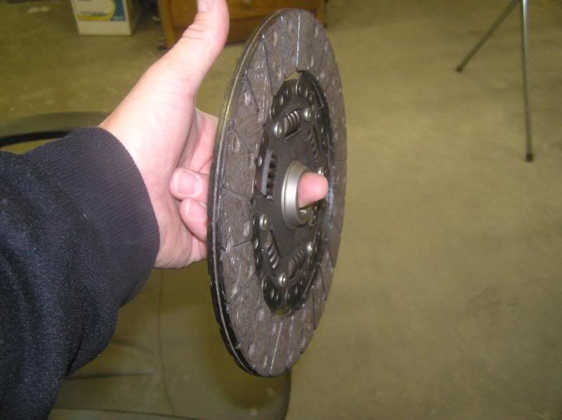

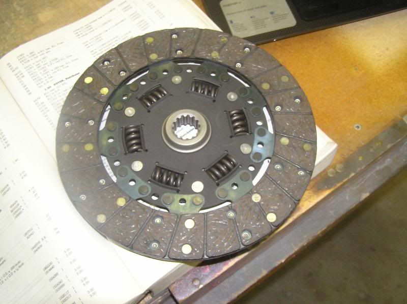

Built him a clutch disc for him.
9" 14 spline clutch disc
will withstand a v-8
They machined the center hub so you do not have to lengthen the splines on the input shaft for travel of clutch disc.
9" clutch disc
9" clutch disc #2
9" #3
9" #4
$155 shipped
He will be putting it together this weekend,I'll let you know if it works.

Why do you have to get a different clutch disc for the conversion?
1954 3600 Chevy Truck
"The Fake Truck"
More pix on Photobucket
Joined: Dec 2005
Posts: 2,557
Joined: Dec 2005
Posts: 2,557
If you use a jeep 10 spline input shaft you could use the original disc.
The t-5 he has is 14 spline input shaft,so he had the clutch disc built for the conversion. no spacer plate or lengthening the splines are needed.Just cut the throw bearing collar and input shaft snout to length.

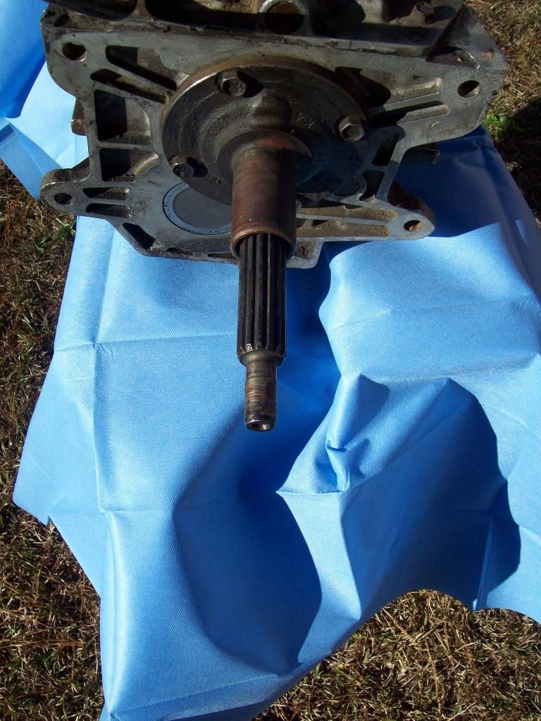

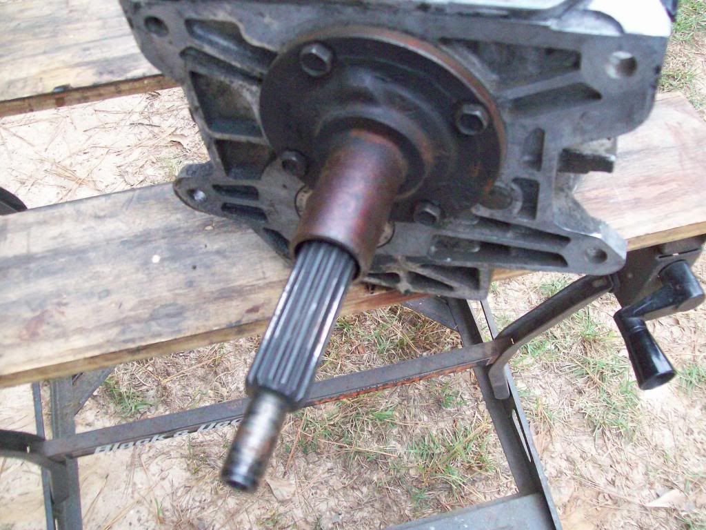

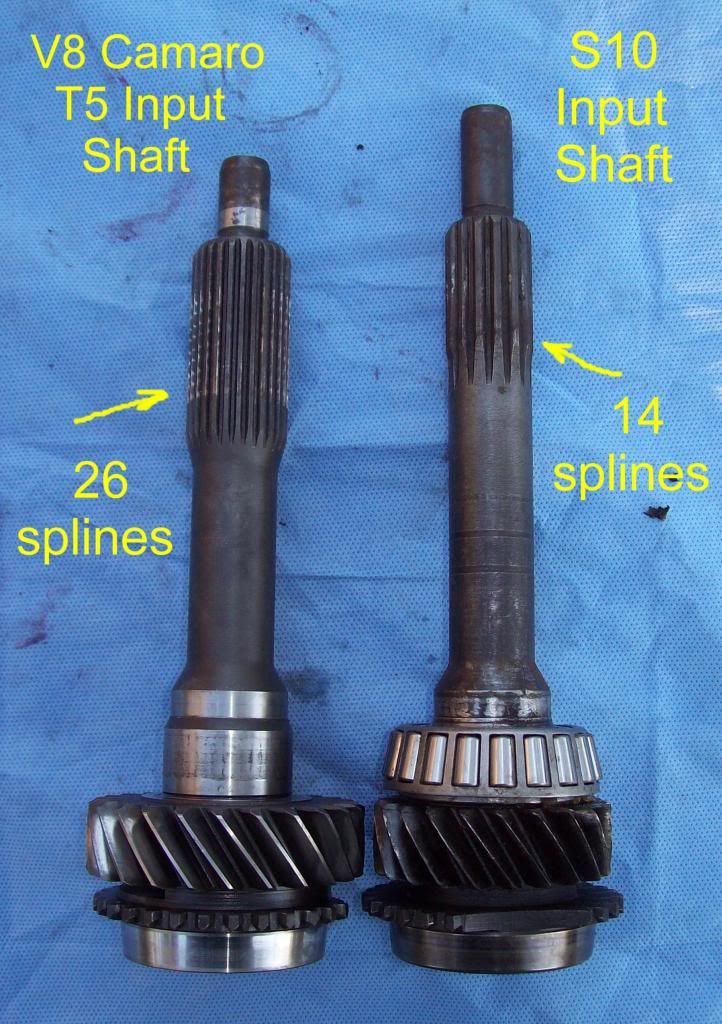

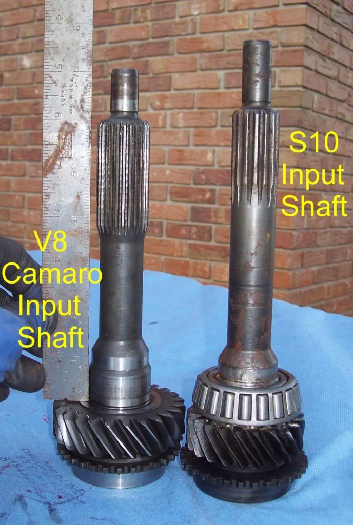

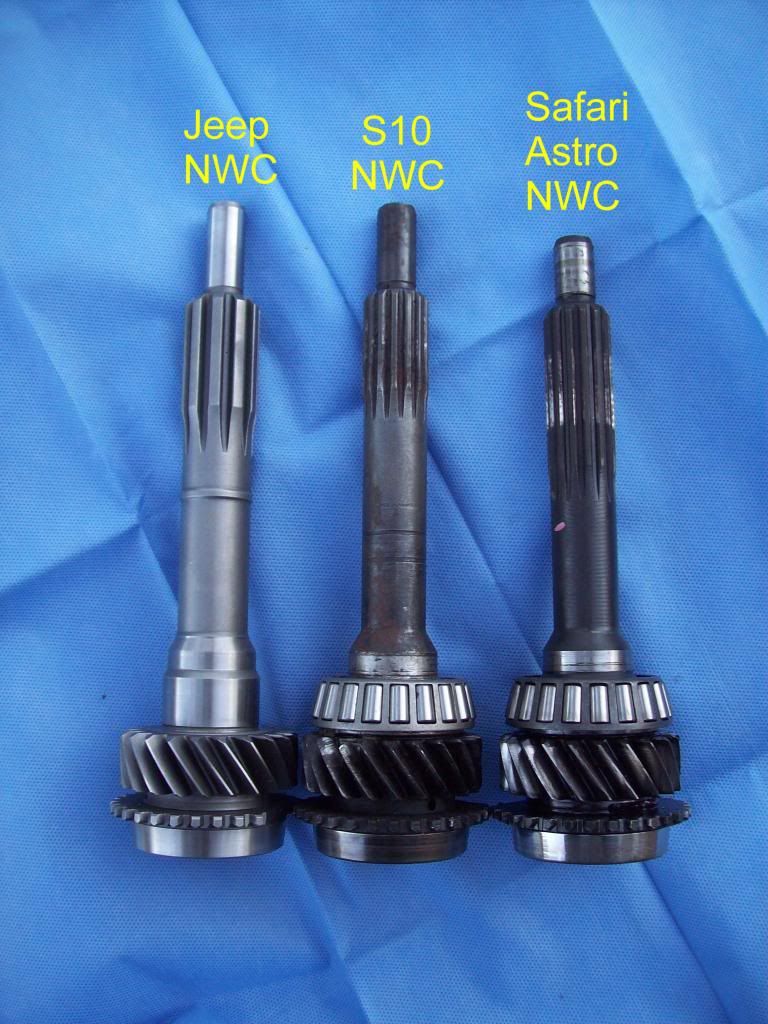

I have run across several different solutions that people use to adapt an S10 T5 for use in their trucks. Not that any one is the best, but here is what I have read about. Each approach has a different advantage over the others.
1. Tom Langdon has advocated cutting a short bit off the end of the input shaft and then grinding out (or machining) a portion of each of the friction disc inner hub splines. That way the input shaft splines don't need to be lengthened.
2. The adapter plate is a one time expense and solves the problem plus you can sell it if you ever switch to an automatic (if you have a bad knee or hip for instance).
3. A V8 Camaro T5 and an Astro T5 have the correct length bearing retainer and correct length input shaft so no modification is needed. Just use the correct splined friction disc and throwout bearing. The Camaro T5 will need an S10 tail housing swapped so the shifter is in the forward position.
4. This next idea is perhaps new to some. Look at the photos of the V6 Camaro T5 I have. It has a 14 spline input shaft that is too long (same length as the S10 input shaft). However, the splines are cut all the way back to the bearing retainer and it has a short style bearing retainer just like the V8 Camaro and Astro T5s. I have not done anything to it yet, but hypothetically, simply nipping off the correct amount from the input shaft is all that will be needed. I'm pretty sure no adapter plate would be needed.

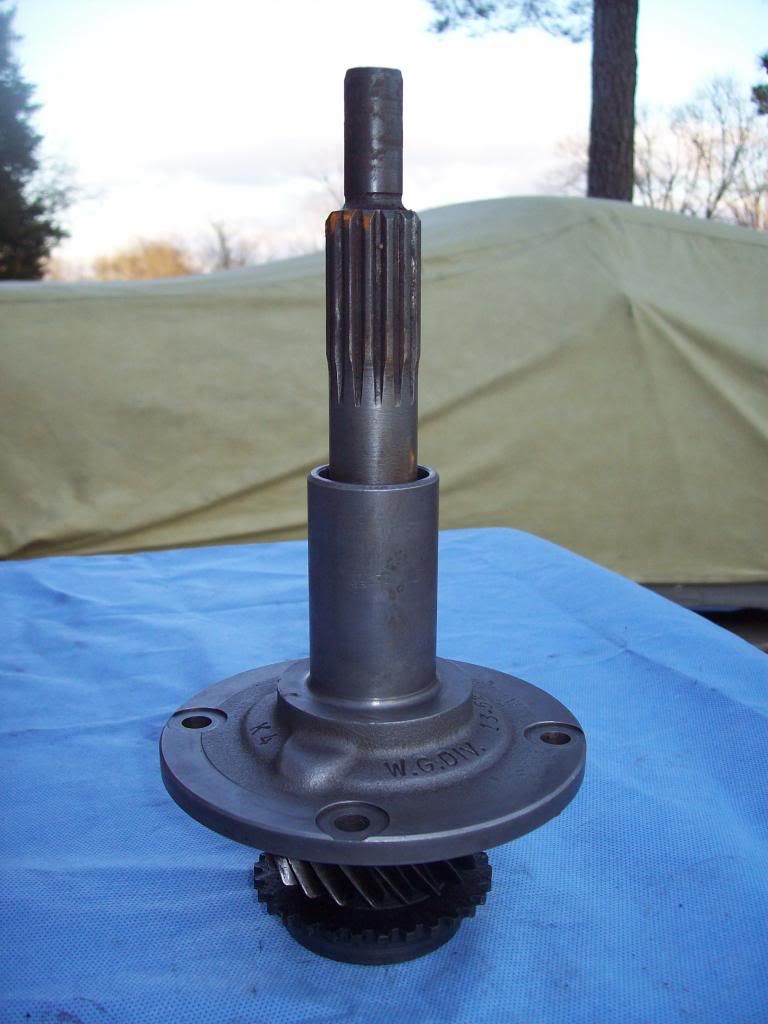

Also included are some side by side photos comparing the length of an S10 and V8 Camaro input shaft.
14 spline input shaft - 1989 V6 Camaro World Class T5 - photo 1
1989 Camaro - photo 2
Astro van Input shaft - 14 splines and no adapter plate needed
V8 Camaro and S10 IS side-by-side
More
another
V8 bearing retainer on the S10 input shaft

Two months later,he installed the clutch disc and it shifts smooth. He didn't have to extend the splines at all. He did shorten the snout and the throw out bearing collar, that's it.
tim!!!!!

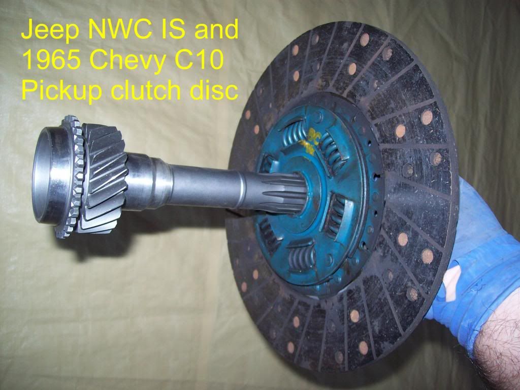

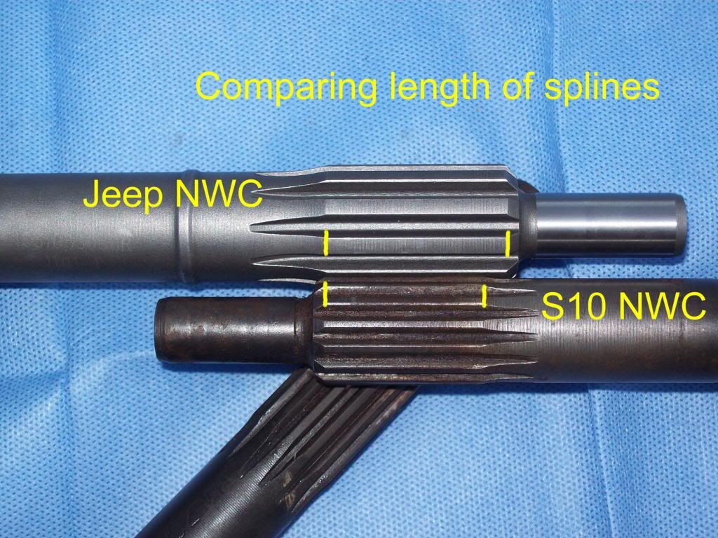

Thanks for the feedback. Your comment about the Jeep IS made me so curious that I forked out the money and bought a brand new 10 spline Jeep T5 IS. The number of IS gear teeth (21) is the same as the S10. On the bench it appears to be a great solution and the splines on the Jeep IS are cut further along the shaft than the S10.
Remove the S10 IS and replace it with the Jeep IS. Cut the Jeep IS to the proper length and then the bearing retainer too. The original clutch disc and friction plate from my original Saginaw will work (but a new one will be installed).
3 shafts side by side
The Jeep IS has longer splines.
Jeep IS fits 1965 clutch disc

Have you tried fitting the 10 spline jeep shaft in a clutch disc of a ad truck? It should fit fine.
I'm following your transmission posts.
Thanks!!!!
1951 3100 Chevrolet
Joined: Sep 2011
Posts: 2,951
Joined: Sep 2011
Posts: 2,951
Thanks!!!!
I have never tried it on an AD truck disc but the clutch shop I talk to in TX says it will work.
