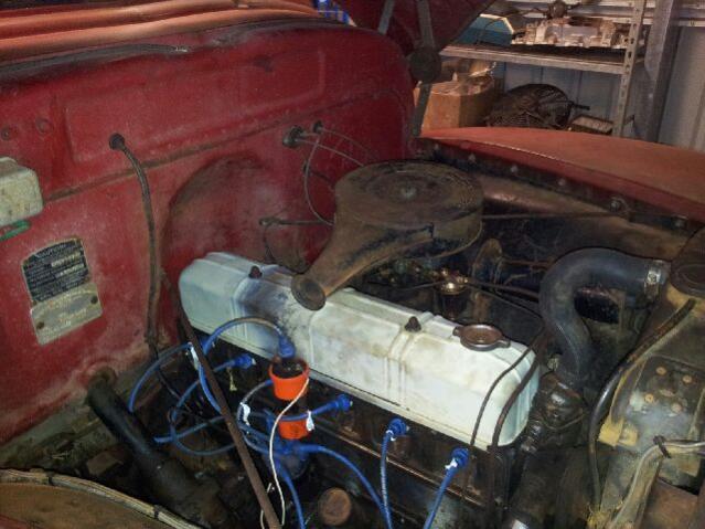

here is a pic of a RHD 50 firewall with two dataplates
...link...
