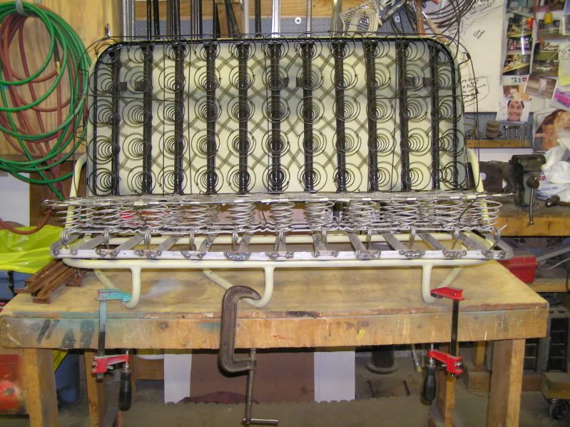

I have some updated pictures of my reproduction 3rd row seat.I found an original upper cushion at the Kansas City stovebolt reunion.Boy was it rough,but hard to come by.Sand blasted,totally taken apart,welded some pieces in the frame work.Replaced all of the springs from a donor upper cushion from a truck.Made a new outer ring that circled the springs.prepped,primed,painted and put back together. third row picture
I'm now in need for the 3rd row lower seat cushion or I will be forced to fabricate one from a donor truck seat cushion.

Nice improvisation! I thought the reproductions were to come with the radius, it looks like yours come without? Not complaining, they look great!
Looks like a fair amount of work to make them look like originals. Do you have more information on the radius on the back of the seat? How long did it take to modify? Do you have more detailed pictures?
Do you have side by side pictures of the suburban top seat spring and the truck top seat spring? Do you have a picture of a truck bottom spring that I can compare to my bottom suburban spring?

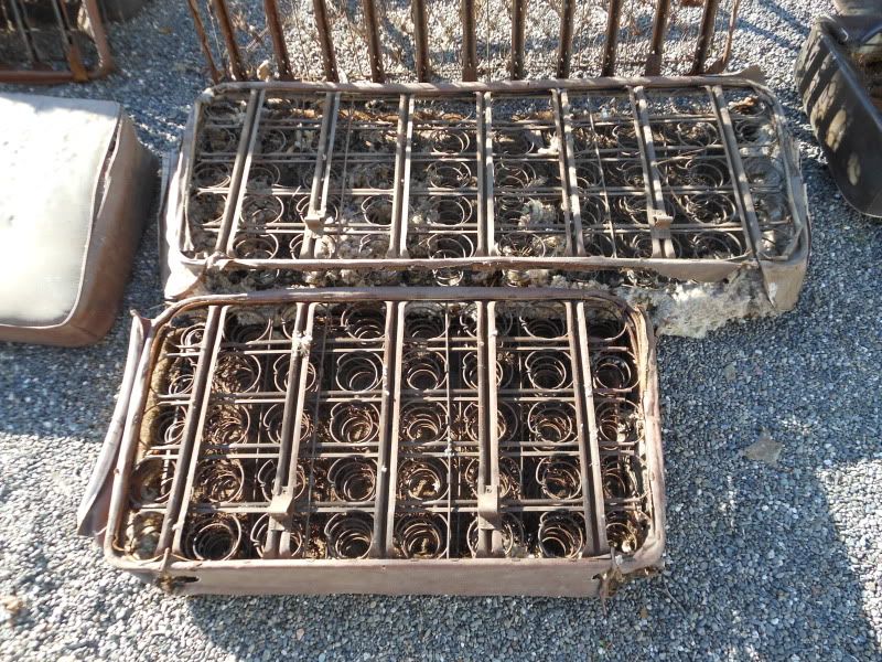

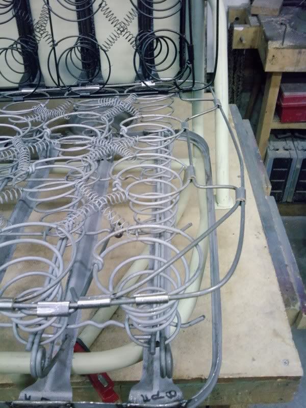

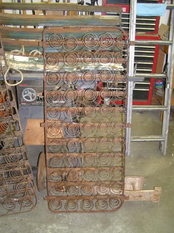

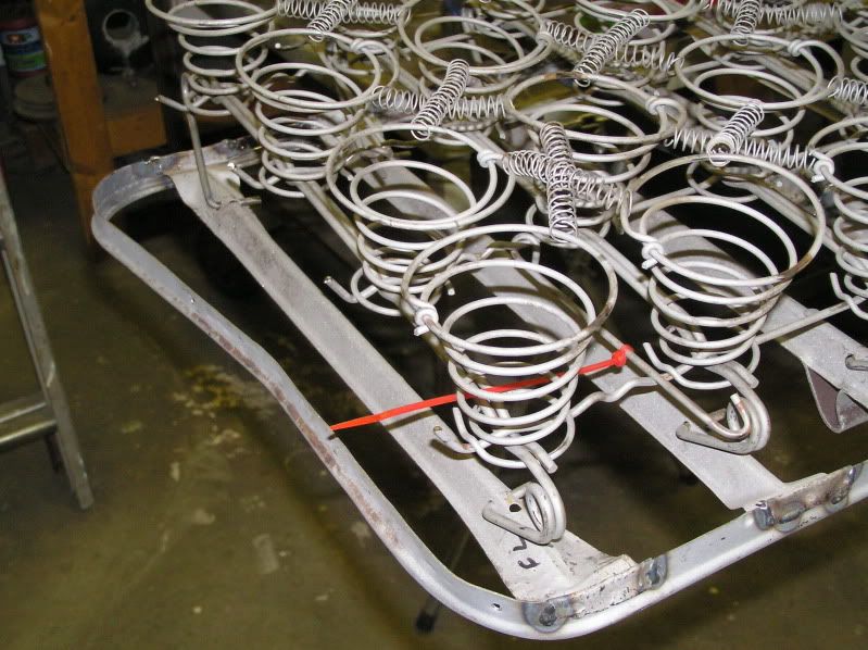

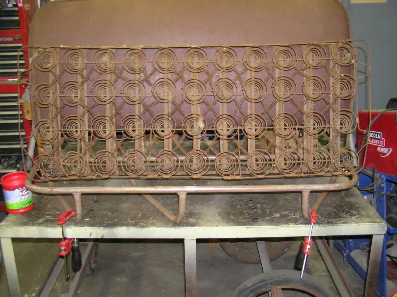

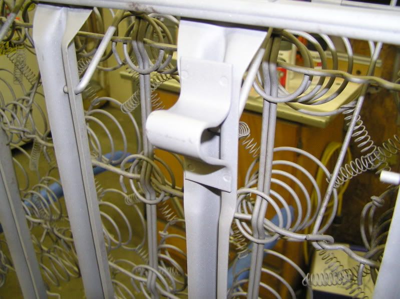

Gmoniz,here are a couple pictures of the AD truck lower cushion springs I have.I'm not sure what year my cushion is from,I know there is two different sizes.Top side of the spring cushion is about 54 1/2" at the widest point x 19" deep.
The widest point on the bottom frame work is 54" x 20 1/4" deep.Do you know what I have ?I ve already sand blasted it and it's ready for the modify.
lower AD cushion
pic#2
pic#3
Does anyone have pictures of the original lower seat cushion without the upholstery on it.This would really help out a lot.

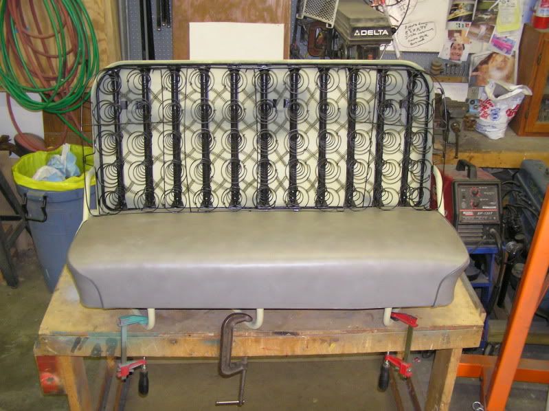

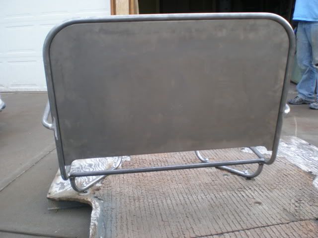

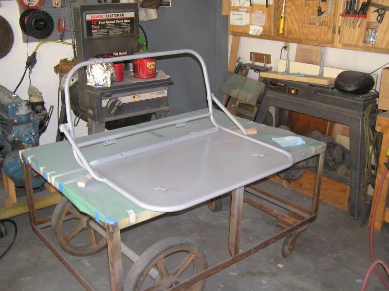

Here is what the reproduction third row seat looks like with the original cushions in place.I was able to borrow a lower seat cushion from a friend.
original lower seat cushion pic1
original cushion pic#2
Looking at the truck seat frame work and the original suburban seat cushion,they are really different.I don't know if I can do it or not.The drawing is of the very bottom frame work of the seat cushion.
outline of original lower cushion
AD truck cushion
Tim

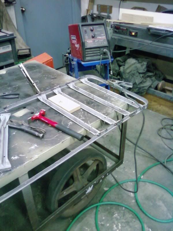

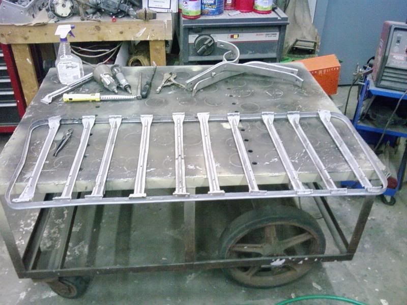

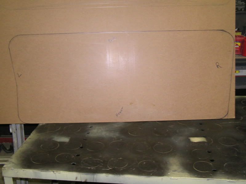

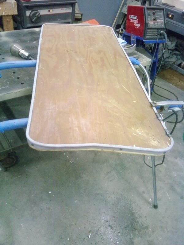

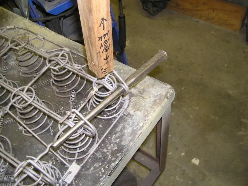

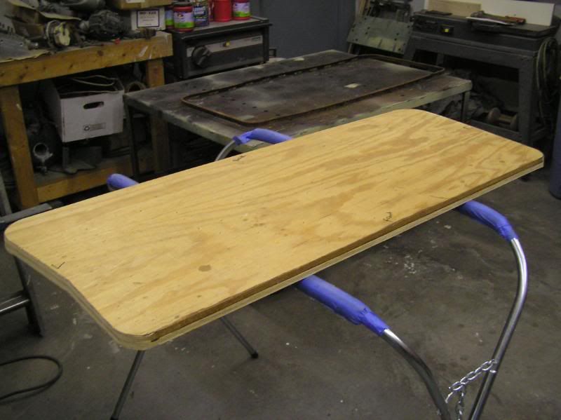

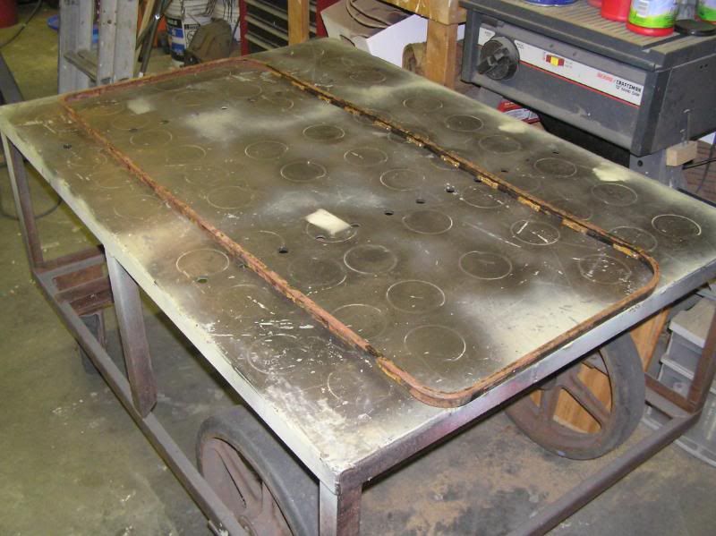

OK,I have an update on my third row seat lower cushion build.This is a template made from plywood 1" thick to make lower cushion frame. lower cushion frame template
I used a upper AD Truck seat cushion frame to make my lower cushion frame. AD Truck upper cushion I stripped all of the cross braces from it,and cut it once. AD upper cushion stripped
lower cushion frame build
lower cushion frame build pic#2
You can use the lower seat cushion frame as well,you just have to reform it.
I used the cross braces from an original suburban drivers seat cushion along with three from the ad upper cushion.Keep in mind that the truck cross braces are longer.I just cut them in two and overlapped them and welded. seat cross braces
seat cross braces pic#2
I started welding the cross braces into place. welding cross braces into place
All cross braces welded into place. cross braces welded into place pic#2
The cross braces that were from the truck cushion need to be drilled to except the seat springs"two holes per brace".
You can use the lower cushion from an AD truck,but have to take it apart and reform lower frame like I did above.The springs width will have to be shortened,the depth is about an 1/2" deeper.
I need to do some grinding on my welds and a little straightening.I'm not a welder nor an engineer,so my template and method is primitive.I will post more pictures when I start installing the springs to the frame work.

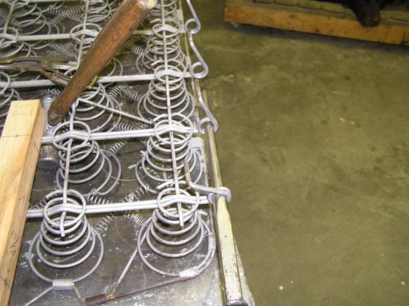

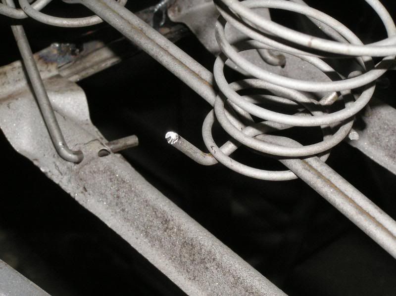

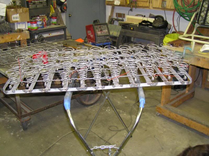

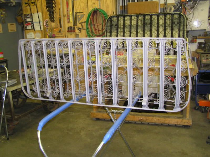

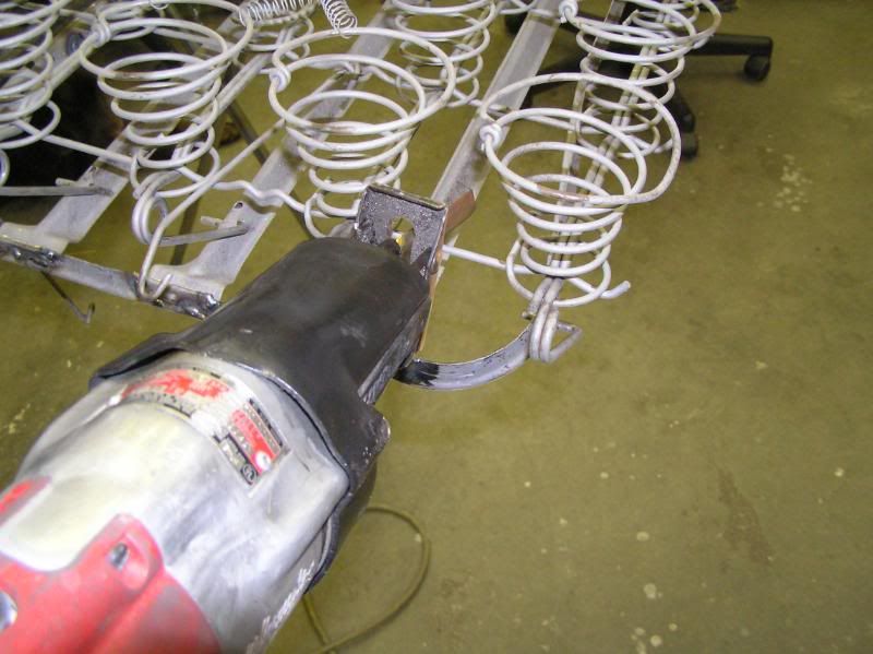

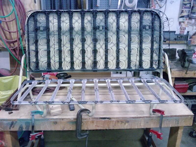

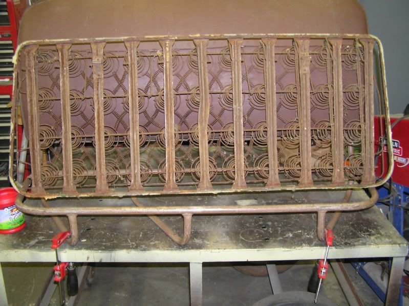

Well,I got the springs installed on the frame work I built.I ended up using the Ad truck lower seat cushion springs.I had to bend the springs where they attach to the cross braces.I made a jig and call it my spring jig.The front springs have to bent to 1 1/4" height and the rear bent to 2 3/8" height.The diameter of the spring material is 13/64" and I drilled a hole on each end of my jig. my spring jig
You will want to bend the springs with out heat,so the spring tension is not lost. bending first spring I stuck a round drift punch in the coil of the spring,so it bends correctly.I used the end of the jig"oak 2x2" applied pressure and bent the springs to the correct height. bending springs Here is another picture of the spring being bent. bending spring After I bent all of the springs into place,I cut the extra row off. cutting extra row of springs off This is the result of cutting the extra row of springs off. extra row cut off After all the extra springs are cut off,I had to bend the material upwards on each row. bending upwards I still need to grind the edges of each row I just bent upwards. all ends bent upwards
Fitting lower seat cushion fitting lower cushion

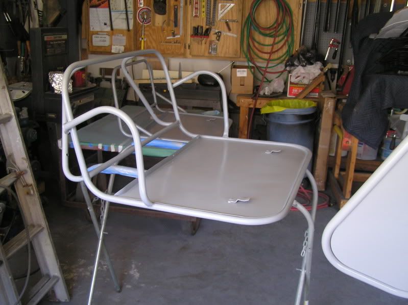

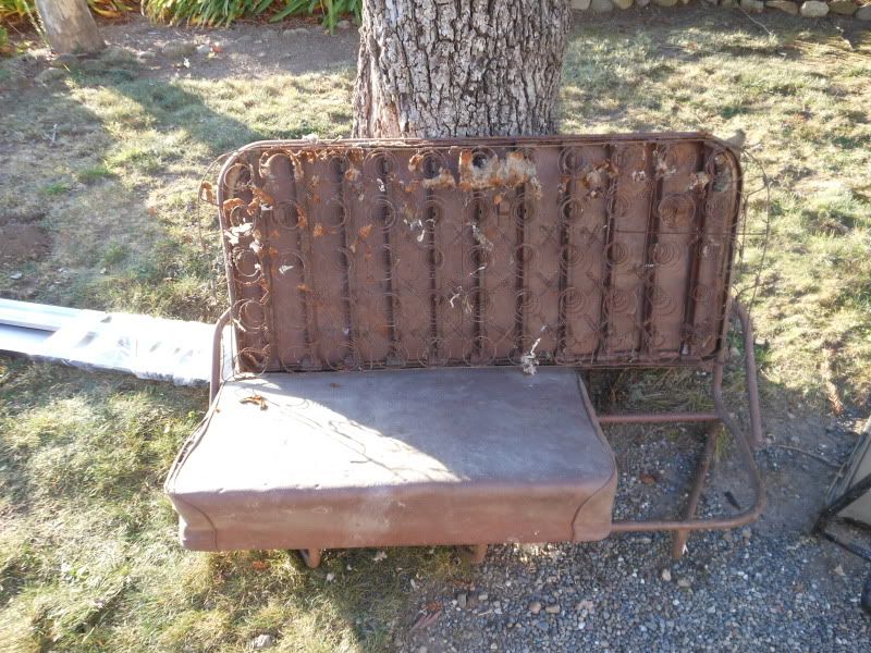

I recently purchased a oem third row seat.
oem third row seat
I'm going to remove the upholstery off the lower cushion to see how the upper ring is built.This will allow me to finish my lower cushion that I'm building.

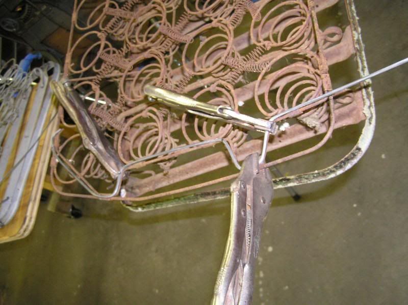

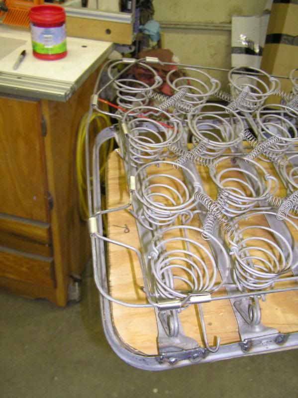

I got a little more done to the lower seat cushion build.

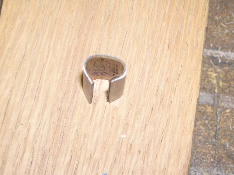

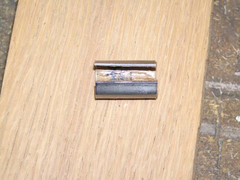

I bought some bw clips to hold the edge wire to the springs and wire edge braces. bw clip#1
bw clip#2
one pound of 7/8" bw clips is about 114 pcs.
the upper outer ring is made from #9 gauge edge wire that comes in twelve foot lengths. upper outer ring
making the outer ring to spring wire braces.These are also made from the 9ga edge wire. outter ring braces
outer ring brace #2
fitting and clipping bw clips loosely. fitting upper ring

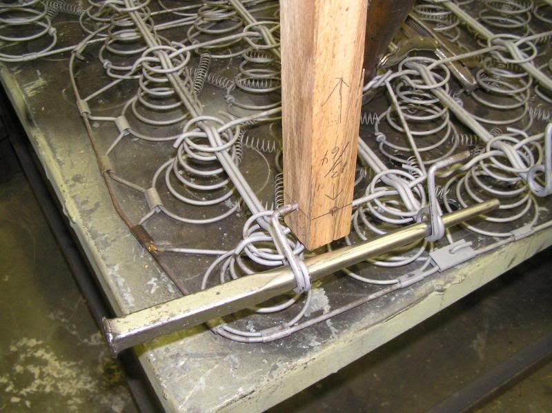

here is what my original lower seat cushion looks like without the upholstery on it. top view
bottom view
The lower frame work I built has a bend in the left side.I copied it from an original lower cushion.I wonder about how many different ways they were built from 1947-1959. lower framework I built
I have four braces to build and install,bend and shape everything and I'm done with it.
The bw clips and edge wire can be purchased from upholstery suppliers.I used national fabrics company INC. here local.

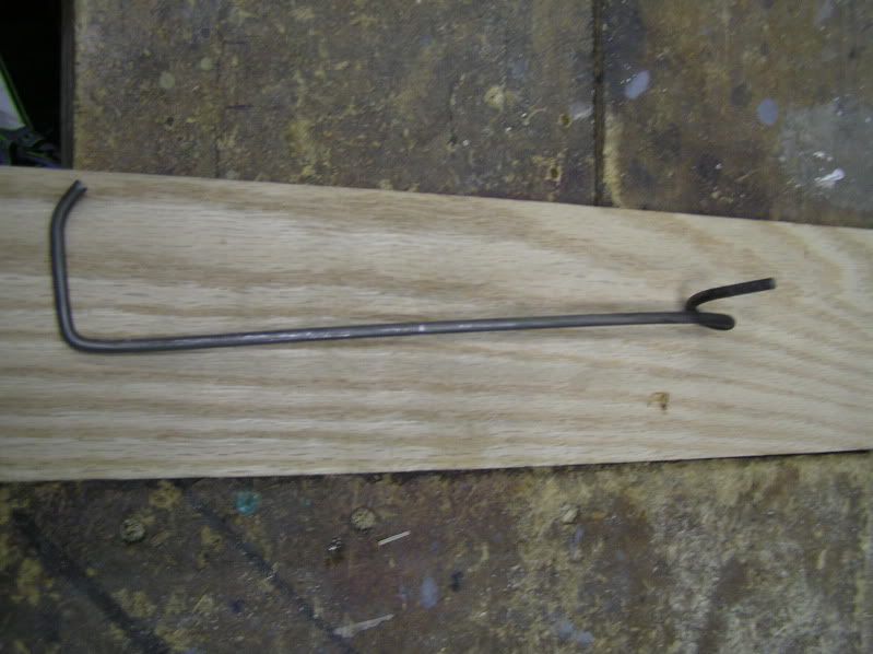

I had to make 4 tension wires from 9ga stock. tension wire 9ga
9 ga. tension wire in place
All bw clips crimped and all 9 gauge wires in place. cushion fitting

Tim,any upholstery vendor should be able to supply the bw clips and edge wire.The bw clips have a paper lining for an anti squeak and rattle.I paid $2.50 for each 12 foot stick of 9 gauge wire.The bw clips are about $5.25 per pound and there was 114 pcs in the pound I bought. 1 lb bw clips My supplies came from a local company.
National Fabric Company Inc
901 S 7th St, Kansas City, KS 66105
913-281-1833
There is a special plier that crimps the bw clips,But I was told most shops use regular pliers.I had no trouble using plain pliers.

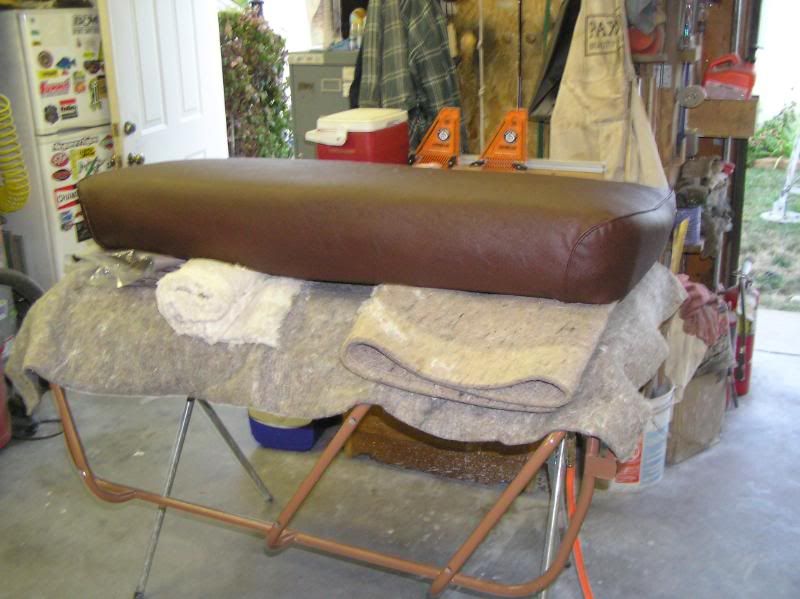

I need to prime and paint the lower seat cushion,then the fun will start.I'm going to install the burlap,joot,cotton and then the oem seat upholstery will be installed or I will buy one from jim carter.I will keep this post going until I have the upholstery installed.

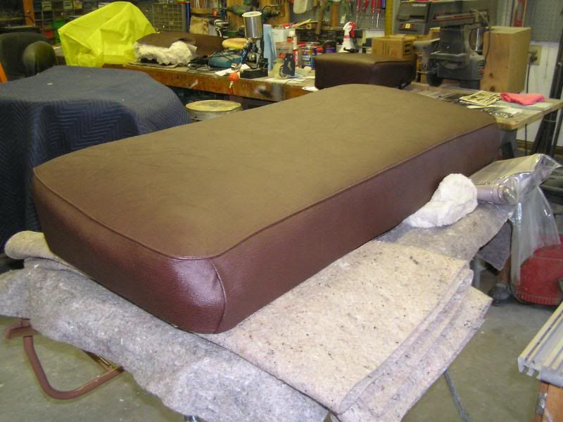

The oem seat I have has had the cushions recovered. oem third row cushion
Here is a picture of another cushion that has been recovered. 3 rd row cushion
My cushion doesn't have the bead on the front part of the upholstery like the one in the second picture.I have seen the cushion covers made both ways.The upholstery kits that Jim Carter sells also have the bead in the front of the seat.
How did the come from the factory ?
Tim

Mike,I only had to replace one coil spring.When I converted the AD truck frame,I had one row of springs left over and used one of them.

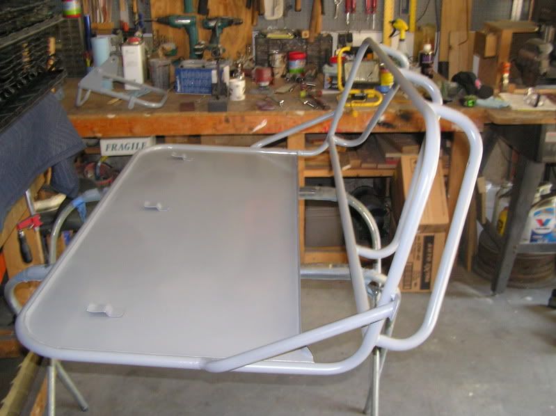

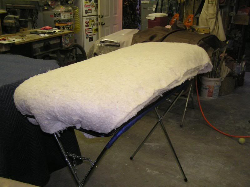

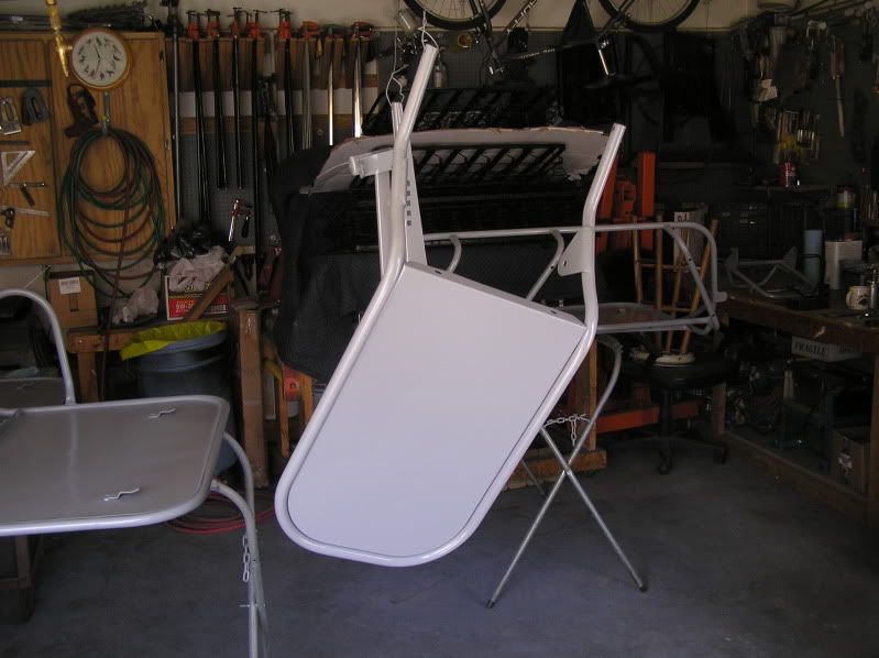

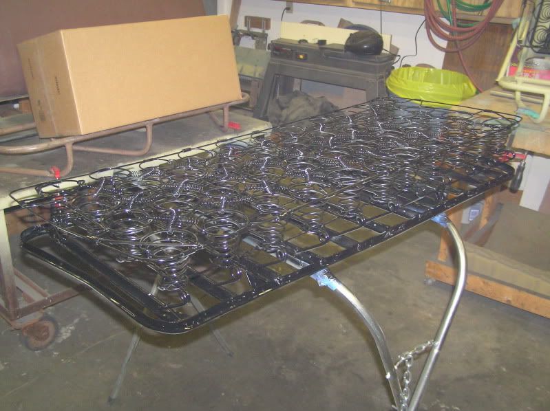

Finally got the lower spring cushion primed and painted. primed
painted

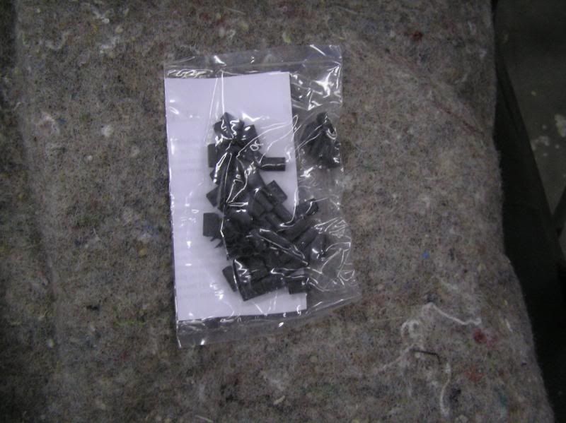

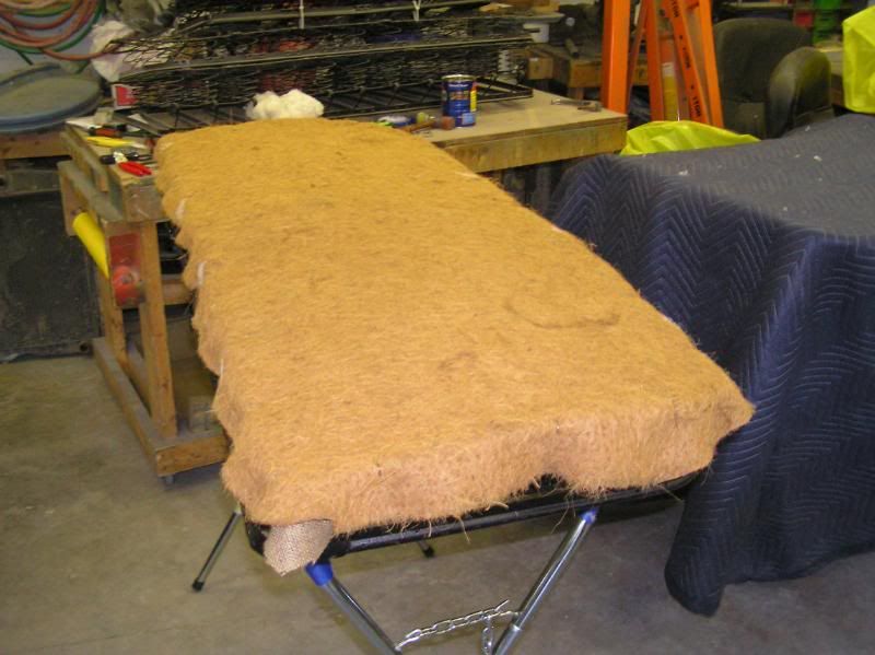

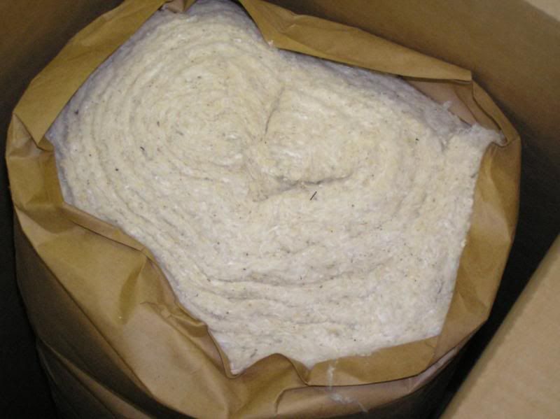

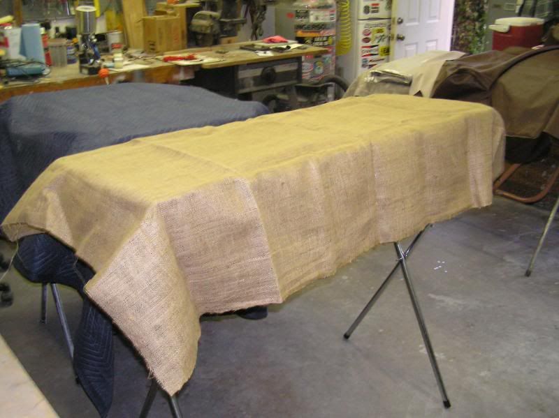

I purchased a seat installation kit from Jim Carter,it contains the following.
Upholstery C clips C clips
jute
Cotton
berlap
This kit comes with enough material to cover upper and lower seat cushions.The C clips are used to hold the upholstery to the seat cushion frame.

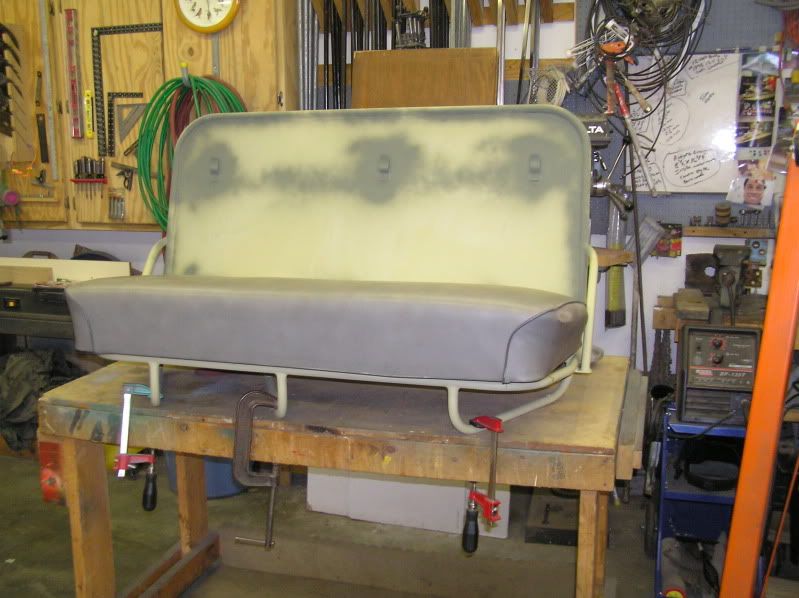

I had all of my seat frames sand blasted and I metal prepped them with DuPont metal conditioner"acid". I epoxy primed all seat frames.
driver seat frame
passenger jump seat
middle seat
third row seat
I will be fixing the dings in the back of the seat frames next.
Stay tuned !!!
Thanks,Tim

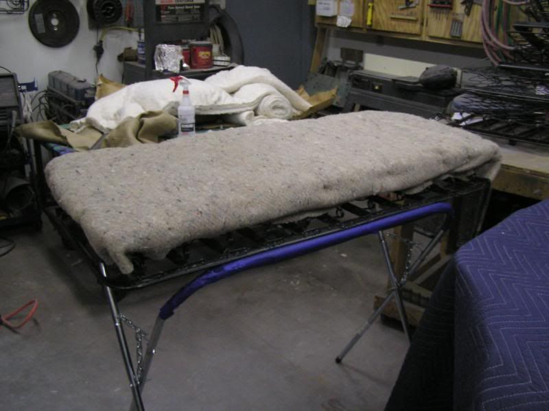

OK,here is a long awaited update for my fellow suburbanites.
I decided to upholster my interior myself,keep in mind this is my very first time attempting it.I purchased the Spanish brown grain kits from Jim Carter.These pictures are of the lower seat cushion I built for the reproduction seat frame from "elhippie64".
burlapI did trim the edges and hog ring it to the frame edge wire.
This is Coir" woven coconut fibers" also called cocomoss. coir
jute
cotton

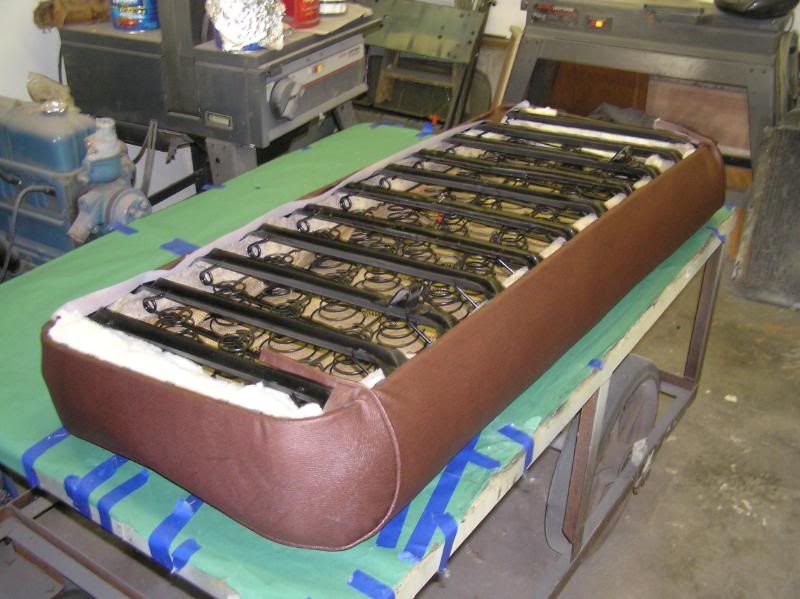

lower seat cushion covered
lower seat cushion #2
lower seat cushion #3
I wrapped the tips of the pliers with electrical tape,this prevents damage to the material while installing the c-clips.
I have started covering the upper cushion,but not done with it yet.
Tim
1951 3100 Chevrolet
Very nice job, Tim.
Very nice documentation.
Where did you get the coir?
By c-clips, do you mean hog ring clips or the c-shaped clips that were originally used?
Joined: Dec 2005
Posts: 2,557
Joined: Dec 2005
Posts: 2,557
I bought it online 2'x36' long roll.
C shaped clips,hog rings were not used on the seat upholstery.
