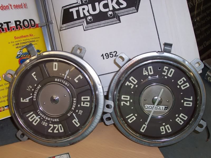

When putting the decals on my 52 guages I found that it worked good to be sure the guage face was wet/damp so I could work with the decals just a little. ANY tiny grain of dust/dirt will show. I had one but when installed it is not noticeable.
Give it a spin. You can do it.
EDIT: here is a pic of mine.
http://i140.photobucket.com/albums/r19/LutherParris/52Panel/picsforphotobucket001.jpg
