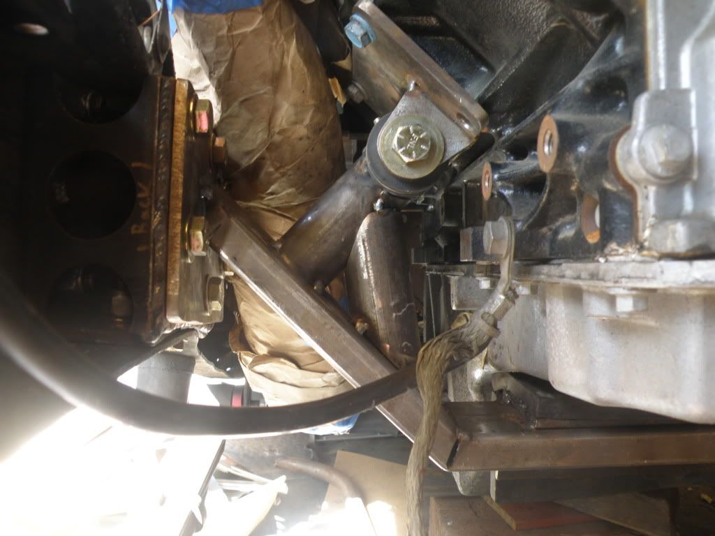

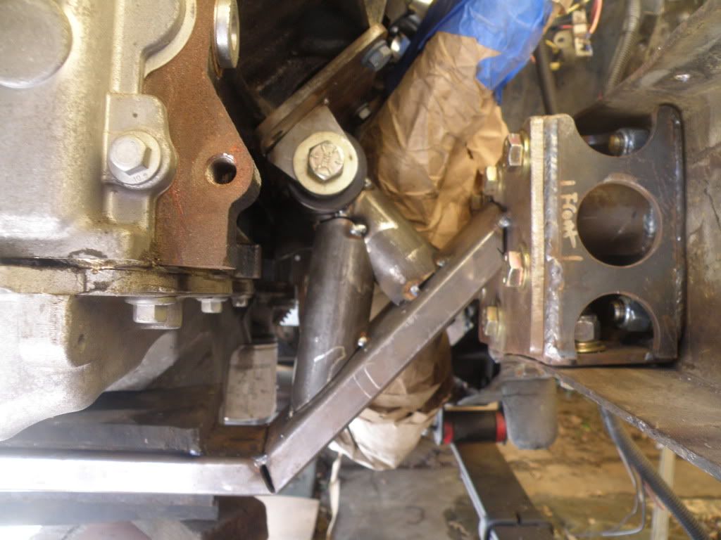

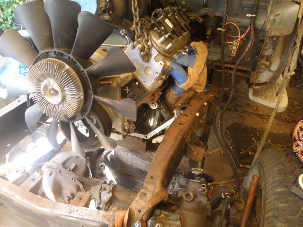

I don't know about the s10 swap kit, but I have a 6.0lt. if your thinking about building your own; put your engine where it needs to be. we moved back until the heads hit the firewall. the 2holes infront of my crossmember are for the stock V8 mounts. heres how we did it:
if you build your own
make what you need
when all else fails
radiator clearance is what your really after
