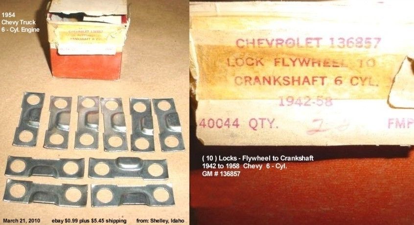

I bought these a few years ago on ebay.
I've seen them on ebay many times since.
Printed on the box 1942 to 1958
Chevrolet 6 cylinder.
SEE PIC @ photobucket below:
http://i669.photobucket.com/albums/...eltoCrankshaftLocksGMNOS_zps3a1286fc.jpg
George

George,
That's the ticket.
What words do/did you use in the search on Ebay?

Tim, Found these by going back to sellers that, I previously bought vintage GM NOS parts from.
Seems that the one's that I bought from
before keep finding more nos parts.
This seller has slowed down some in
the last year or so.
If I were to search...I'd search:Flywheel Locks.
The number thats on the box: 136857
If that's a valid GM part #.
Seacoast Chevrolet in Wannamassa, NJ has ( 64 ) of them.
Seacoast is only ( 4 ) miles from me.
There phone # is: 732-918-1100 .
Tim, send them my photo to see if it's the
same part they have in stock.
Let everyone know how you make out.
