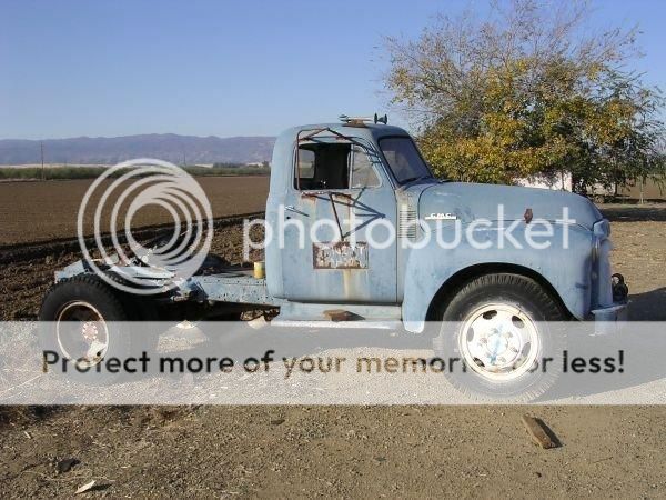

can any body identify the model of this GMC my new project from the picture as i havnt got the vin plate details yet
just hope the picture link works,

47-53 GMC
Is there a size number on the sides of the hood?
Most likely you will need the code off the Vehicle ID plate?
Maybe Spanky or crenwelge will post advice?

Hy spanners and guys, I'm pretty sure it's a 1951 (turn down door handles and vent windows) and probably a 400 and up series.

we were told that the title says 1948 but we wont know much more untill it lands in the uk.
i,m off to see the shipper/importer in the morning , i mat find out a bit more .

Looks like a '47, or '48 model, with '51 doors. '47, & '48 models had no inside cab fuel tank, so no fuel spout was on the passenger side below the belt-line. 1951 was the only year for both vent glass, & pull down door handles. It's going to be either a 450 series 3 ton, or 470 series 3 1/2 ton. Should be a "GMC Service Parts Identification" tag on the back of the glove box lid, with all of the trucks info., such as engine size, transmission type, axle type, & type brakes. Neat truck. Where was it located ?.

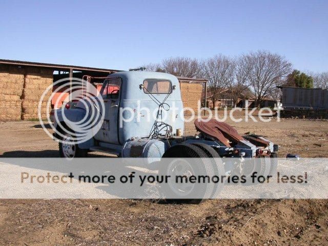

who can identify the extra clocks/gauges and controls
that can be seen inthe cab interior photo ?

Hy spanners, I think some of the extra stuff in the cab is a tach, a turn signal switch, an air brake hand valve, an air pressure gauge, and the remnants of a dash fan I think.
