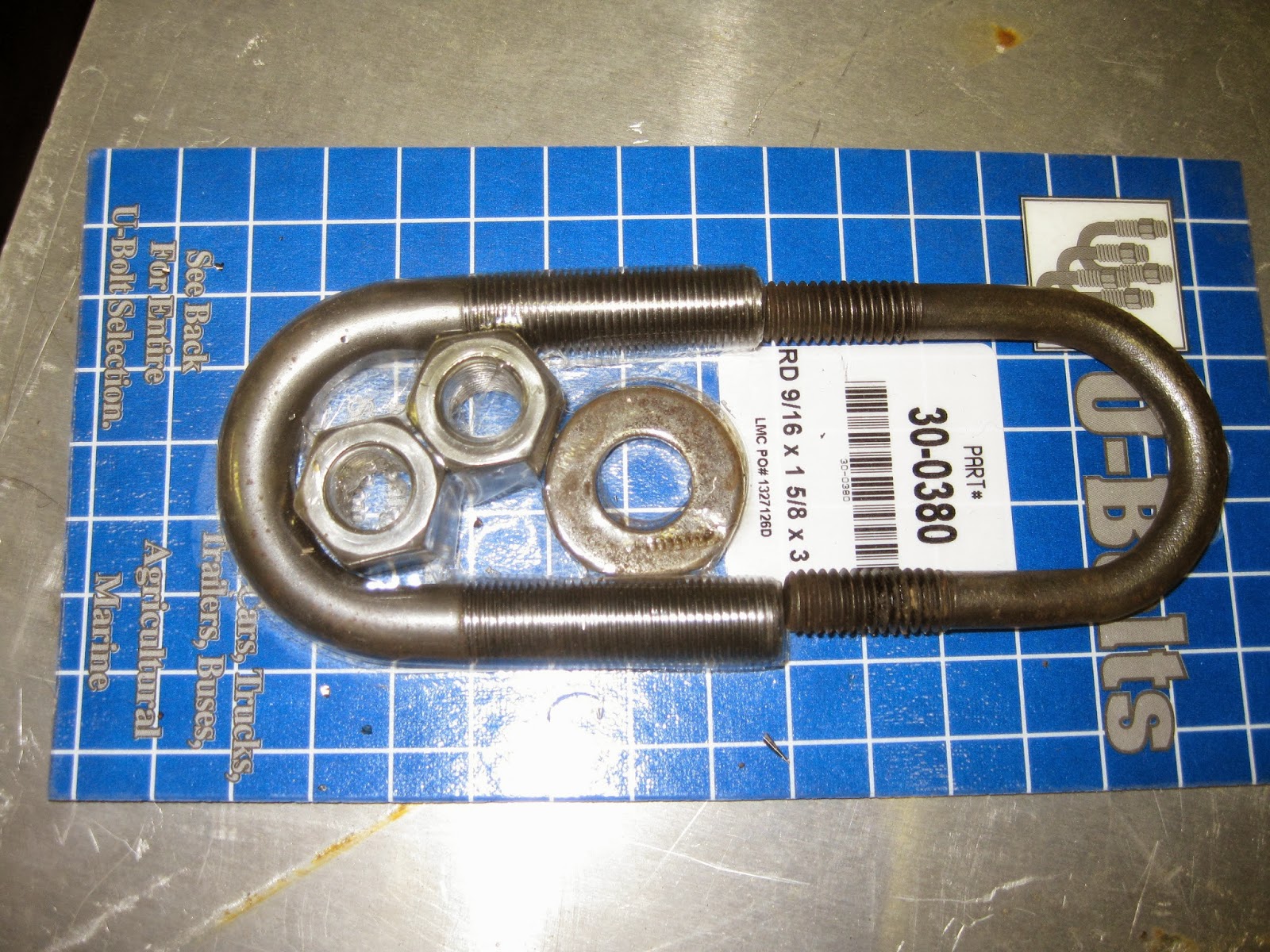

Shot of the new 9/16" u-bolts installed after drilling the frame.
Installed
New vs Old size difference
