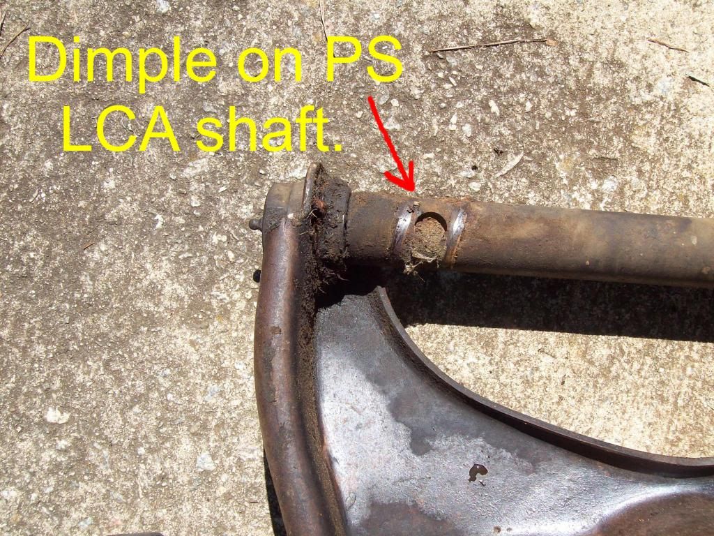

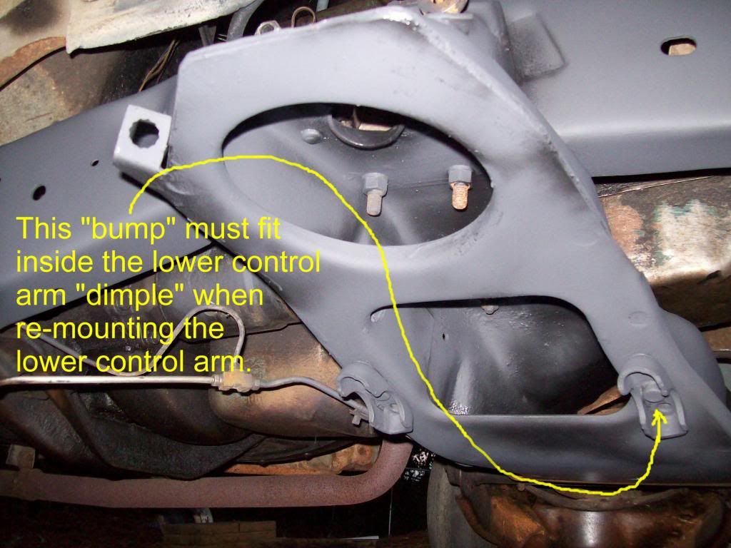

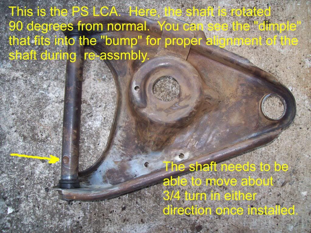

I take pics of everything. pix This may help. I remember stumbling across the "dimple and bump" while reading my FSM looking for torque specs. It must line up or it will not be flush. Make sure the shaft is about mid-way in the rotation before you line up the bump and dimple.
These pics are all from the PS assembly.
Bump 1
Bump 2
Dimple 1
Dimple 2
Bolted up it will sit flush in the saddle.

The shafts have a dimple that needs to line up with the rivet/dow pin that comes thru the front-side lower a-arm saddle. The pin will set into the dimple. Be sure the dimple end of the shaft is toward the front side of the A-arm when replacing it.

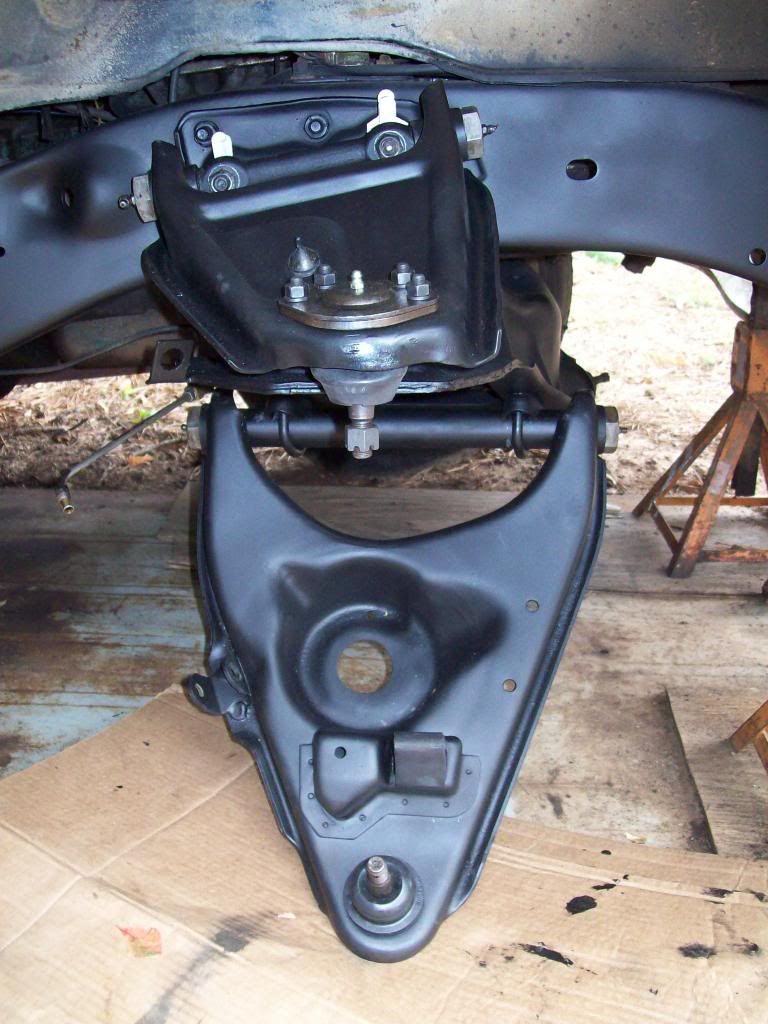

Shot of the new 9/16" u-bolts installed after drilling the frame.
Installed
New vs Old size difference
