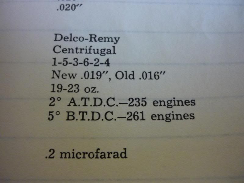

Trying to get some power out of my 1954 Chevrolet 261. It's absolutely gutless on a grade but great on the flats. I fiddled with an old timing light today and set the distributor to what I thought was correct. Took it out for a spin and it was the same. What I need to know is how do I set the timing to 5 degrees BTDC? I have a 25+ year old timing light that I guess I don't really know how to use. The pictures below hopefully will show you what I have and possibly how to get-r-done.
Picture 1
Picture 2
Picture 3
Picture 4
How do I set the dial to 5 degrees BTDC? ohwell

OK, the book says for the 261 it should be 5 degrees BTDC. How do I do that with the timing light I have? I don't fully understand the BTDC and ATDC as it relates to my vintage POS light. Also I didn't have a vacuum gauge but just bought one like yours off ebay for under $20. So once I get the gauge, what is the vacuum I'm looking for at idle?

I don't have experience on your engine, maybe a 261 owner will chime in. All the settings will be in the shop manual for your year engine.
On my 235 I set the octane sensor to 0 and time it with the pointer on the ball.
