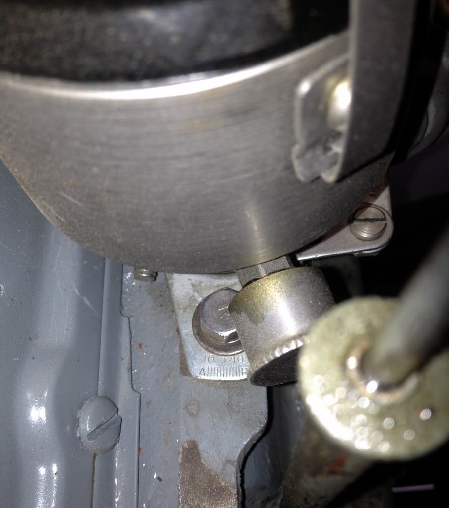

on the Internet for over 30 years! and not clogged down with Ads! Again, thanks! | | | | Joined: Mar 2009 Posts: 75 'Bolter | | 'Bolter Joined: Mar 2009 Posts: 75 | After running flawlessly for about a year-and-a-half, I took my '40 to a Curse-in (Portland) and barely made it home. With a little investigation I noticed my distributor rotates freely, even with clamp fully tightened. Any ideas on what to look for would be welcomed wholeheartedly.

Doug | | | | | Joined: Mar 2002 Posts: 9,115 'Bolter | | 'Bolter Joined: Mar 2002 Posts: 9,115 | If the bolt has come out of the fine adjustment plate on the bottom, it can be rotated about 15 degrees. | | | | | Joined: Nov 2006 Posts: 2,544 Shop Shark | | Shop Shark Joined: Nov 2006 Posts: 2,544 | The vacuum advance moves the distributor so some movement is normal. How much is yours moving? | | | | | Joined: Mar 2009 Posts: 75 'Bolter | | 'Bolter Joined: Mar 2009 Posts: 75 | With Truckernix comment about the missing bolt (thanks) I looked around for other fasteners and there is a collar with a horizontal screw around the right side of the distributor. That was loose also and when tightened, the distributor rotates only as far as the vacuum advance will permit - this seems correct. I took a picture of it here: ( https://plus.google.com/photos/1139...7801054018&oid=113956755236860259179) Now that I know how to tighten it down, I will adjust the timing. Q: Would you recommend I use the timing light from a top view (under the hood) or do I have to go underneath the front bumper and see it from below? thanks | | | | | Joined: Aug 2012 Posts: 1,214 Shop Shark | | Shop Shark Joined: Aug 2012 Posts: 1,214 | You should be able to see the hole and marks from above.That'll make adjustment alot easier. Make sure your octane setting is at "0", then loosen that nut/screw you just tightened to adjust you're timing. You may want to advance it a hair or 2 above the pointer and then road test to make sure it doesn't ping on exceleration. If it does retard it a hair & test again. btw, nice truck. | | | | | Joined: Mar 2002 Posts: 9,115 'Bolter | | 'Bolter Joined: Mar 2002 Posts: 9,115 | I belive below the pointer gives you advance. That shows that it fires before or in advance of the pointer position. | | | | | Joined: Mar 2009 Posts: 75 'Bolter | | 'Bolter Joined: Mar 2009 Posts: 75 | I am feeling a bit thick-headed because I've heard a lot about "setting the octane level to zero" but for the life of me cannot find anything around my distributor that has an adjustment with any graduations (numbers) on it. Even the "http://chevy.oldcarmanualproject.com/chevyowner/52tom31.htm" has an entry about octane adjustment but in the old b&w halftone print, I still can not see that specific parts are being referred to. Has my octane adjustment gauge fallen off? Is it too gunky to see? Did I ever have one? .... I'm not sure because I'm not quite sure what to look for. Can any of you kind people take a look at my distributor and let me know if I am missing something? https://plus.google.com/photos/1139...2597156306&oid=113956755236860259179Thanks for any help you can provide :-) Doug | | | | | Joined: May 2001 Posts: 7,438 Extreme Gabster | | Extreme Gabster Joined: May 2001 Posts: 7,438 | It is the flat plate with a bolt through it between the dipstick and the distributor. There should be graduations marked on the aft end of it. There is a line on the engine block under it for reference. | | | | | Joined: Jan 2010 Posts: 4,263 Shop Shark | | Shop Shark Joined: Jan 2010 Posts: 4,263 | ...click... To the left is an A To the right is an R | | | | | Joined: Mar 2009 Posts: 75 'Bolter | | 'Bolter Joined: Mar 2009 Posts: 75 | Thanks Cletis, Tclederman, and DADS50 for clearing that up! I am going to go home and set the timing!

John | | | | | Joined: Oct 2006 Posts: 1,847 'Bolter | | 'Bolter Joined: Oct 2006 Posts: 1,847 | do you know where to check the timing? Do you know about the BB in the flywheel, and the pointer in the bellhousing? I only ask because you were wondering if you should check from under the front bumper. That shouldn't even be a question. The octane selector can be anywhere as long as it is tight. Unless the gas in your area tends to vary widely in octane levels ( I have never used it in 30 years) The screw you found loose is what is used to set the timing. Some people say to set the timing with a vacuum gauge, I have always used the prescribed "ball and pointer" method, but last week I decided to give the vacuum method a try, I found absolutely no difference in performance. | | | | | Joined: Dec 2001 Posts: 1,248 'Bolter | | 'Bolter Joined: Dec 2001 Posts: 1,248 | Usually the timing was set with a slight ping on an uphill pull.
