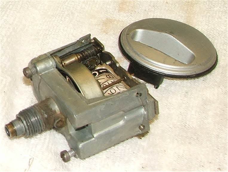

I pulled the speedometer in my truck today because the needle was missing and I wanted to see if the cable worked. The speedometer was stamped from the factory May 7, 1954 on the back.
I went for a drive without the speedometer and the cable did not move / rotate. I presume it is broken somewhere along the line. Does one purchase a new speedometer cable with the sheathing or can the interior cable simply be replaced?
I did not pull the cable at the transmission yet, frankly because I thought transmission fluid might leak.
Ritchie's 54 speedometer
I need to figure out if I can just add a needle once I fix the cable.

You can just pull out the cable, however if is broke, might be better to pull the entire cable. Plus if is that old, it's possible the inside of the sheathing might be damaged or rusty. Good practice to lubricate the new cable. I don't believe they are that expensive.

So really best to just buy an entire new cable with sheathing? Does the cable end just slide into a similar square receiver in the transmission?

I replaced my vinyl covered cable with the correct metal covered cable when I lubed and refaced the speedo in my '54. I hear mixed reports on lubing a new cable. I didn't lube mine.
> My speedo cable post
By the way. If you also have the oil and temp gauges out, I recently learned that '54 trucks had the speedo cable, oil pressure tube, and temp tube in a 3-hole grommet in the firewall. The choke and throttle were in a two hole grommet. Don't know if anyone has found a source for the two hole grommet. A speedo grommet from most suppliers can probably be drilled to make a 3-hole grommet.

Your cable may have pulled out of the tranny. If so, it may be OK.
Easy test to see if your speedo works. While you have it out, use your fingers to spin the brass bushing on the back of the speedo where the cable enters. You should be able to spin enough to make the needle move a little if the speedo is working. (I forgot which way to spin it. If one way doesn't work, then spin the other way!)
> Spin the brass bushing
Note the little brass cap at the base of the threads. Read about removing it and lubing the speedo in ...
> Jeff Erickson's Tech Tip

I can spin it but it feels a little tight. Maybe I should apply a drop of oil and let it sit overnight.
Unfortunately the needle is broken and I can't find a similar replacement in any of the sources I have: chevsofthe40s, American Classic Truck Parts, Brothers nor Truck Shop in California. This looks to be a very unique needle and I'm not sure how to remove it. It seems to have snapped off the hub somehow.

I pulled the speedometer from the transmission and found the following, which looks like a stretched pigtail. What am I looking at?
Transmission end of speedometer cable
Does the connection at the transmission look as it should?
Transmission connection

You need a new cable. Looks like the metal sleeve is coming apart at the end. transmission end looks ok. When you replace it, save an end of the cable (about 1 foot) as it makes a good test cable to tell if the speedometer is working. Just push it in an twist it.
New one should look similar to this..
pic

Continuing the saga of repairing my speedometer. How does one remove the plastic gear in the speedometer housing behind the magnet? I tried the tech tips and other topics but can't quite determine how to remove that plastic gear. It has a round cap on the outside that might be the answer but there is no obvious way to remove that cap.
Plastic gear in speedometer
Apparent end cap for plastic gear removal?
That gear appears to be stuck and I presume should rotate freely.
