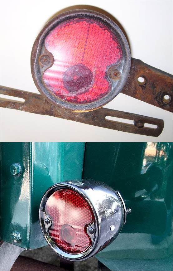

The lens screws on my reproduction '54 tail lights are 2-9/16" center-to-center. The reproduction '54 lights look like the originals.
> TOP: Original '54; BOTTOM: Reproduction '54

The plastic lenses on the '54 reproductions have the correct "GUIDE R-T8" at the bottom, "Guidex" in script at the top, and have ripples molded into the plastic. (Purpose unknown.) You can see it in the orignal/reproduction photo above and in the illustration in the 1954 Accessories Installation Manual.

Looking at photos, but no first hand knowledge -- the lens screws on the '55(2nd) lights appear to be closer to the edge of the lens and maybe nearer to the horizontal center line. Both would cause them to be farther apart than the screws on a '54 light. I don't have measurments. Also, the lens is different.
