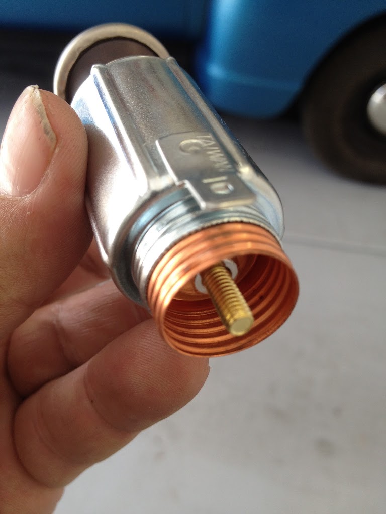

I purchased one of these repo lighters
....pic....
I will only be using it to charge the phone.
Should I fuse protect the hot side?
Plan to grab power off the ignition terminal that's always hot
If a fuse is recommended, what size?
Thanks

Is there a special terminal for the back of the lighter?
The terminals I have on hand have to be bent back because of the deep well as you can see in the pic,
then I can't get my socket in to tightened..
I know this must be easy, Must be obvious I'm just not seeing it.

yeah, poor design, can't think of any terminal that would work there - you could wind a couple turns on the end of the wire [bare], solder that well to make a fat loop and use a brass washer between that and the nut .... but I think I'd cut a piece of copper tube that fit snug on the post and nut it on so there's just enough thread left for a crimp terminal, star washer and another nut [all brass hardware] .... I'm from the creative school of electricians grin

The lighter base you have is a standard replacement for any car/truck.
You need the following connector which was made for this type hook up (threaded screw). It just pushes on and will not fall off. It is insulated and is the eaisest connector I have ever used.
It is AIRTEX Part # 1P1063
You can get it from O'Reilly Auto Parts

Thanks. That is good info.
That terminal on the back is a pain. They should sell the boot with it.
