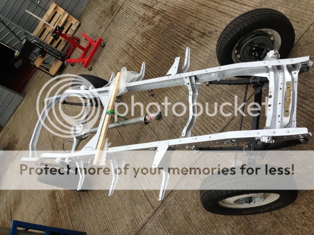

ive spent out on everything getting the frame and running gear sorted! its all new / reworked..only thing i couldnt do was straighten the springs...
http://i995.photobucket.com/albums/af75/hootschc/truckframe_zpsc9ae3c66.jpg

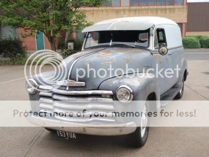

here is what the old girl looks like;-
http://i995.photobucket.com/albums/af75/hootschc/261961_2028079136069_5122192_n_zps010229da.jpg
http://i995.photobucket.com/albums/af75/hootschc/208703_10150507433470231_1929100_n_zps381099e0.jpg
http://i995.photobucket.com/albums/af75/hootschc/148262_1672202559377_7771533_n_zps7beeddc9.jpg
http://i995.photobucket.com/albums/af75/hootschc/259881_2028066815761_6747438_n_zpsdce76e76.jpg
1953..panel truck.I love my truck!...
