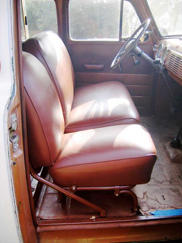

Question. What was the floor mat for the Suburban? Was it the same as the truck or did it have a section under the jump seat? Also, does anyone have a picture of the floor pan section under the jump seat area that they could send me or direct me to? Some P.O. has put a panel over the original floor in that area, or at least it looks that way, I'm not really sure what it is supposed to look like. Thanks,
Coffeeman
The front mat from the pickup fits my '54. The remains of a ribbed mat was under the jump seat when I got it. I have not been able to determine if it was original.

The floor panel you are talking about could be original. They welded in a plate to cover the indentation of the floor so they could mount the flip seat and brackets. . The floor pan is the same used in the pickup trucks with some modifications to fit the rear flooring. The matting used was similar to what Cletis posted, but I can't tell by his picture that it's original or not, I believe that the suburban and truck models used black material and his looks like it's faded brown.

Ahh, G, that makes sense as it is spot welded in. It just isn't cut very well like you would expect a factory plate to be. I will be finished cleaning it up hopefully today and post a better pic of it. Any idea where to get the matting that goes in that area? Thanks-

Yep, that's exactly what mine looks like. Thanks for the help!

You will notice that there are two raised pins at the rear of the seat area close to the rear floor. These are for attaching the mat so it will not move around.
I think my under seat mat was black to start with even though it doesn't look like it in the picture.

After scraping and grinding, I have uncovered the ugly truth. the spot where the back bar of the seat rests on the floor is ripped. I think what I am going to do is dolly it back into shape, weld it shut and then cut a piece of 20 ga. to fit between the factory piece and the rear floor step-up. It wont be original, but I'm not really going for the 100 point restoration. The factory piece looks unfinished anyway so this should make it look better, IMO.
