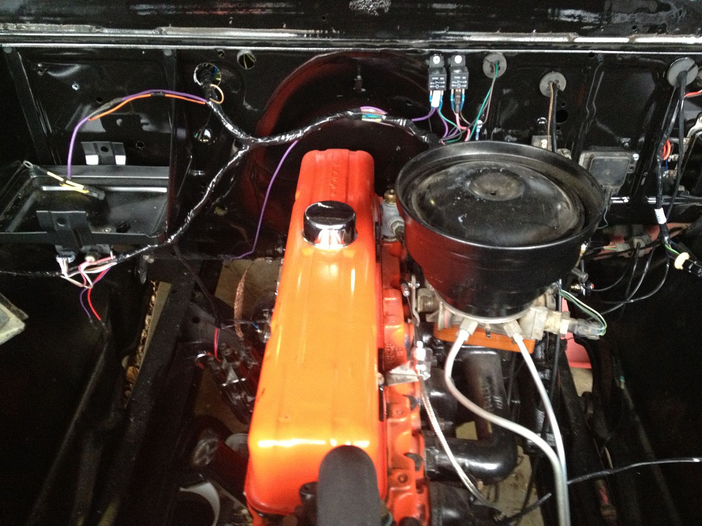

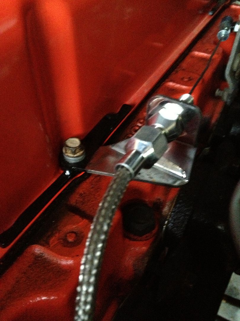

Okay, here are a couple shots of where I am at so far. Things are getting close.
Fuel pump, lines, and filters:
[IMG]http://i1130.photobucket.com/albums...1-13112-000012BF18F4253B_zpsd709ea3d.jpg[/IMG]
Engine bay, wiring harness, tbi, etc:
[IMG]http://i1130.photobucket.com/albums/m537/kjhibbs99/Apache%20Rebuild/IMG_2632_zpsd7169119.jpg[/IMG]
The timing is set, so that's good to go. I need to get the down pipe in so I can hook up the O2 sensor. My K&N air filter should be here soon, and my battery is charged. Add a few other odds and ends and I should be able to fire it up soon, hypothetically at least.

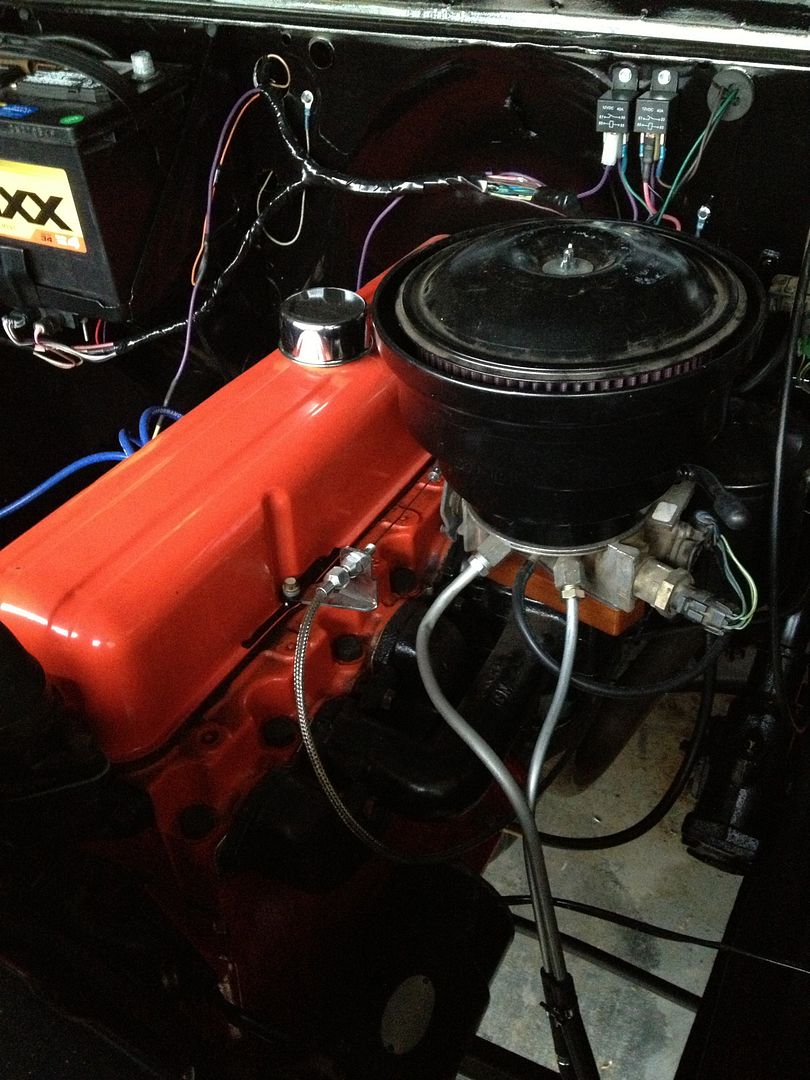

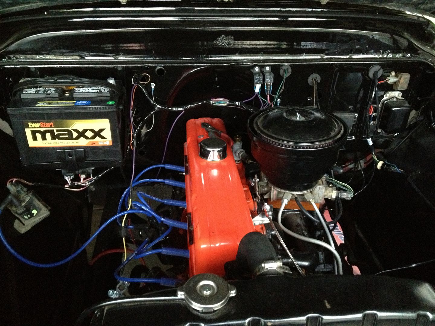

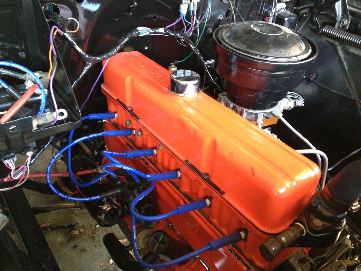

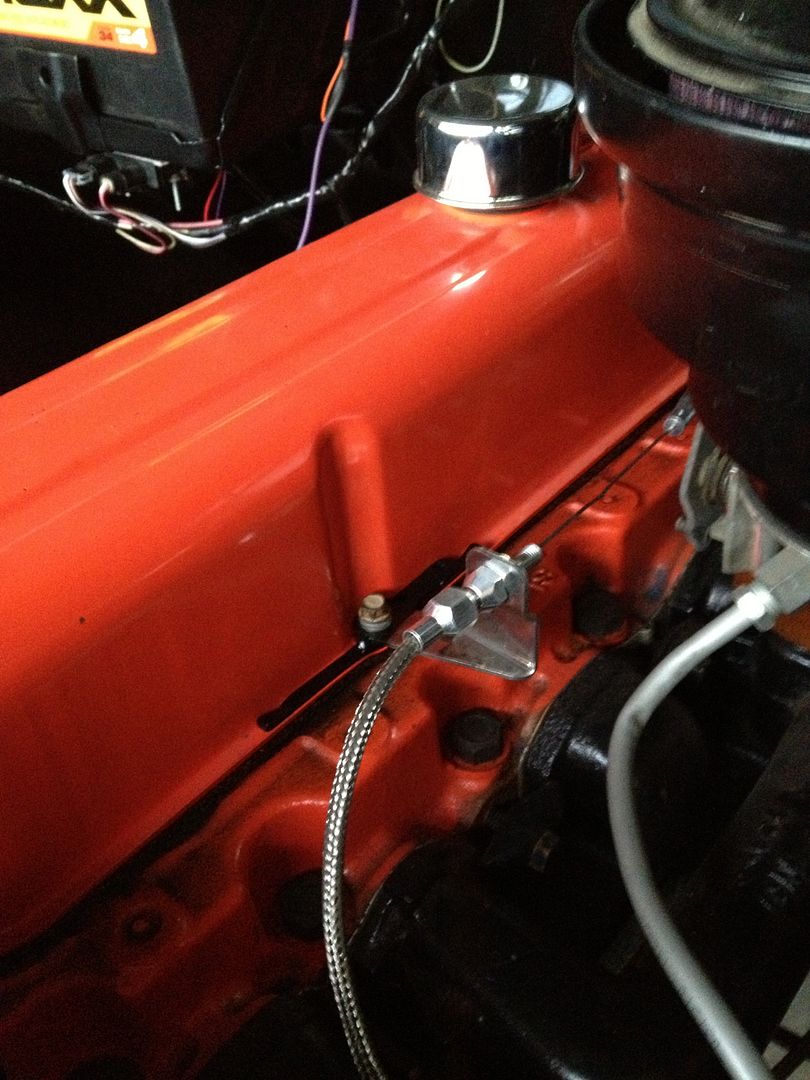

Big day yesterday, I got it fired up! Now I need to explain that the install is not totally done. The timing was set before it was started, but not after, so I need to adjust for that. The MAP sensor needs to be connected, as does the SES light, and VSS. I need to adjust the idle and the TPS. But by golly, it runs! Check it out:
I must admit, I was so excited I drove it around the block. You may notice that there are no seats in the cab in the video, so I just set one in there to sit on. Not the safest, I know, but I was going like 5 miles per hour and there was no one around. Oh, and I had no brakes. I won't be going out again until I knock those out, but it was pretty fun. I hadn't driven it in 1.5 years. Anyways, here are some pics:

Turns out the starter needed a new armature, so I have an electric motor shop working on that and a rebuild while they are at it. My seat is bolted down and my new master cylinder is installed and the brakes are bled. I have even finished installing my door glass and weatherstripping.
Once the starter is done I will be able to drive it around, although I will have a few odds and ends to work out.
My list:
headliner molding (any tricks for this?)
hood to cowl seal (tricks for this?)
engine timing
build a flatbed
wheels and tires
passenger seat bracket
and a few other things
Getting very close. I will upload some pictures soon.

Joined: Jul 2011
Posts: 114
Joined: Jul 2011
Posts: 114
1959 Chevy Apache 3600
My rebuild album, including my reference shots:
http://s1130.photobucket.com/albums/m537/kjhibbs99/Apache%20Rebuild/
kjhibbs #939107 04/27/2013 10:06 PM
Joined: Jan 2012
Posts: 43
Joined: Jan 2012
Posts: 43
Looking good.
Joined: Jul 2011
Posts: 114
Joined: Jul 2011
Posts: 114
Okay, has been on for awhile and is doing well. Runs well, engine is timed. Idles smoothly and is quite responsive, I am very happy with it.
