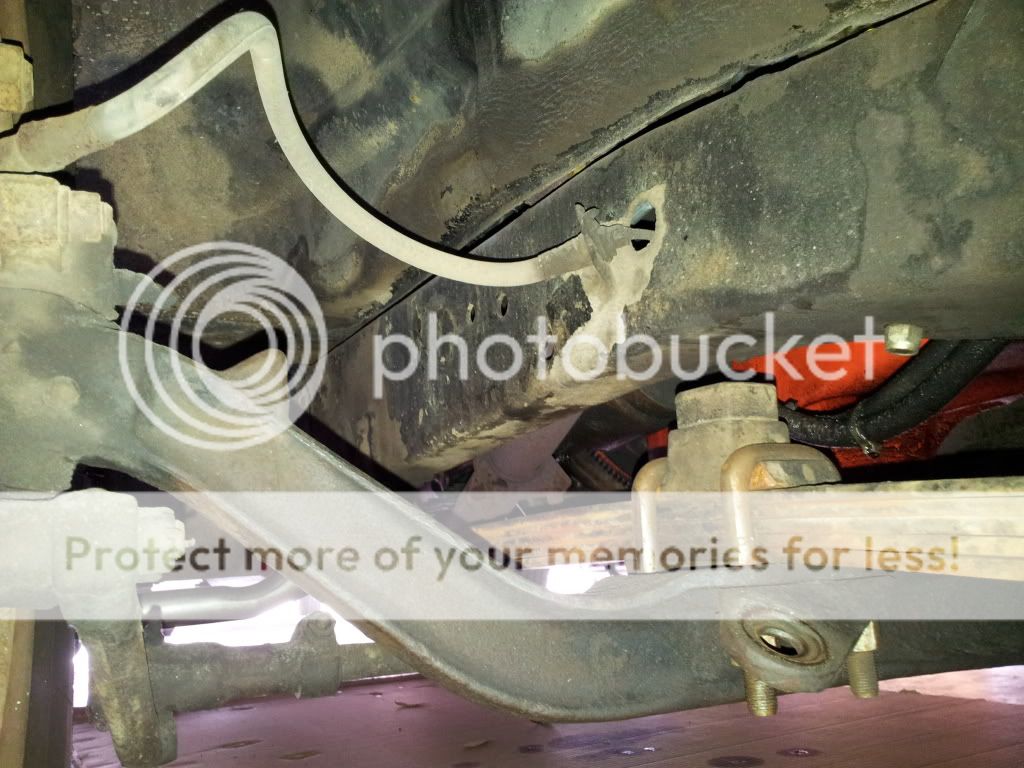

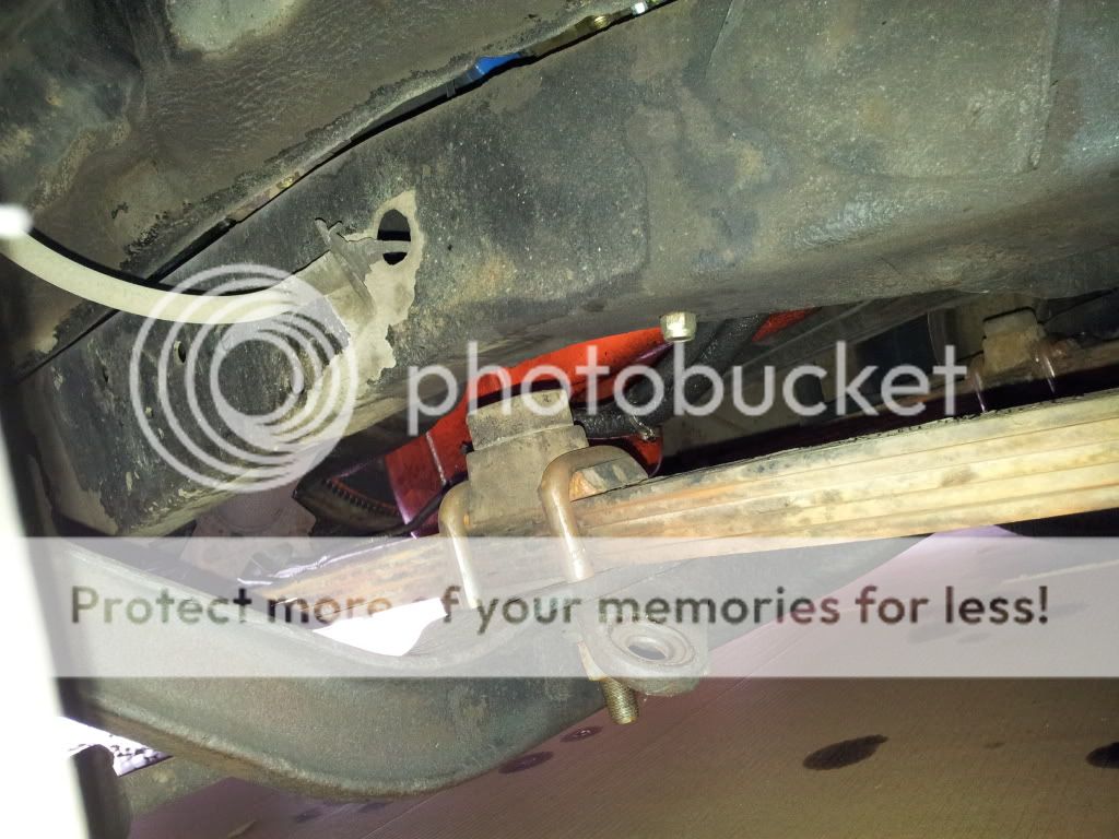

Ok here with some pics of my front end bumpstop area.

Find a photo upload site and you can get the link from there to post here. It sounds like you just to low without enough support. Maybe doing a 4" instead of a 6" in the front? What kind of shock are you running in the front?

Looks like dropping the front end has exceeded the engineering ability of the stock setup.
Dropped axle combined with new springs are the ticket to restoring the spring action.

1. I would not recommend trying to get your springs re-arched. If they are original and have been de-arched already, they won't have enough life left in them to hold up after being reheated and rebent. It also looks like someone removed several leaves from your spring pack if they are original. They just don't have enough meat in them to hold up your truck. I recommend getting some new springs that are either OEM type replacements or aftermarket springs that are specifically designed to support the weight and performance of your truck.

by the looks of your pics, 1. you need a new set of springs, and they should be 7 leafs, 2. if you want to keep it low, i would suggest a 3in. drop axle, and definitely please put some shocks on the front before you hurt someone or yourself,
