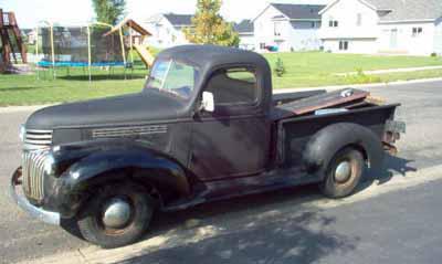

          This is my 1946 Chevy DP 3100 1/2-ton stock pickup. It is my second "Art Deco." After owning a 1941 for six years and never getting a chance to drive it, lack of money forced me to sell. Some 14 years later, I decided another truck was a necessity.
          I had been watching the ads for years just to see what was out there. I came across my truck on a national car sales web site. The owner emailed me the details on the truck in mid-July. I thought the price was way too high. My wife went with me to look at several trucks in the fall. After deciding all were too far gone for the money, I contacted the owner to see if he still had this truck. We loaded the family in the car and drove the two hours to see it.
          This truck came from northern North Dakota and had spent its life as a farm truck. At some point, it was owned by a county sheriff and a college student. In the mid-70's, it migrated to Minnesota. The new owner kept it in a barn. The truck was driven less and less and finally, in the mid-80's, it was not touched at all.
          When the owner died, the truck was passed on to one of his sons. He knew the truck was in good shape, but did not have the truck bug. He posted the truck on the web site. Minnesota trucks are known for being rust buckets. This truck was the most complete, rust-free old truck I had ever seen.
          The price was high. We added up the cost of all the good parts on this truck and figured out we were probably spending far less than if we bought a basket case. The truck came home in November of 2003. After removing four 5-gallon buckets of dirt and grease and installing a new brake and fuel systems, the truck was driveable!
          The project is still IN PROGRESS -- hence my Stovebolt name, 46 In Progress.
