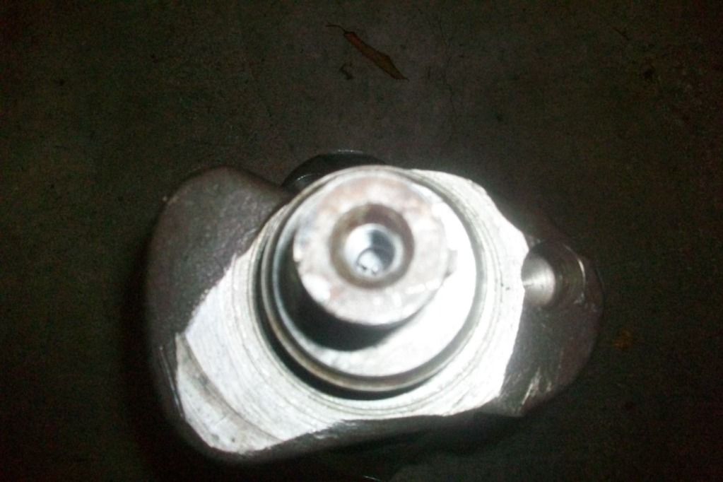

misfits #900584 12/01/2012 11:16 PM
Posts: 9
1
1 Offline
Posts: 9
http://i1076.photobucket.com/albums/w451/1946chevy1/102_3287.jpg
235 full pressure crank, drilled for harmonic balancer bolt.
We can do this for the 216 too.
