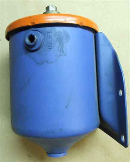

Can youost a pic of your filter housing?

Not sure how to go about posting a pic. It is the factory filter housing bolted to the exhaust manifold with u bolts, Lid on top with bolt in the center, inlet hose on the side towards the top and it appears where the outlet hose coming out of the bottom of the filter housing just has a bolt in it to cap it off. If the oil pump went out did somoene just cap off the outlet and essentially make it a none pressurised oil system like in previous years? I was planning on getting a new oil pump and re-plumbing the filter housing, i was just curious if anyone had seen someone with this kind of setup before.
[Linked Image from i1188.photobucket.com]
That cob-job set-up might have resulted from a leaking outflow hose being replaced with a plug in the base of the canister and a plug in the return hole it the block.
This should not hurt anything but it is not filtering oil.
A guess: the outlet fitting in the block is plugged. Take it off and clean out the fitting and check to see if "gunk" is plugging the hole in the block.

Sounds like a good place to start. Here is a pic of the type filter housing on it.
http://www.stovebolt.com/techtips/engines/oil%20filters/31.jpg
Joined: Aug 2011
Posts: 687
Joined: Aug 2011
Posts: 687
I agree with Tim. Check the outlet fitting on the side of the block. It's under the carb and bit to the firewall side. OR your oil gauge line is kinked?
The outlet is on the bottom of your canister and returns to the carb side of the block.
