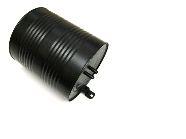

Bigger is always better on vacuum lines- - - -that's why the big trucks with the Hydrovac used 1/2" hoses from the manifold to the reservoir tank. If you've got an option when installing a new system, use 5/16" hoses and hard lines, and hide a small reserve tank with a one-way check valve somewhere out of sight. It might not be OEM, but it will make the wipers and other vacuum-operated accessories work much better. The softball-sized round plastic vacuum reservoirs from a newer car will mount somewhere out of sight down in a fender well, etc. and won't detract from the antique appearance.

Per Jerry's suggestion, I'm mounting a vacuum reservoir tank under the cab and using a brass 1/4" MNPT fitting to a flared 1/4" ID copper line. I'm using an Erson tank which is a bit bigger than a softball but I recently found these 1980-82 Corvette headlamp tanks. They look like tin cans so they blend in with the antique look a bit better.

Mine will get tucked up in a frame rail or hidden somewhere. ...the difference is, I got it for $20 with a gauge and all the fittings where as the Vette tank is +/-$60 depending on where you find it.
That said, I might get the vette tank just for the look and sell mine.

Those tin can tanks were original equipment on a lot of 60's and 70's GM vehicles, so a salvage yard search might turn one up on vehicles of those vintages. I think a wrecking yard would just about give one away.
