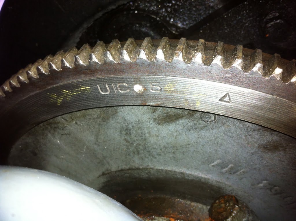

its a 235 off a 58-62 where are the timing marks located?
1950 Chevy 3600
Window above the starter
...pic...
Marks on fly wheel
...pic...
...video...
Good luck
