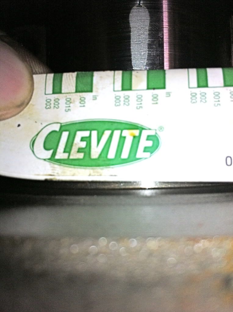

So I got some plasti gauge and here are the results for the rear main. I left the shims in, I think I'm ok, can you concur?

Well your photos appear to show a bearing with the babbit worn down to the copper, right near the parting line. That might happen if you had a .002 undersize bearing fitted on a standard journal. That is why I asked what was stamped on the back of the bearing. Have you determined why the seal leaked?

Definitely do not remove the shims! If you choose to stay with the lip seal, you'll need to trim the shims to let the ends of the seals butt together, and maybe add a strip of shim stock behind the seal pieces in the block and the cap. A little brush-on sealer like Permatex Super 300 on the back side of the seal halves might be a good idea, also.
Or, you can use the rope seal. It's not uncommon to get a slight amount of seepage with the rope seal, so if a few drips on the garage floor upsets you, better make the lip seal work some way or another!

I would say the bearings were set up to tight to start with. With .001" now it must have been tighter to start with, .001' is the minimum you want, and that is with a align bored engine. I like .002" clearance.
I would also Plastigauge the rest of the bearings.

0.001" is still too tight, these engines like to be more like 0.004" or so.

That much clearance will guarantee a rear main seal leak, no matter what kind of seal is used- - - -the seal can't maintain contact with the crankshaft as it bounces around like a BB in a boxcar.
