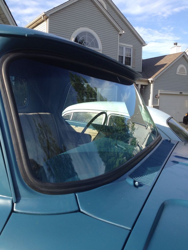

new windshield rubber installed- we used an OEM gasket and the fit is excellent!:
http://i1078.photobucket.com/albums/w497/slawnski/1964%20chevy%20c-10%20Montana/924d34d5.jpg
