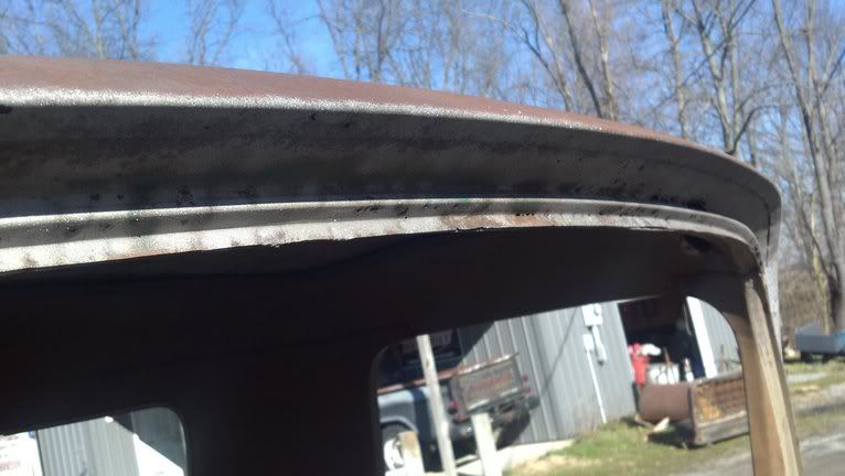

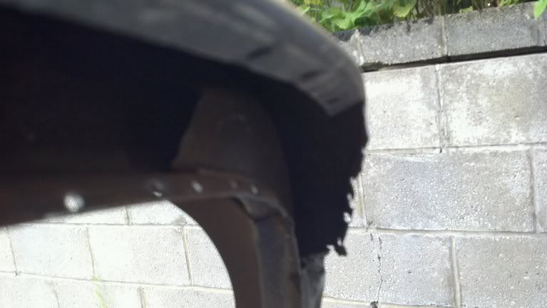

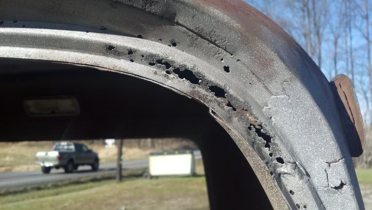

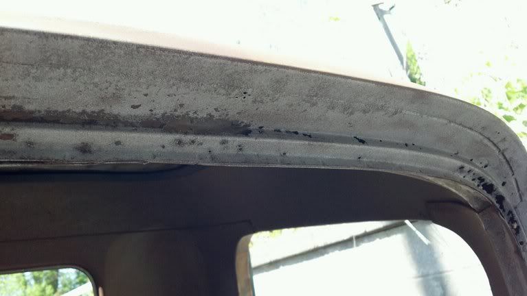

The area above my windshield is rotted out all the way across. Does anyone here have the required skills to make a repair panel? I'm really surprised that it's not a readily available repair panel.
[IMG]http://i236.photobucket.com/albums/...oject/photobucket-3540-1325944185638.jpg[/IMG]
[IMG]http://i236.photobucket.com/albums/...oject/photobucket-2101-1325944170311.jpg[/IMG]
I've thought of making little 4" pieces and working my way across, but I would really like to replace it in one piece if at all possible.

it's not a common enough job any supplier would bother to make a patch - I don't think anyone but you or someone else on hand could do anything about that complex shape and the particular damage

you could cut this section out of a good cab/roof and replace it on your truck. then you know the shape/curve is correct. I've seen whole roof panels on eBay, cut through the pillars.

Must use donor and in ONE piece or your window will never fit.

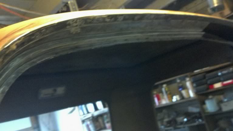

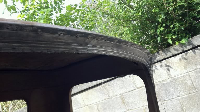

I have plenty of welding experience & equipment, but very little skill with sheet metal shaping. The reason I find it surprising that no one offers the panel commercially is 1)In this part of the country, that spot is one of the first to see rust holes. 2)Inner and outer roof panels are produced and easily available. I couldn't imagine replacing the two roof panels and trying to "reuse" this little panel.
Same panel is also junk on the parts truck.

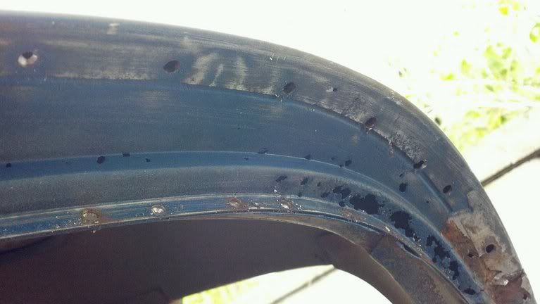

I got the panel from MPandC and I can tell you guys, It's quite a piece of work. Thought I'd snap some pics and include you on the install.
Here is what I started with.
[IMG]http://i236.photobucket.com/albums/...ject/photobucket-25461-1336605007780.jpg[/IMG]
And I cut away a rotten area inside the cab. I was alittle worried that this might cause the piece down close to the windshield would get really wiggley while I was working. Access to the inside was nice though.
[IMG]http://i236.photobucket.com/albums/...ject/photobucket-27958-1336605040415.jpg[/IMG]
1959 Shortbed stepside 1/2 ton project

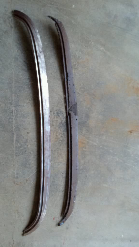

First off I dusted alittle paint over the spot welds and when dry, I scuffed it off with some 80 grit. Makes the spot welds show up better. Hit then all with an 1/8 bit and then followed up alittle bigger.
[IMG]http://i236.photobucket.com/albums/...ject/photobucket-24692-1336605060495.jpg[/IMG]

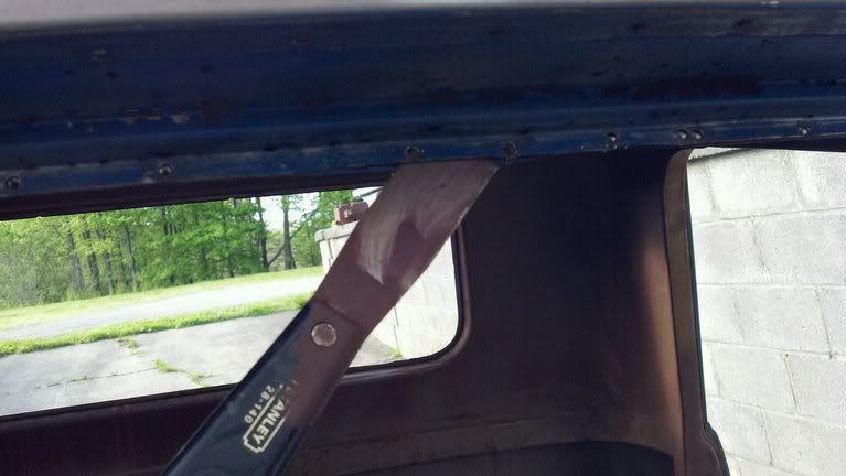

I thought the welds along the windshield edge would be the tough ones. I was wrong, broke most of them loose with a putty knife.
[IMG]http://i236.photobucket.com/albums/...ject/photobucket-32047-1336605075281.jpg[/IMG]
[Linked Image from i236.photobucket.com]
Joined: Dec 2011
Posts: 110
Joined: Dec 2011
Posts: 110
Turned out the welds along the roof edge were tougher. was able the separate with a putty knife and alittle help with a cut-off wheel.
[IMG]http://i236.photobucket.com/albums/...ject/photobucket-42944-1336605088436.jpg[/IMG]
Old panel next to the new one.
[IMG]http://i236.photobucket.com/albums/...ject/photobucket-26184-1336605120694.jpg[/IMG]

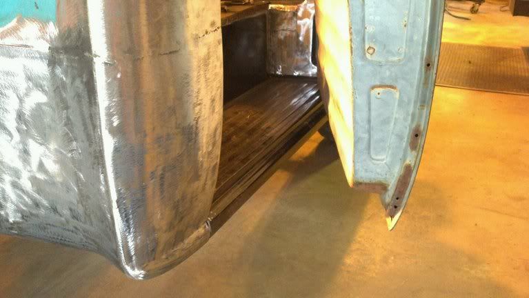

I got a chance to work on getting the new panel installed. First hurdle I ran into was just getting the panel in there. I had to open up the roof edge on the corners so I could roll the new panel in.
[IMG]http://i236.photobucket.com/albums/...ject/photobucket-27546-1338328664100.jpg[/IMG]
I also cut the panel in half to ease the work load and take the worry away of both corner being where they needed to be.
[IMG]http://i236.photobucket.com/albums/...oject/photobucket-8989-1338318805538.jpg[/IMG]
Worked out GREAT! About two days of fitting and 15 minutes of welding. Outer panel is all installed and I couldn't be happier with it. Huge thanks to MP&C
