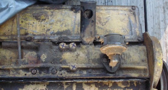

Yes, the 1957 261 was supposedly yellow.
Here is a yellow 1955-1st 261.
Here is another photo of that same yellow 1955-1st 261.
Those photos were provided by the late WD Foster. WD stated that he was certain that it was original paint - I'd believe such an assurance from very few people, Warren was one such person.

Looks like a Minneapolis Moline.

Looks to be a '54 - 55 1st design 261 by the water pump mounting & s/n location.

BC, Thanks for the correction (I've changed the post).

Thanks for posting the pictures that's the color I remember.
I think MM and Cub Cadet are both a little to orange. I think it looks closer to a faded John Deere yellow.

Looks to me to be about the same color as a Cat engine (ORIGIONAL PAINT) from that time period. My'55 2nd-series 261 still has plenty of evidence of its origional"Cat-Yellow" (Close enough 4 me),even though it's got 3-4 layers of Chevy orange over the last 57-years. I was born in'57,and now I'm 55,and my truck was "born" in '55,and "he" will turn 57:)
