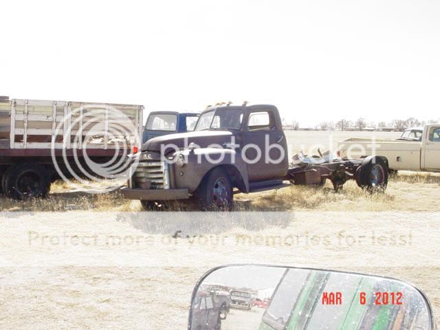

If you determine that the big bolt boards and brackets are the same, THIS TRUCK has a really nice set. Let me know and I will give you contact info for the yard they are located in.

Big Bolt running boards are NOT the same as boards for a flat bed little truck.
