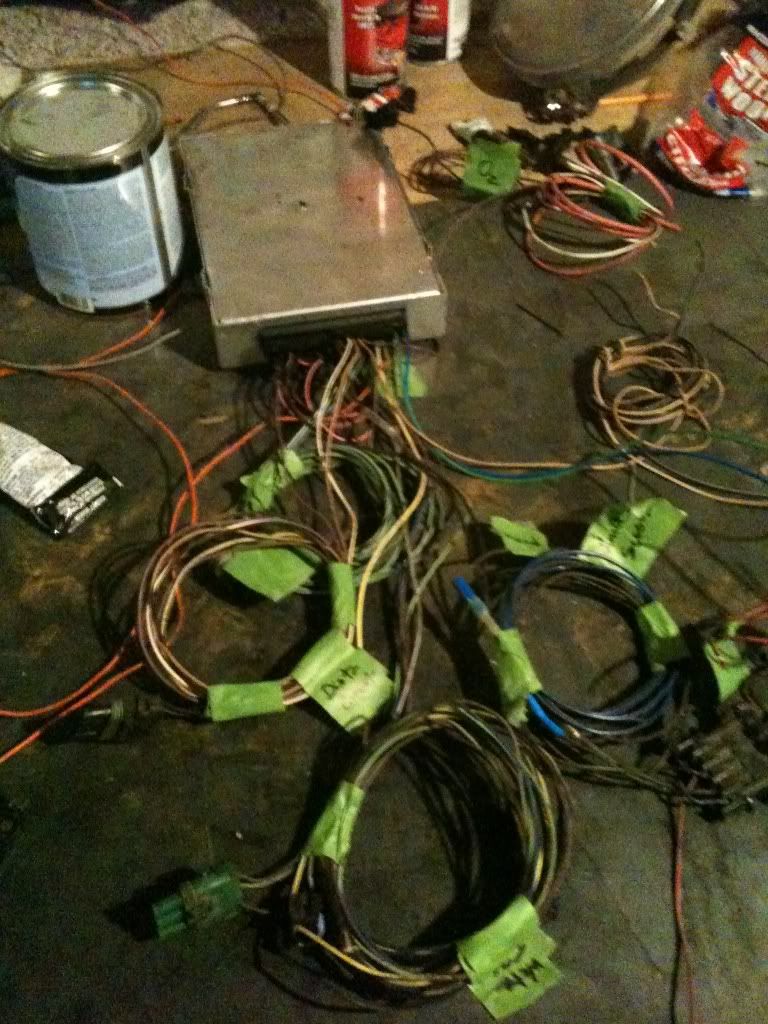

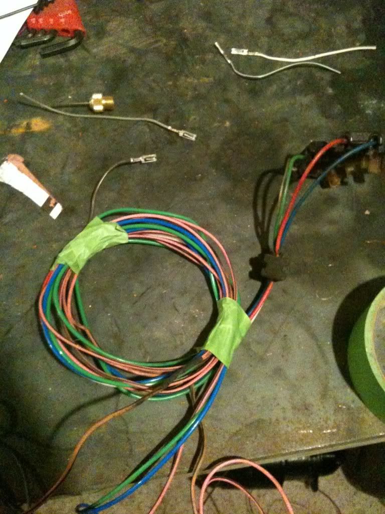

Good news, I got down to the junkyard just within the 30 days allowed for an exchange of my TBI unit, and I grabbed a nice one from a 1992 4.3l, so that is good. The drawback is that the 4.3l TBI routes the fuel lines out the back of the TBI which interferes with the oil filter that mounts to the intake manifold. I will snap some pics when I get a chance, but my thought at this point, and I am open to other suggestions, is to weld some studs to the firewall and just mount the oil filter housing there.
I also starting chopping away at the wiring harness. With all of the info out there it really has not been too difficult. The one thing I wish I had done was releas the individual wire clips from the ECM harness rather than cutting them off. I was a little rambunctious initially and cut a few that did not need cut. They are easily fixed, but would have been easier to have just pulled them in the beginning.

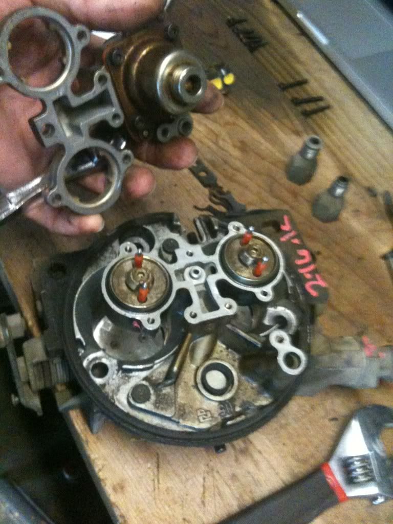

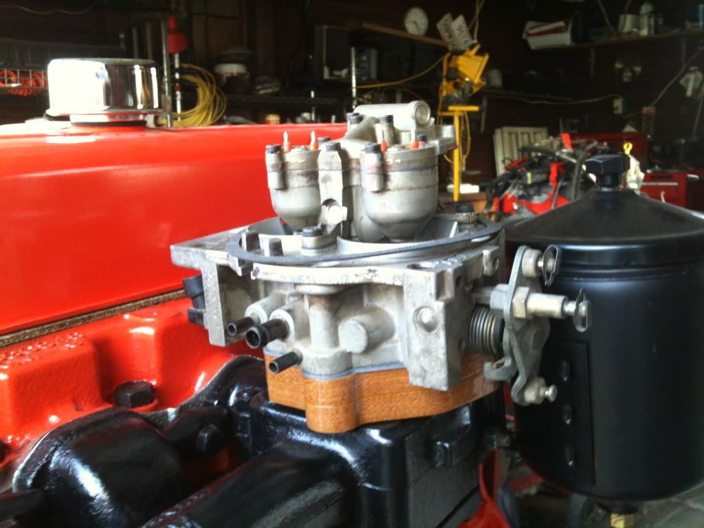

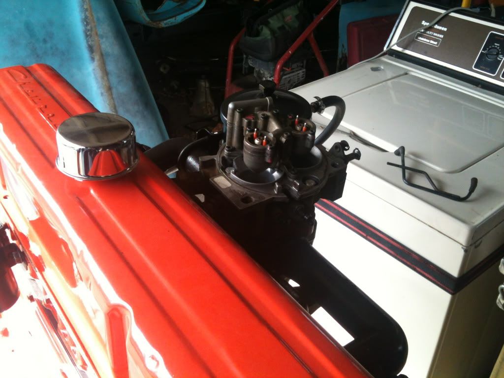

Finally made a little progress on the TBI this weekend. I rebuilt the unit, which was very straightforward.
http://i1130.photobucket.com/albums/m537/kjhibbs99/Apache%20Rebuild/847bb4b5.jpg

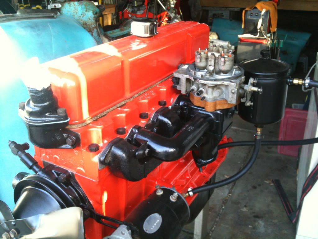

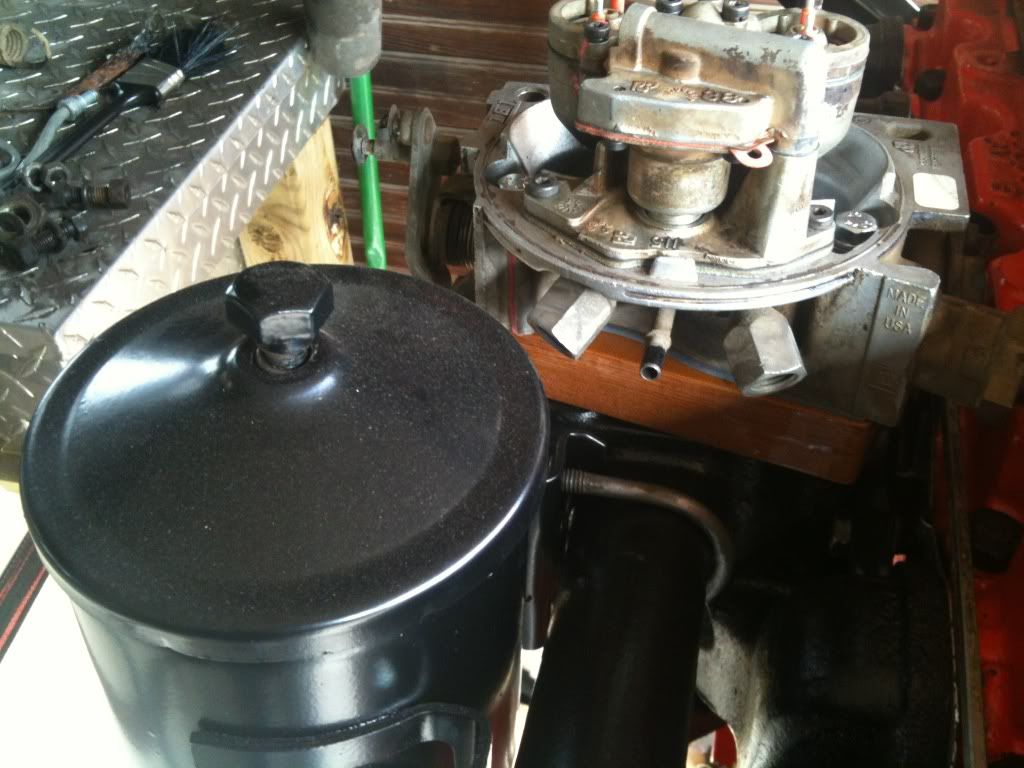

And then I mounted it onto the engine. I tried to get a good shot of it, but all my angles were pretty rough. Oh well, I will take a better one later. Here is what I took today.
http://i1130.photobucket.com/albums/m537/kjhibbs99/Apache%20Rebuild/a89db874.jpg
Note on the second picture how one of the fuel lines is going to interfere with the stock oil filter housing. My plan at this point is to weld some studs onto the firewall and mount the oil filter there.
http://i1130.photobucket.com/albums/m537/kjhibbs99/Apache%20Rebuild/3ec85a38.jpg

That looks very nice. Do you have a pic of the TBI and the adapter in place?

Kevin,
It looks like your injectors are installed 90* out.
The pins should line up across the TBI.
If you remove them you will see a very small roll pin on the bottom of each injector. That pin lines up with a small recess cast into the inside of the injector pod. I recommend installing the lower oring into the injector pod and not on the bottom of the injector. Then use some light grease or oil to lube the injector prior to install. That will help keep the oring from pinching or rolling.
I would also recommend checking the throttle shaft for play.
They can get worn and if there is too much play it may cause an unstable idle due to a vacuum leak.
I couldn't tell from the pics but if you have a flat throttle position sensor then there are felt dust seals that go on each end of the throttle shaft.They are under the pressed on caps.
Sorry the pics above are so bad, I will take a picture in better light.
Bill, I will double check the TPS to see which one I have. I did line up the pins on the bottom of the injectors (or at least I intended to), but I will double check to make sure I did not totally miss something.
I just double checked and see where I went wrong...

Bill, thanks for catching the injectors being off, I fixed that real quick this morning. Here is a picture of the TPS, I am not sure which one I have per your description. I replaced one felt seal behind it during the rebuild and the shaft seems solid.
http://i1130.photobucket.com/albums/m537/kjhibbs99/Apache%20Rebuild/025612ac.jpg
And here are some better pics of the TBI and adapter set up:
http://i1130.photobucket.com/albums/m537/kjhibbs99/Apache%20Rebuild/b12faa80.jpg
http://i1130.photobucket.com/albums/m537/kjhibbs99/Apache%20Rebuild/7be66e5e.jpg

You have the 92 and up TBI with the round TPS connector.
The injectors look better! :-)

Been working hard on the harness today, it was good to make some significant progress today. Here are a couple shots of the process. Pretty much all I have left is the 2 relays and some odds and ends.
http://i1130.photobucket.com/albums/m537/kjhibbs99/Apache%20Rebuild/52a8fcf6.jpg
http://i1130.photobucket.com/albums/m537/kjhibbs99/Apache%20Rebuild/62fff0e9.jpg
Hey Bill, I am planning on running the knock sensor, and one of my sources says that the brown wire coming from the knock controller goes to D1 and a ground lug. However, in a diagram from binderplanet D1 also goes to the ALDL. I assume it is a ground circuit for the whole system, is that right?
Also, I have the relays that came from the donor, but they are both 4 pin, not the Bosch 5 pin style, are they usable or do I need to replace them?

Joined: Jan 2012
Posts: 43
Joined: Jan 2012
Posts: 43
Kevin,
I think your confusing the VSS-speed sensor with the Knock sensor/ESC.
The VSS has the brown wire and connects directly to the ECM at pin A10. The other wire goes to ground which on GM is blk/wht.
From the factory some also T off the brown to the ALDL connector but it is not needed since speed data is output thru the ALDL data stream when you log data or use a scanner.
The knock sensor connects to the ESC which is the little 3x3 black part. It hen sends the signal to the ECM pin B7 on a blk wire.
Any relay will work as long as it it connected properly.
All the ones i have seen have a little diagram on them so it doesn't really matter what the pin letter/number are. Just match the wire to the diagram.
There is a ground and 12V from a switched source that turns on the relay.
Then there is normally a batt 12v setting on one of the contacts and when the relay is on it passes that 12v to the output where you have the fuel pump or ECM or injectors or anything else connected.
There are several factory relay examples in the diagrams provided on binderplanet and in the wiring FAQ I give the standard Bosch connections also. Bosch can be 4 or 5 pin. They can have 2- 87 outputs or an 87 and a 87a. Each version is a little different so refer to the wiring FAQ.
So all bases are covered.

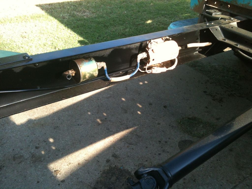

Not a ton of progress on the TBI side of things, but I did get the fuel pump mounted on the passenger frame rail:
http://i1130.photobucket.com/albums/m537/kjhibbs99/Apache%20Rebuild/08bfb043.jpg
I need to come up with a way to secure the fuel filter to the frame as well, I was thinking maybe a large hose clamp.

Looks like you hit the JY and grabbed the Ford F250 frame mounted E2000 pump and filter.
make sure you use a see thru filter like the fram G3 or the wix 33003 between the pump and the tank.
The factory metal filter is fine after the pump as a final filter if you want to keep it.
I use rubber lined adel clamps to secure to the frame to help isolate pump noise.
[img]http://www.binderplanet.com/photopost/watermark.php?file=15704&size=1[/img]
pump pic
