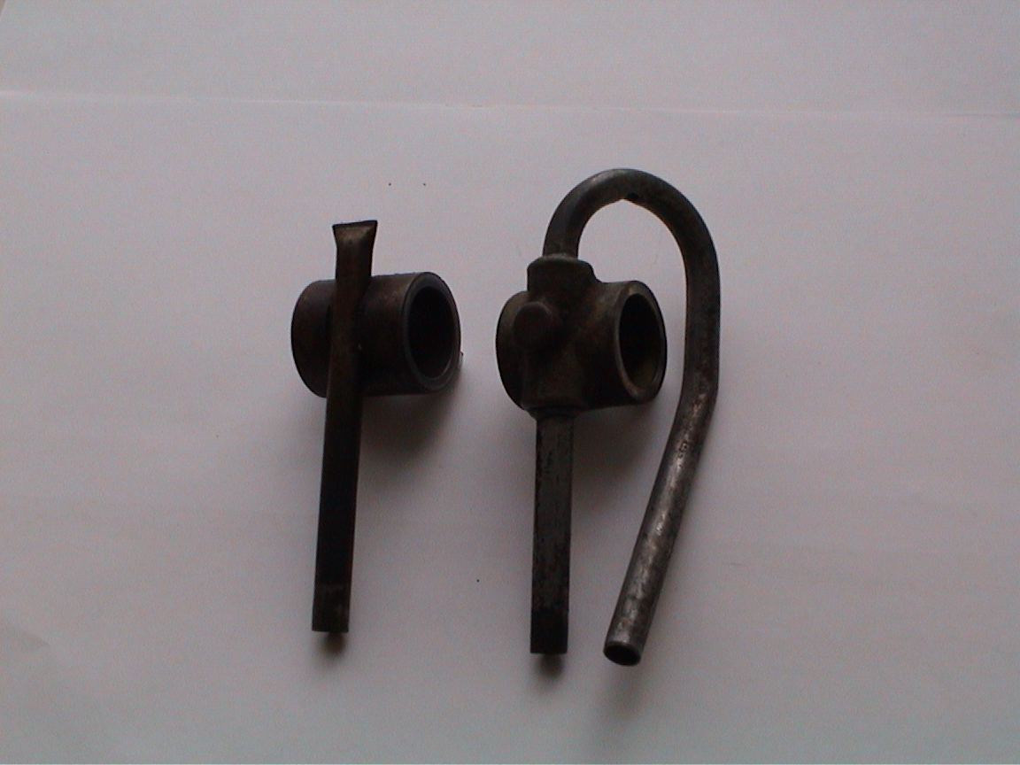

I've seen 2 types. I didn't make notes on where these came from (older 235, 235 "848"head or 261). Maybe some can better ID them.
Rocker Arm Oilers

Wally and Gus - Thanks for the pics.
> Wally - Mine looks pretty much like the one on the left in your picture. The one on the right kinda looks like the one in the diagram in the Shop Manual.
> Gus - Looks like yours feeds from the bottom. The video helped me see more than I could see when watching it in person.
Must have been a more than one style of oiler. I guess this is one worry that I can put aside!

The 1959 Shop Manual Supplement shows the crimped-off rocker arm oiler. Many of the earlier type (as shown in the 1954 manual) were crimped in an attempt to force more oil to the rocker arms.

1959 was the first year 235s had a pinched off connecter.
The one on the right in Wally's link is the right type used up through 1958, although there was a all steel design that started in about 1954.

Thanks for the info, the link, and the confirmation that my oiler is correct. I'm glad that it is not another task to add to my "gotta fix" list.
