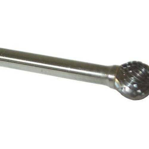

A rounded burr grinder is also a good method which should somewhat limit the damage to the (throwaway) panel to just slightly larger than that of a spot weld cutter. The downside is that these also come with little tiny slivers of metal that are a pain when you get them in your skin, so it would be advantageous to address these with a vacuum cleaner/foxtail and dust pan on occasion to keep the issue at bay. A pair of work gloves come in handy as well. Keep some duct tape handy to pull out the slivers that sneak by.
