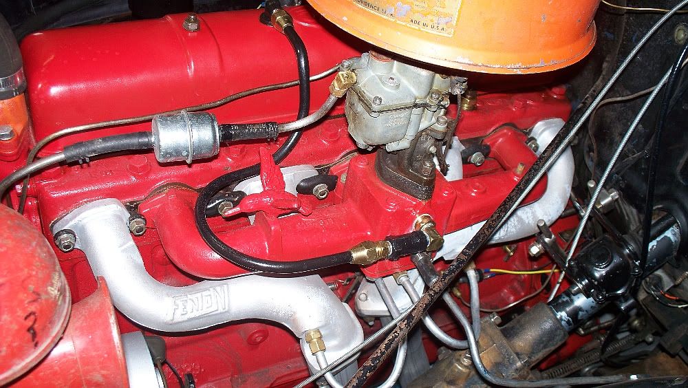

I would like to cap off the current breather tube and install a pcv valve in the tube. In addistion, i would also like to use a solid cap on the valve cover rather than a breather cap. Does anyone have any experience with this type of set up and know if this is sufficient ventilation for the motor. It looks like later model motors have a similar set up shown on pg 28 in the 1947-1954 factory assembly manual

The PCV is the exit.
Where is the entrance?

in picture #1 you'll see the original down draft tube. I cut off the part that goes down past the pan and welded a cap on it. I then cut a hole in the cap, intalled a rubber grommet and a pcv valve....from there, i ran a vaccum hose up to the firewall into a Jegs oil/air separator (picture #2)and out into in another foot or so of vacuum hose and into the intake manifold where you pull vaccum off for various items i no longer use. Picture #3 shows the cap on the valve cover instead of a breather cap and picture #4 shows a similar set up from the assembly manual. Any pressure in the pan is getting sucked by vacuum throught he PCV valve and back into the manifold.

Where are you putting the air INTO the engine? There must be an inlet point, either through a filtered vent in the oil filler cap, or a tube running from the clean side of the air filter to the valve cover. Just sucking on the crankcase is not "crankcase ventilation"

Looks like I will need to run a breather cap. I just like the look of not having a big bulky cap on that nice looking polished offy valve cover. I guess the only other option would be to drill a hole on the backside of the valve cover, tap it and place a fitting into it an run a line to the carb like you mentioned. I did run the motor without a breather cap for a while....what damage could that do?

The whole idea of PCV is to introduce clean air into the engine, not dust-contaminated outside air, then pull the crankcase vapors into the intake and burn them rather than allowing them to escape into the atmosphere from a road draft tube. The tree-huggers in California started the practice about 50 years ago, but to everybody's surprise, engine life improved dramatically because dust was not getting pulled into the engine with the ventilation air. I was at a seminar for yacht owners several years ago sponsored by Detroit Diesel when the question was asked "How long will a Detroit engine last before it needs an overhaul?" The answer was simple- - - -"Long enough for it to eat 10 pounds of dirt!" The cleaner an engine runs, the less wear happens. If you pull the crankcase ventilation air from the air filter after it passes through the filter element, that's the best source. Next best is a filtered oil filler cap, a breather such as the one in the link with a foam packing inside, or some other way to strain the dust out before the air goes into the crankcase.

Mike - the similarity ended when you used the factory arrangement minus the oil fill/ breather on that earlier crankcase ventilation setup - it's not just a 'plugged off' road draft, it also supplies the outside air .... my 46 GMC had that factory setup with no fill hole in the valve cover
