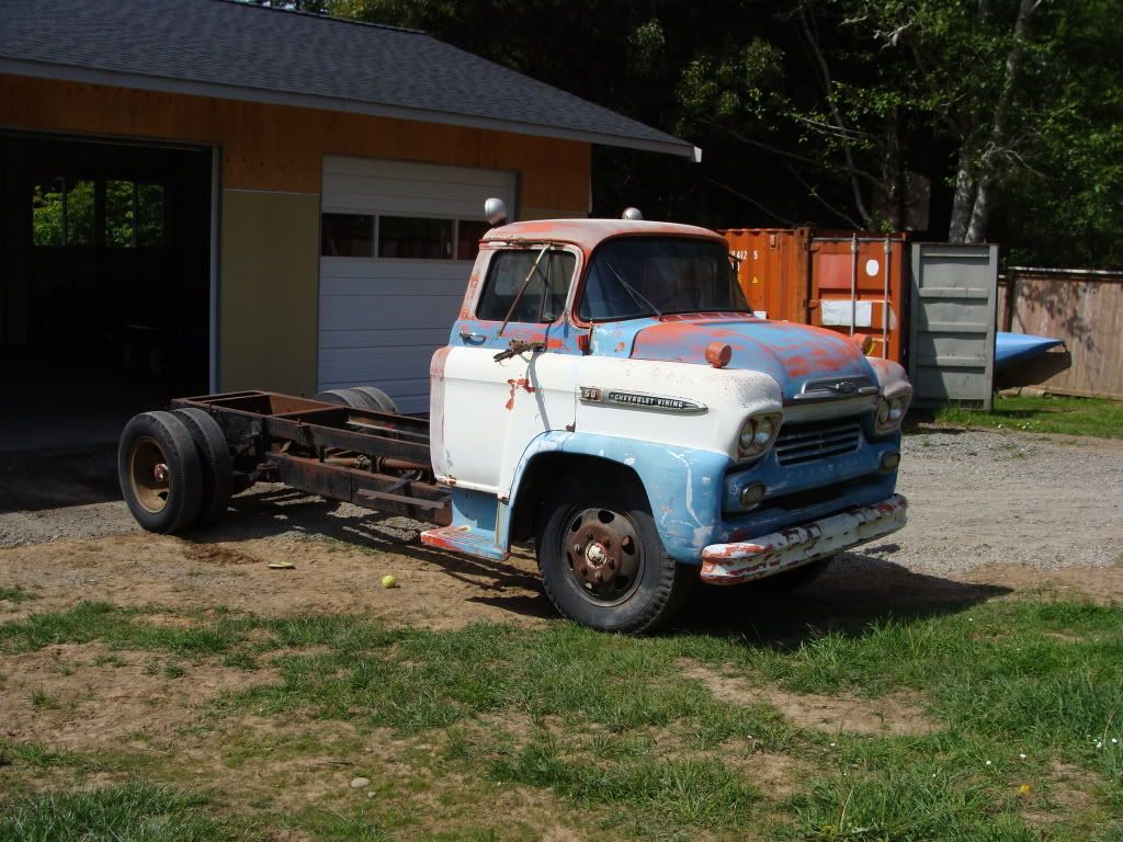

I don't know if you noticed but the 2-ton 55-57 LCF is narrower over the front fenders (80") than the 2 1/2 ton (84"), so the front fenders are different. On the 58-59 they use the same fenders on both the 2-ton and 2 1/2-ton 86", since the front axle of a 2-ton is narrower than a 2 1/2-ton it makes the front wheels of the 2-ton sit further in and it looks to be frank a little bit funny. You can take a look at my LCF and you can see how far in the front wheels sits http://i185.photobucket.com/albums/x150/CrustyNut/1959%20Chevy%20Viking/DSC07129.jpg. Here is how it looks on a 2 1/2ton http://www.hankstruckpictures.com/pix/trucks/pnwtm/2004/dsc_7621.jpg.
Hence if you intend to use a 58/59 then use a donor that has a threading width of around 70-72" (the 2-ton is only, 64"). The duel mean thread is the same for both of them 69".
The frame rails sits 34" apart and I think it would be a lot easier to use a frame that is about the same.
