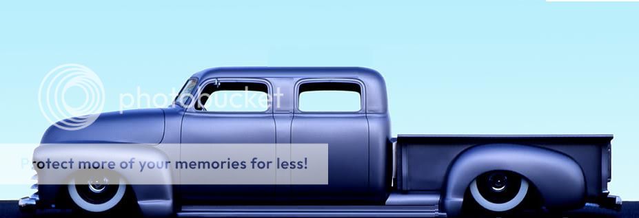

hello everyone.
just wondering if anyone thinks this is in anyway possible to put together. I know that it would require extensive frame and sheet metal work, but was just wondering whether anyone knows if it could/has been done.
[IMG]http://i834.photobucket.com/albums/zz265/pcmodder530/customquadcab53.jpg[/IMG]
Thx for your input smile

Yup been done. Here's Pics of one from around Kansas City.

thanks thats perfect smile
quick question. thats a 1 ton and I was wondering whether it would be harder to do a 1/2 ton because of the different frame rails?

I like the idea,the main trick is getting the rear doors,and proportions to look right.
I've seen ones done just using another pair of doors with the forward slant left as is(wierd), but the one Mongo posted must've used door tops from yet another pair to achieve the squared off look.
Either way,it's a lot of work!
More pix on Flickr.

I've seen it done as well.One in particular had the rear doors suicided..I love the drawing ,that would be a hit in my book.......dave

alright thanks guys smile im going to go take a look at the old truck my neighbor has and see if i can possibly salvage anything off of it.
I know its gonna be a lot of work to make it look right but i think it will be worth it in the end.

Just a suggestion, what if you used the front sheet metal from a "Big Bolt"? The front wheels/tires would fit the 1 ton chassis better and if necessary "radius" the rear fenders? I like the idea and have the components, but would consider the 83 1/2 ton frame I have. I'm trying to figure out how to hang the rear doors in the conventional way. The center pillar would have to allow for hinge pockets, and maybe modify the doors too make it look right.

Seems like I saw one at the Sacramento Autorama a couple of years ago....I don't recall any other details. I may also have a pic of it somewhere...

Any other info on a project like this? I have a 5-window I want to do something unique with.

use a 3/4 ton frame the rails are straight after the cab and easier the lengthen or shorten then a 1/2
