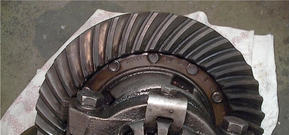

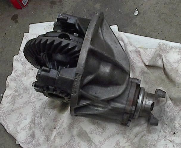

Picked it up recently from CA..got it on the 67-72 board..1968...looks like it is in good shape, bearings look good and gears are in great shape. Guy who shipped it built a nice wood box for it.
I found a guy in PA who has two H0-52 4:10's out behind his garage. He was looking to sell them pretty reasonably but he is slow on the email.

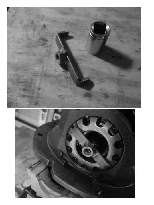

I'm going to fab up a tool like I found on one of the chevy boards to set up the carrier bearings, looks simple but effective - bend some bar stock and weld on a nut.
