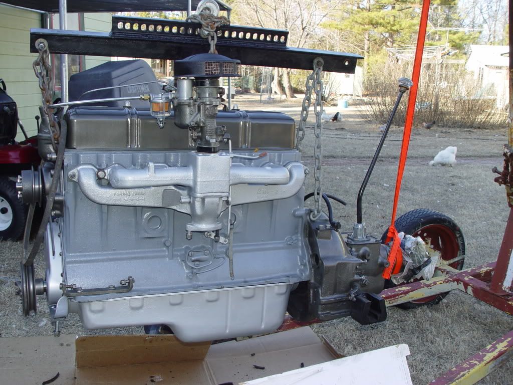

Okay I am stuck. When I got my truck the oil pressure gauge was never hooked up. I have searched the web over the past few days trying to see where I pick up my oil pressure connection on the engine to the gauge. Not finding a lot of anything. The motor is actually a 42, 216.

Behind the spring that's hanging down off the throttle linkage in your picture, there's a plugged port. The oil pressure gauge attaches there. If you choose to install an oil filter, the supply line to the filter attaches at the same spot, by using a T fitting. To the lower left of the sheet metal oil distributor plate, there's another fitting for the oil filter return line.
